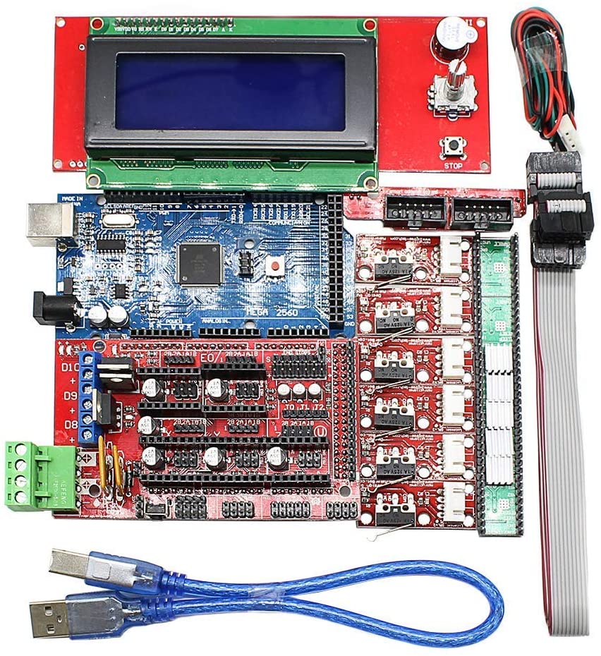

In case i need to change the board, what do you think about this one?
This would work with a probe and also an end effector and all the jazz correct?
There also this one but it will be less powerful i guess, I dont mind spending the extra money to get a mega
EDIT 1:
Or I could go for this and a more “reputable” mega board like from elegoo

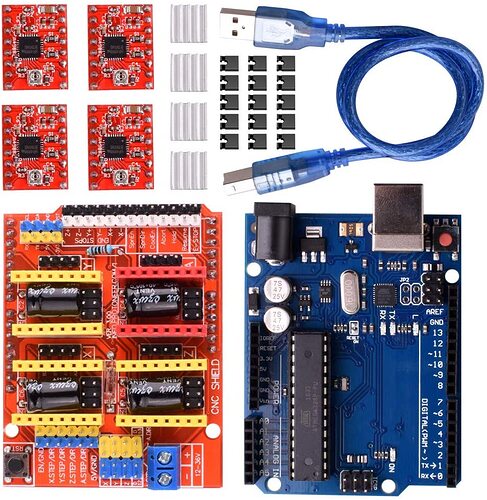

This one can also run Marlin. Doubt it would be able to cope with your printer LCD and other stuff…but it would run plugged to the PC via USB. So you would kind of have an extra spare board. This is and 8-bit microcontroller @16Mhz (or 20Mhz not sure now). It does not compare to yours.
This would be able to run it but it would be in the absolute limit of it’s capabilities, and by switching a few configurations on µCNC to make it fit…The processing power is about the same has the other but the available RAM and FLASH is veryyyy limited.
And maybe this Arduino Zero clone would pair better. The only thing you would have to make sure is that the shield is 3.3V ready or the 12V~24V rail for the stepper drivers does not feed any voltage regulator and is completely isolated.

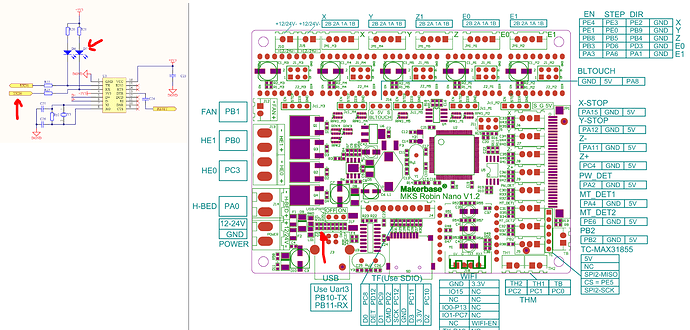

Uploaded a new bin called Robin_nano_blink.bin.
This only initializes the MCU and blinks TX led every second. I’ve tested on bluepill and it’s running.
Here is your board schematic indicating the led that will blink.
I’ve also uploaded an alternative bin were the TX communications are done in a synchronous way. You can try that too although I’ll doubt it will do much difference.
EDIT: If the blink file doesn’t work then forget about it. Maybe there is something more that the bootloader expects before running the firmware (like a configuration file or something of the sort) and does not boot up because of that. This may be a wild idea but you can try and repeat the process with an empty Robin_nano_cfg.txt file to see if it works.

Ran the blink bin, tft uploading etc etc but no blinking, even when I try to connect with the pc.
Although I noticed where the arrow in the board schematic is pointed does not represent a LED on my board! ill upload a pic soon but its definetly not an led, its a resistor id say.
Also right aboce the arrow, USB PWR is on the off position, not sure if it would make a difference just a note.
Couldnt find the synchronous bin file though.
