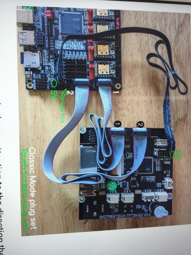

Marlin mode
After a long search I finally got the 2 gray cables and plugged them in.
switching to Marlin mode works great.

Yes, you can select your language in the firmware and recompile and flash the SKR Pro, to change the touch side you need to reflash the config.ini file.
Does the language only change in Marlin mode because in Touch mode it is in German!
I’ve read somewhere that I have to unplug the 2 gray cables when overwriting?

Two separate firmware. Marlin mode comes from the control board, tft mode comes from the screen.
You should not need to disconnect anything.

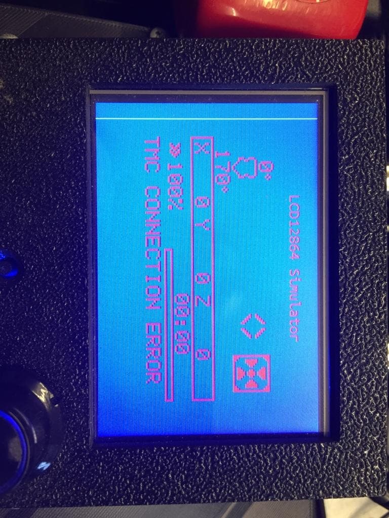

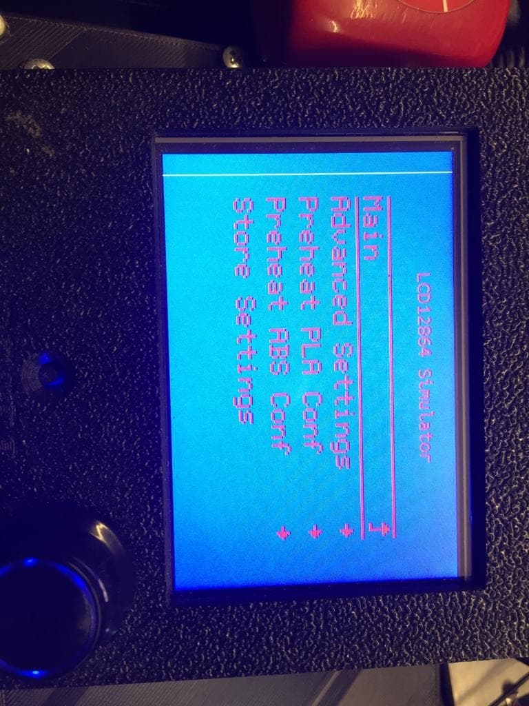

I need help again in Marlin mode, I’ve looked through everything but haven’t changed anything yet! Unfortunately I don’t know where to start, can someone help me what I should change where and how!
does it work without endstops I didn’t mount any on my mpcnc.
how do I set the zero point? or do I have to do it in touch mode?
Where do I have to plug in the usb stick with the gcodes at the top of the screen or at the bottom of the board???
Your machine will work fine without endstops, but you need to avoid homing the machine.
The first menu item in the V1 custom menu will zero x, y, and z. You can also have g-code inserted automatically in EstlCAM that zeros the machine. You want to insert G92 X0 Y0 Z0. And you would put it in Setup/CNC Programs/Texts/Program Start.
The screen.
