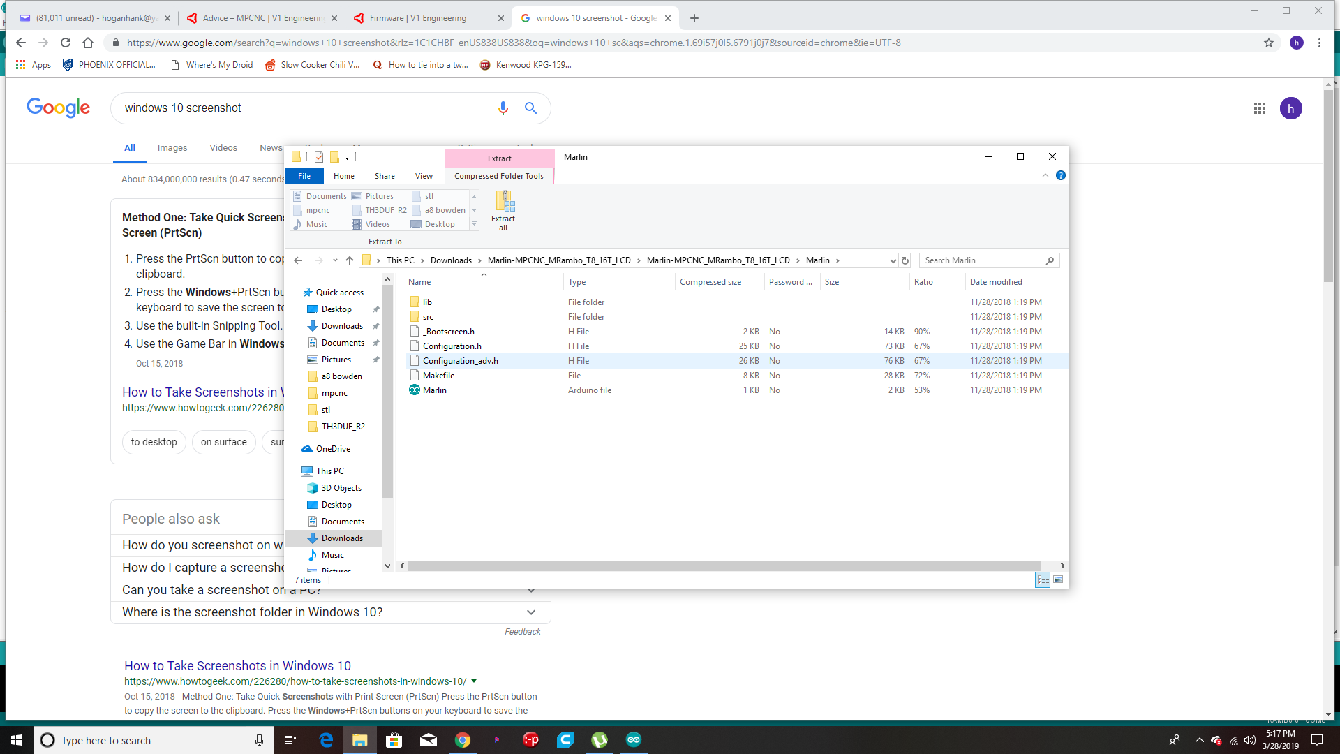

before asking i have tried over & over to find the .ino file in the download, i have followed the directions step by step & when attempt to “Open the firmware folder and select the current Marlin.ino file” there is no .ino file in there just whats in the images bellow.
if i open the arduino file its empty.

[attachment file=“Annotation 2019-03-28 205950.png”]

I did open that folder, that’s the 2nd image i posted. there is an Arduino file in there but its not an .ino file & when i open it there is nothing in it ,no configuration.h ,nothing.
Try opening the Arduino IDE first, then from the file menu, choose File -> Open and then choose that arduino file from your second screenshot.
Edit: Wait, I think the problem is that it’s in a zip file. You have to extract everything into a regular folder first, then open the Arduino file.

The ino file is right there. But the real problem you are having is that you are looking inside of a zip file. You can tell by the path in the address bar and the fact that your image called screenshot 3 shows the compression ratios next to each file. Just extract/copy the files out of the zip file and it should work fine. (I hope). The ino file I think is the one in the picture that says it’s an ardunio file.
Microsoft doesn’t let you open many programs with files in a zip file. I am sure that arduino is opening the marlin.ino file and not finding any of the other code files because they are hidden in a zip file.
