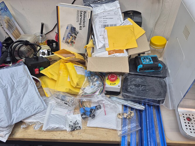

Hi all, I am amazed and full of appreciation for everyones messages and following me up. I have not uploaded any updates as I have had a huge couple of weeks with my first born graduating high school and the begining of the silly season with work as we near the years end. But I can confirm that there is much that will be happening in the coming weeks. I have ordered a fair bit of components for the new build.
So many envelopes and little bags to sort through.

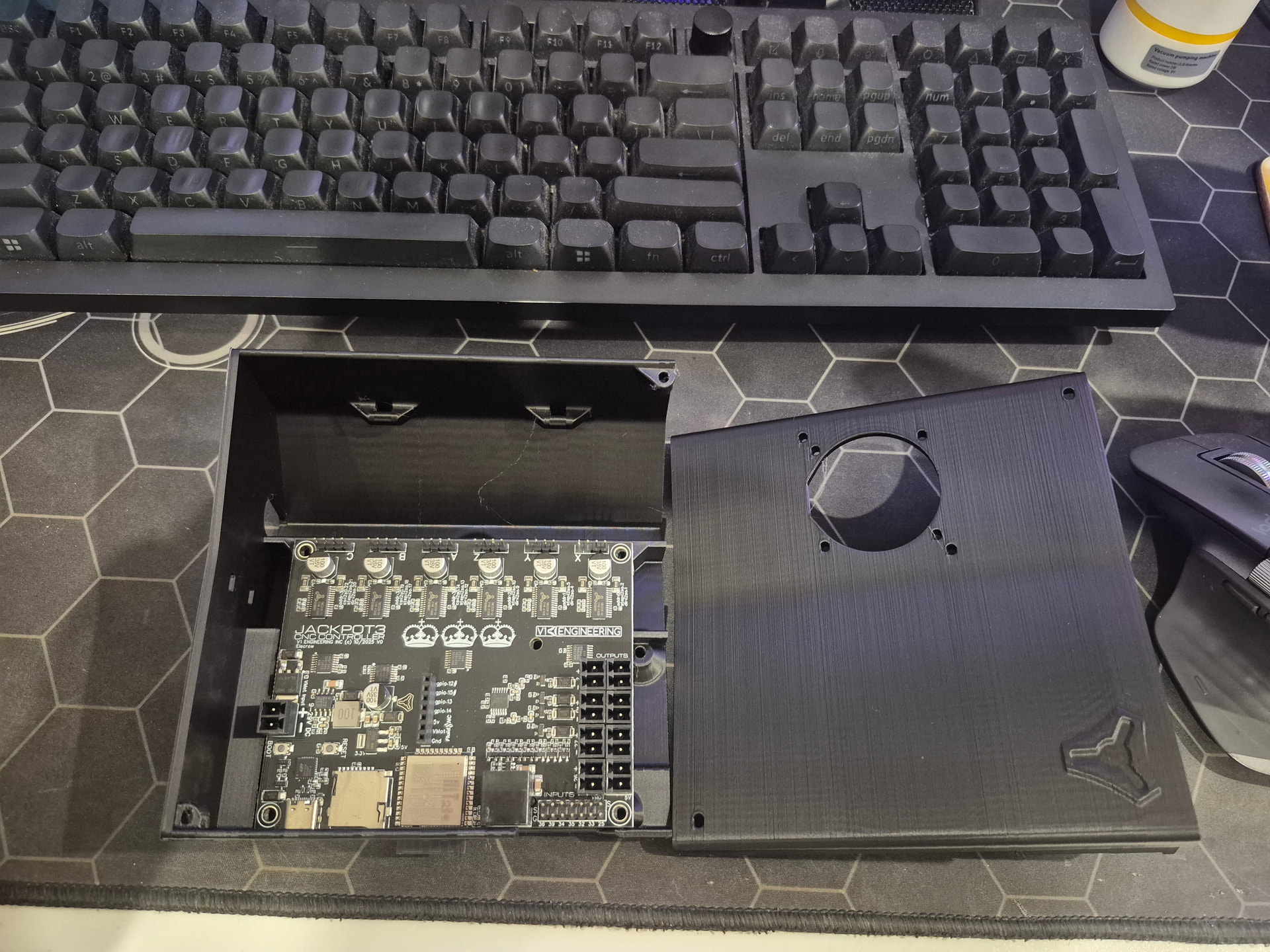

After a lot of time working on trying to get the BTT Octopus board to run grblHal and all the differences that will no doubt be a steep learning curve, ai decided to park that idea. 2 weeks ago I purchased the Jackpot 3 board and it came today. I have printed the standard case for it and look pretty neat. The colour scheme will be introduced to the final housing once I have worked out the wiring harness and all that jazz.
Tomorrow I will work out where I can have the case mounted and also hopefully finish installing the spoil board MDF pieces
You could always run klipper on the octopus… But youd need another board or pc with it.
Yea, that was my original plan [check my first post] I have had multiple 3D printers work that way. I have so many Pi’s and stm32 boards that it why I was trying to sort out the grblHAL.
But it’s a lot a work trying to make something work when the hard yards have been put in by @vicious1 and the community and we have access to the amazing Jackpot board, my extremely valuable time can be spent making chips and not trying to make something work.
Once this sweet machine is working I might take another look at the alternatives
