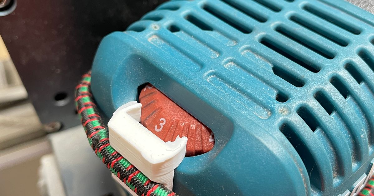

Running a flattening pass on my spoilboard and the speed setting on the Makita router won’t stay constant. Anyone else seen this? Is there a fix?
https://youtube.com/shorts/Qo8dAAd62x8?si=zs2aVGpM2AkVkQR_
I don’t have a Makita but a Google search makes it sound like this is a common issue.
I see fixes involving tape, tightening screws, clips for purchase.
Since I don’t have one, I won’t make a suggestion, just leave what I searched for:
https://www.google.com/search?q=makita+trim+router+dial+moves+during+use
Thanks, found this on Printables - can’t hurt to give it a try and see if it works…

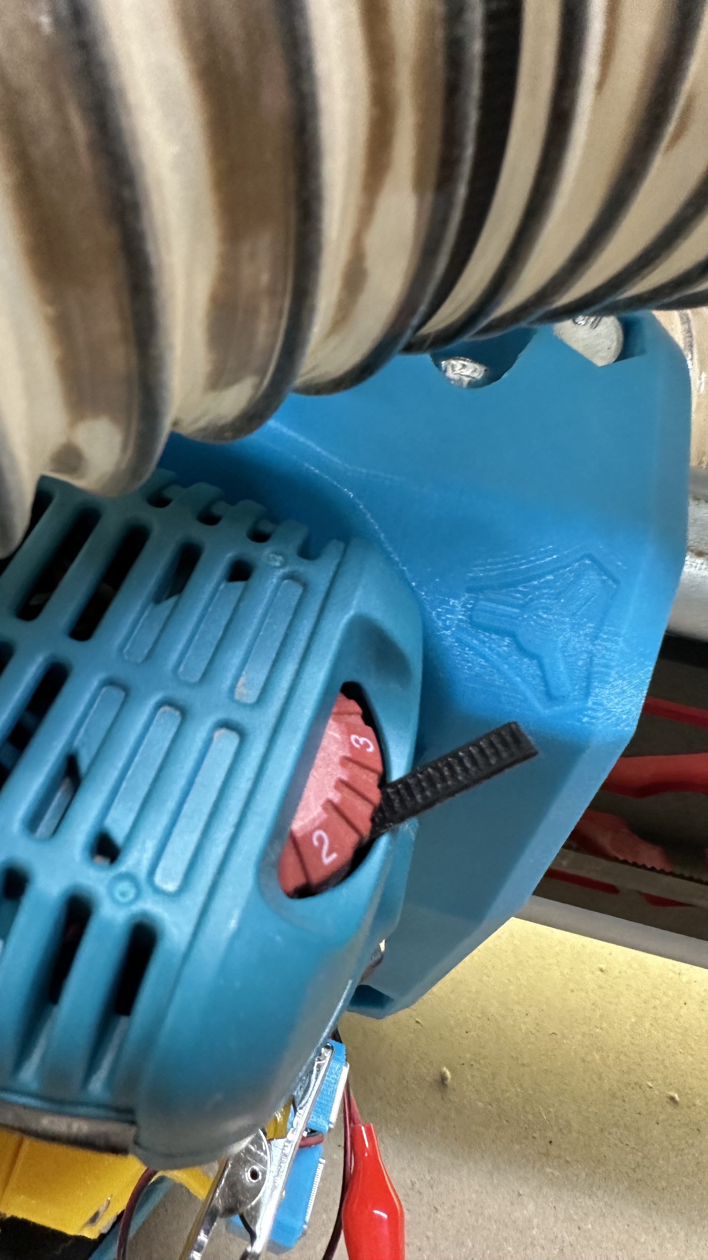

That’s fancy, I use a bit of electrical tape.
I ended up going low-tech for my solution. The 3D model I linked above was just too big and in the way. So I snipped the end of a zip tie…
