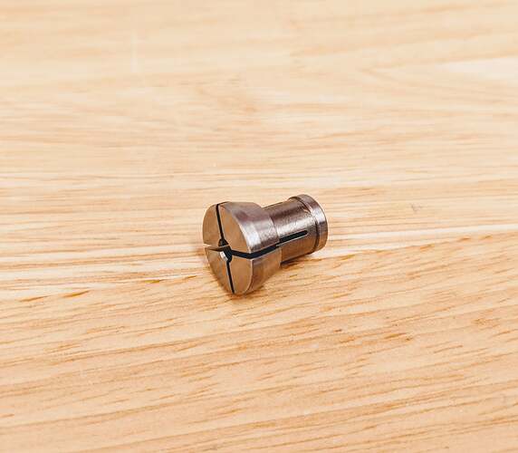

So I got a Makita RT0701C for a fair price of 70$CAD. While reading the forum, just realized that the Makita doesn’t have a 1/8 collet which seems to be use by a lot of bits. That being said, would you say I can start my journey with a 1/4 without any problem really? Like when will I get frustrated with the 1/4 bits?

Isnt this it?
Yes, my order is already shipped and didn’t add one… just wondering if I can do a lot with 1/4 or are they quite limited.

So, 1/4" bits are stronger and better except for detail work. They cannot form an inside corner with a radius any tighter than the bit’s diameter. 1/8" can do twice as tight an inside corner. Some projects it makes no difference. Some, noticeable difference!

I’ve been using 1/4" shank endmills for months now, many with 1/8" cutting size. The trick will be to buy the bits that will work with your collet.
Also, when I started with my Primo, I used the same Makita router, and got a 1/4 to 1/8" asapter that worked well. probably added some runout, but not much, and it worked until I got a proper 1/8" collet. (I still have the adapter, too.)
So it will work, you just need the bits to go in the router.

6 Packs 1/4" To 1/8" Collet Adapter for CNC Lathe Router Cutter Milling Bit Collet Reducer https://a.co/d/9Ocr77w
Pretty sure these are what I got used so I could.use the end mills I bought from V1
I’ve got both and use the 6mm fora lot of hardwood, 3.175 for plywood. I would definitely get the collet. Also, the smaller endmills are a lot cheaper.
