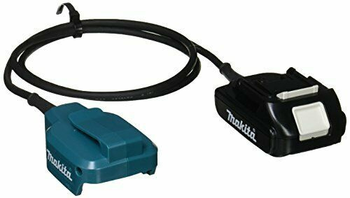

i already own a Makita DRT50Z (or whatever the battery powered version of the RT0700C is called) and want to use it on my MPCNC. Anyone knows a mount that fits the Router and Battery?
Or even better…
Anyone has ever seen a diy Battery extension cable to get the Battery weight off the Z-Axis?
Or the optimal solution…
Anyone has ever seen an AC Power supply mod to drive the 18V Makita Tools?
Thx in advance!

This is an interesting solution that makes the router lighter. A battery extender.
Something like this might give a solution. But in the end, a spindle and speed control might be cheaper.
Exactly this. But Diy. For 5-10$ instead of 60. And smaller on the tool end.
