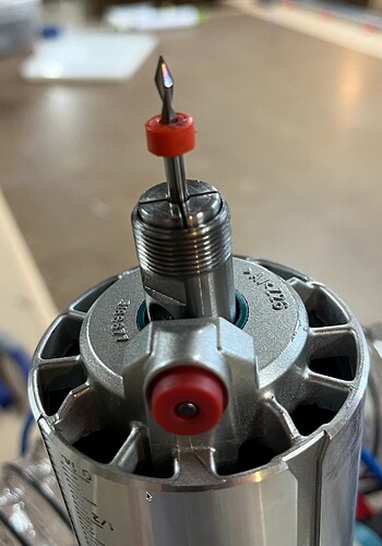

Anyone have trouble getting the 1/8 Makita collet to release the end mill?
I have to take the nut off, remove the router from the LR4 and use pliers to twist and pull to get it out. I have broken two mills already. If I do get the mill out, then the collet is stuck and takes a lot of work to free up.
Is there a trick I am missing?
I have never used the Makita so I am not sure, but on my other ones the collet “clips” into the collet nut, so that when you loosen the collet nut it pulls the collet out for you. I know I have messed up and not got it clipped in before and had the same issue you are having now.
Thanks… I ended up breaking the collet so I am switching to the Dewalt which does have captured collets like you describe. The Makita does not. I am thinking maybe the collet I had was not heat treated properly and had no “Spring” to it. It cracked when I tried to open it a bit to give a little more room for the end mill.

I’ve only had problems with routers after overtightening the collet. I had a Hitachi that once cranked, it wouldn’t release properly after that ever again. I would have to barely loosen the nut then tap it with a hammer to get it to release. I don’t know if there is a torque spec on these, but you want it tight so it won’t slip the bit out, but not crazy tight that it deforms the end of the shaft. if you can’t undo it with the button and a wrench, it is on too tight.

Did this happen with the stock collet? If so there’s a problem with the router.
If not, check the dimensions and pitch of the collet against the stock one - it might be a manufacturing error, or an accidental substitute in the batch.
I have had mills.stuck in that collet, but usually the collet comes put with the mill. Sometimes a little tap with the wrench frees it up.
If not, pulling the whole assembly out I have a piece that lets me tap the mill out of the collet.
On my full sized router, bits get stuck all the time. I do these things, which I think help:
  1. Don’t insert the bit all the way down. Leaving 1mm or so at the end will give it room when you cinch down the collet nut so it won’t bottom out.
  2. Just like Dan, I give it a tap (more like hitting a tuning fork than hammering a nail) on the side to break the surface tension.

I end up with bits stuck in the collet all the time. As above I’ll typically give them a sharp tap on the shank of the tool right where it sticks out of the collet or on the body of the collet holder. In the worst examples I’ve had to spray some WD40 or similar into the collect and then leave it for a bit. Once it’s out, I make sure to give it a clean with some solvent. If it keeps happening, giving the collet and collet holder a once over with some fine steel wool may help.
