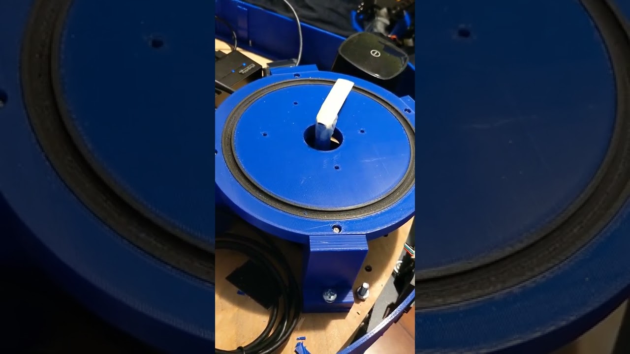

I built a rudimentary model of Floyd’s robot arm (haven’t finished modelling the gripper) for display in RVIZ (ROS’s visualization tool). I have a program that publishes pre-programmed JointTrajectory messages that instruct the motor controller how to move the motors and servos (position, velocity, acceleration). While the controller is moving the motors/servos, it is also publishing JointState messages (based upon the feedback from the motor encoders) that indicates the angles of each of the arms joints. RVIZ subscribes to these messages and automatically updates the positions of the joints based upon these messages. This way the model tracks the position the the arm in real time. This is the first step to using a motion planner like Moveit to actually control the position of the arm rather rather than rolling my own motion controller.
