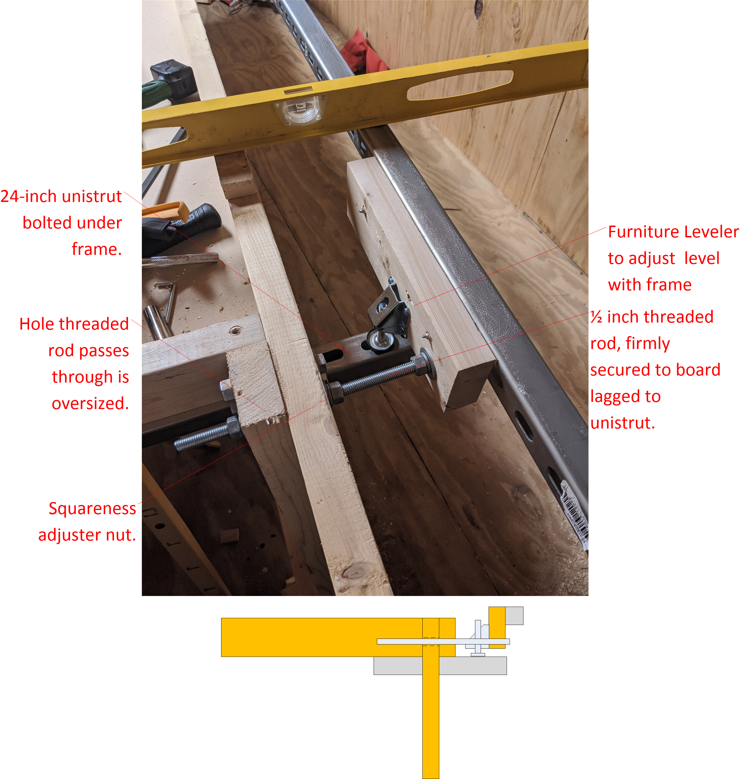

Here’s a picture of my ‘infinitely adjustable rails’ that I’m trying out. The concept was to make the coupling between the rails and the frame adjustable. I need to do this because most of my wood is a bit crooked and my experience has been that wood has a life of its own in my neck of the woods (North Florida). The leveling part seems to work well, but I only have one rail down so I don’t know if the squaring works yet.
The furniture leveler allows each end to be raised and lowered so that you can level the rails.
The horizontal threaded rod is secured tightly to the board that the unistrut rail is lagged into. The hole through the frame edge and leg is 3/4-inch wide while the threaded rod is 1/2-inch wide. That allows the rod to raise and lower as the furniture leveler raises and lowers the rail. I tried to get the hole in the right place so I didn’t have to drill a real big one and have to use very large washers.
Once leveled, the rod is moved left/right to allow for the rails to be squared and once everything is aligned, the nuts can be tightened to hold everything firmly in place. I’m worried that the process of tightening down the nuts will push the rails out of square so I might have to experiment with that. I think if use the nut I marked as the ‘squareness adjuster nut’ to set it, I can then tighten down the leftmost nut to lock it in place without affecting squareness.
Once I get the rails installed and the lower rider constructed, I plan to level the frame boards (shave it down by 1/8-inch) and top it with 1/2-inch mdf and 1/2-inch foam (as spoilboard). The little block of wood the leveler is resting on (maybe a bit hard to see in picture) is 7/8-inch tall so rails should end up even with the spoilboard… if I did my math correctly.
The rails are nice! I would say don’t surface the table yet. Get a few cuts under the belt, make sure you work out any kinks in your CAM first. These can cause some nasty spots on your table.
I was planning on running a bunch of gcode around the whole frame to get it help get it square and level and resolve any setup issues (binding, etc.) as well to learn the process of zeroing, etc. This setup is different than the maslow, so I’m be relearning how to do it. Then to surface the table frame, I’m going to run the gcode without router bit to make sure things work properly and then do a very light pass first so by the time I’ve stepped down to the full 1/8 inch, I’m in good shape.

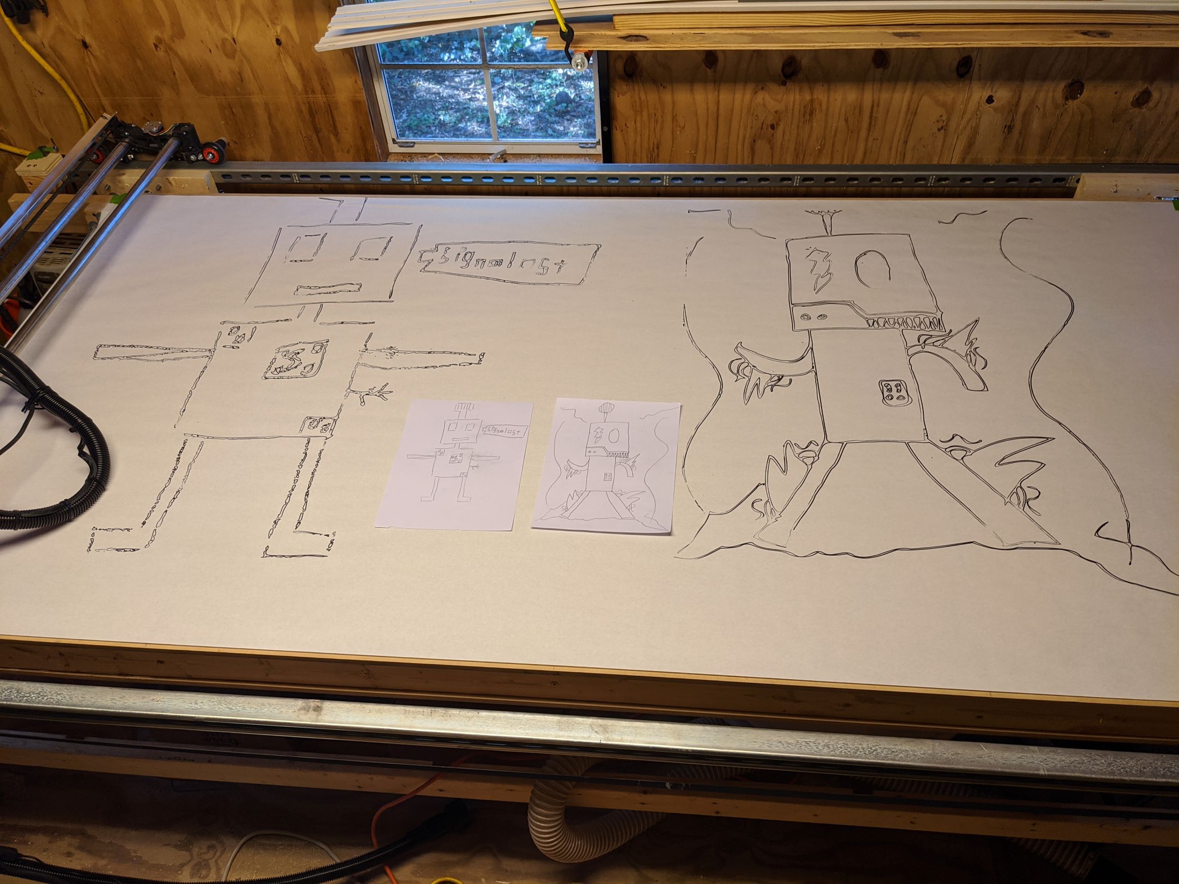

Yesterday I managed to flatten out the 2x4 frame. took 5 hours … 10 mm wide passes, 2 mm per pass… some areas needed 6+ mm shaved off. I really needed a 3-inch long bit to reach the frame from the router, but I made do with a 2.5-inch bit. I was nervous about how little was seated into the collet, but it worked. After shaving, I installed a 1/2-inch mdf top (so table top is 1/2-inch mdf on bottom, shaved 2x4 frame with three internal cross members, topped with 1/2-inch mdf). I’m amazed how overall flat it is. A straightedge shows less than a mm drop in the middle which is impressive for my carpentry skills (or lack thereof).
I attached a pen-mount and laid down some 48-inch wide craft paper and ran a rectangular test pattern across the board to get it all squared up by adjusting the position of hard end stops to eliminate the parallelogram effect.
With all that done, I decided to exercise the machine to see if there are any issues. I asked my twins to draw a couple or robots on some paper. I scanned them, converted them to vectors and simplified them and scaled them up using inkscape, and generated gcode using easel. I left most of the inkscape scan-to-vector artifacts in place and left the gcode unoptimized to really exercise the lowrider. This is the result after about an hour and a half:
