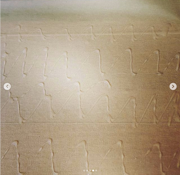

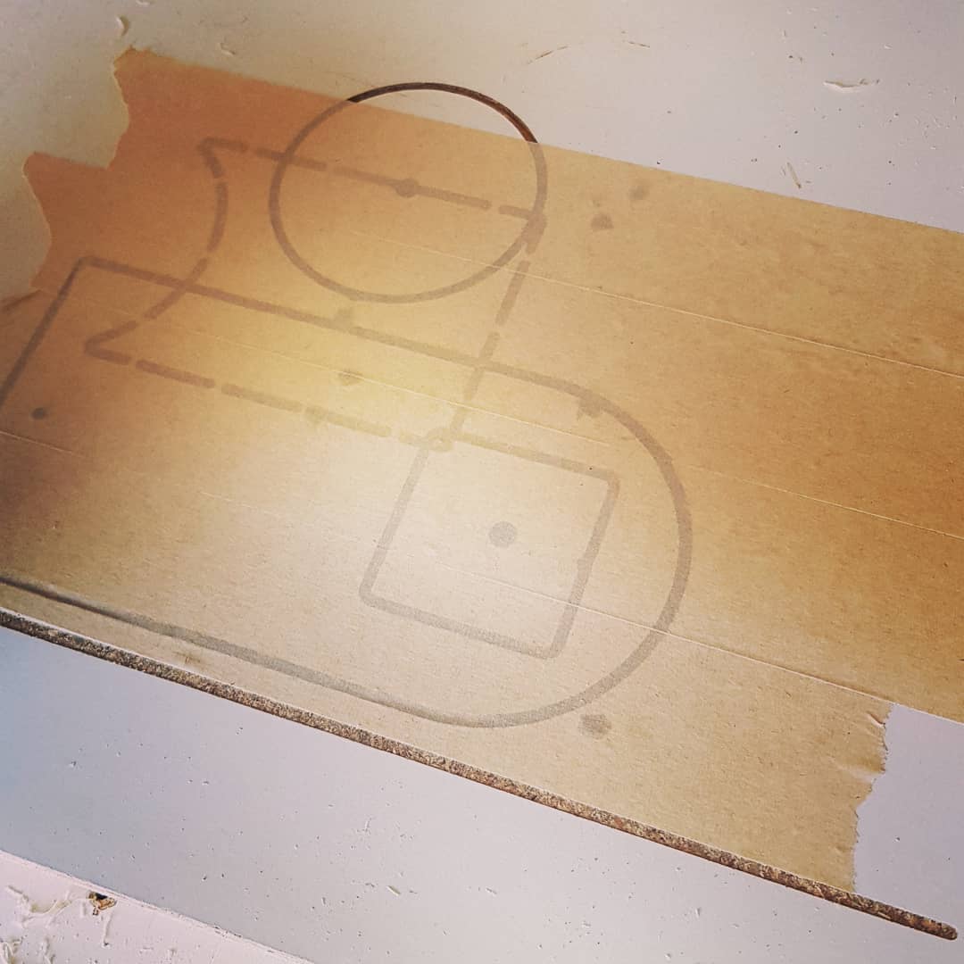

No. Put a layer of tape on the spoilboard, and a layer of tape on the plywood.
Spray the activator on one layer of tape (I usually spray onto the spoilboard layer)
Cover the other layer of tape with CA glue - you only need need to put some wavy lines on
Put the 2 surfaces together and wait 30 seconds.
Here’s some photo’s if it helps.
