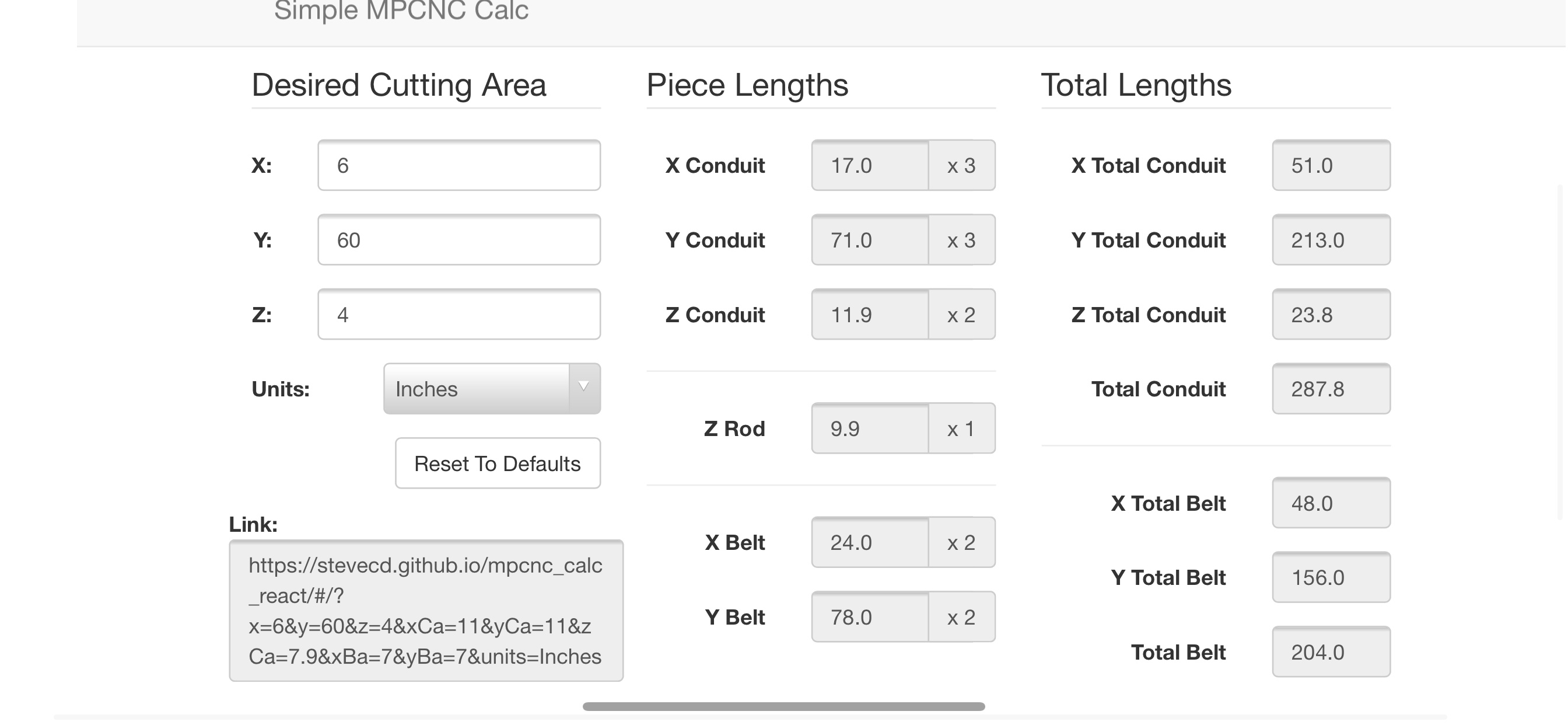

So I’ve decided to go down the road of building an MPCNC but having so issues with calculating the footprint. I will likely start with the recommended 12x12 to get a feel for the system and it’s capabilities before doing a rebuild to the machine I really want.

So getting to my actual questions. If I wanted to build a purpose built machine to cut and pocket tube what dimensions should I build around. What is the smallest that I can go and still have enough room for the head of the machine to move around And not feel limited? Would something like this be feasible? Am I going to hate it later? Again I plan to build the recommend size to get a hang of the capabilities first.
I’m assuming that the X should be the narrower dimension with a long Y and a really short Z. And add bracing along the Y axis pipes.
Also would the 660 be fine for this or should I look at a spindle where I can have more control over the RPMs?

I think you’d be very happy with about 12"x20"x2.5" cutting area and a dw660. I think it would be very forgiving for all the learning curves it will have to handle. You would just cut 1/3 of the 60" at a time (and then flip it to do another side). You can also build your own connector pieces out of larger plates. Maybe out of ACM.

Yeah. The original proposal was 6"x60"x4". I think that’s just about the same as 12"x60"x4", and 12"x20"x2.5" would be much stiffer.
