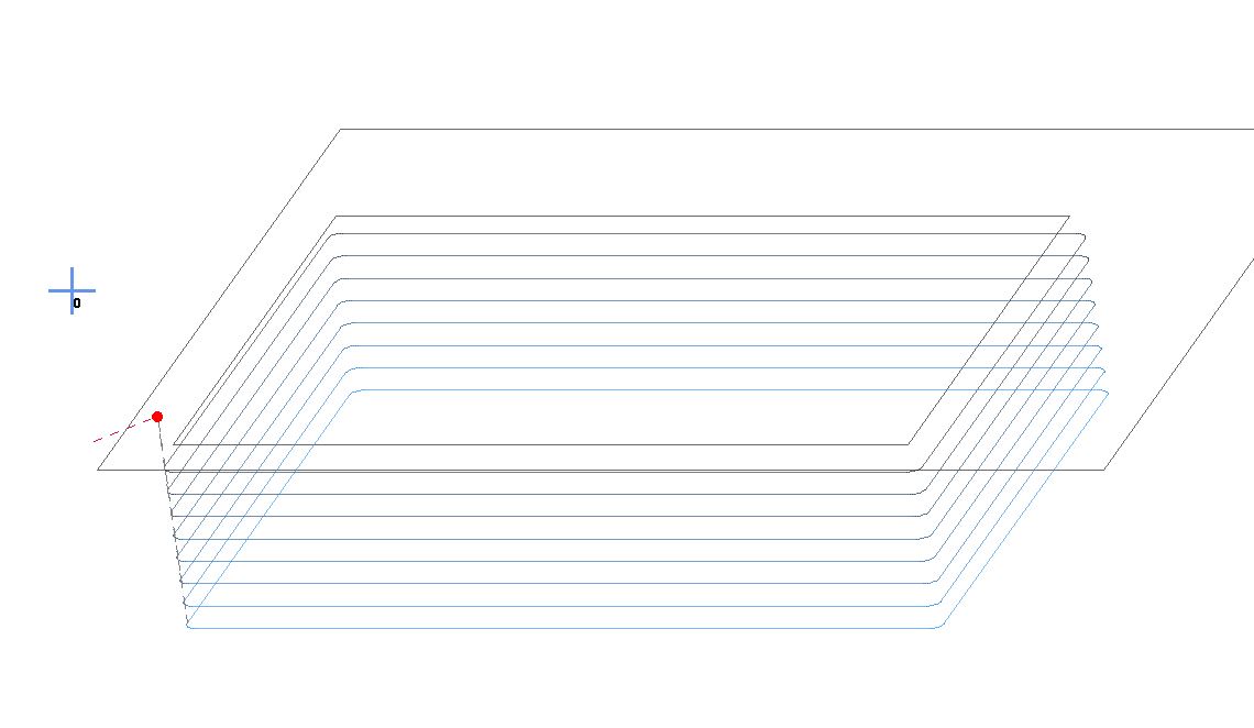

When I send a job using machine bed for the Z axis origin in Estlcam V11 it plows into the material and dives to the spoil board’s surface and begins the cut at and into the spoil board.
The workpiece top side probe works fine and as intended. Am I missing a setting or an update to get this to work right? Thanks

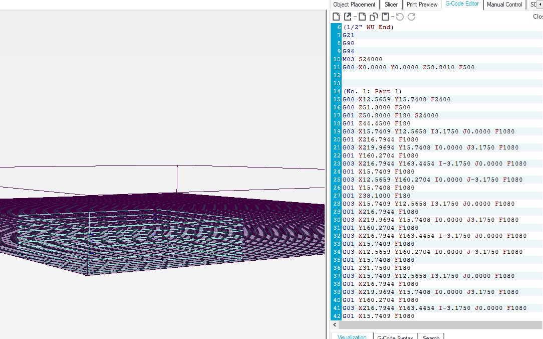

Sounds like “Working as Intended”, or “GIGO”, or “PEBCAK”, or whatever euphemism you want to choose. But that’s only because from the very minimal information you’ve given, it sounds like it’s doing exactly what you’re telling it to do. You’ve zeroed the work surface, and told it to start cutting. How is it supposed to know that you zeroed it to the spoil board, and not the top of your stock? We would need to see at least the start of your gcode (up until it actually gets into the cutting moves) to properly diagnose what’s going on.
If you’re going to zero to your spoil board, you need to make sure you let it know there’s an offset to the workpiece (your desired stock thickness).
If you’ll post the first couple dozen lines of g-code, I’m sure the gurus will be along to help out. I’m good at pointing out likely problem areas, not so good at providing actual solutions… :stuck_out_tongue:

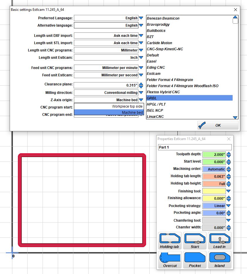

You can set the spoilboard as the Z=0 but Estlcam’s default behaviour is to treat Z=0 as.top to the material.
To use Z=0 as spoilboard, you have to set the “starting depth” for each cut, and make sure you set the travel height to be an actual safe height above your material
Here’s the gcode.
I just didn’t want to cut into the spoil board.

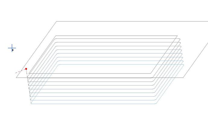

And here’s the path it takes.
If you want it to cut 2" down and stop at the spoilboard, set the “start depth” to -2"

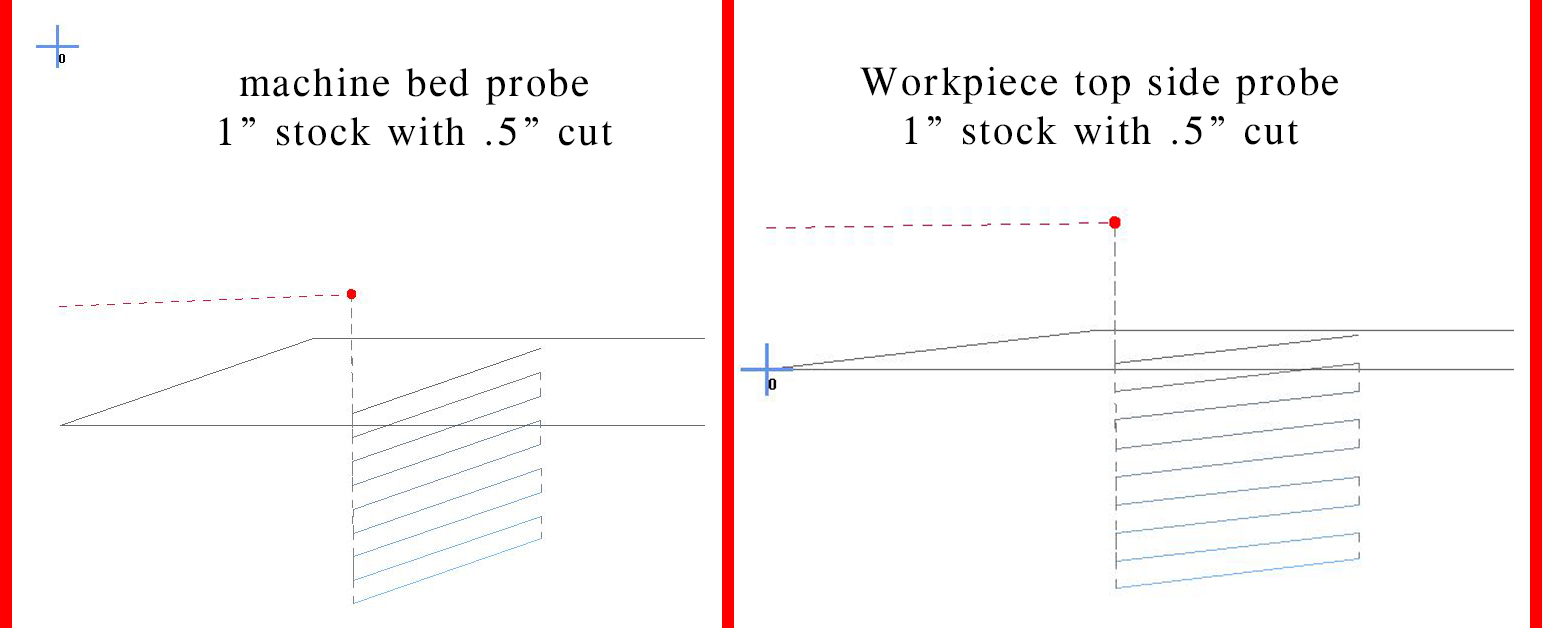

Estlcam v11 and v12 do not allow for any negative start depths… Is there a better program you could suggest?
Well, I set up my jobs for Z=0 at the top of my work, so I didn’t know that. I thought the 2.5D milling page had it set up this way, though I did my LCD case the same as I normally would.
The intermediate page (EstlCAM Intermediate (2.5d) - V1 Engineering Documentation) has information on setting up the bed as the origin and telling.Estlcam.where the top of the work surface is. This should work…
