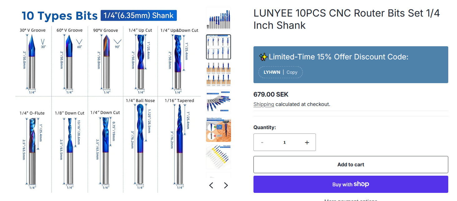

I’m looking at getting some mills to start me off. I obviously found the starters kit @ the V1 store, but shipping etc. is a bit off-putting.
Been looking at Amazon.se, AliExpress, mainly trying to find comparable bits (+bobs) to the Sharp Stuff kit. A friend suggested this kit from Lunyee. I’d love it if some friendly, knowledgeable, soul here could take a minute and give me an educated opinion on whether this is worth putting ~€60/$70 into.
Lunyee 10pcs-cnc-router-bits-set-1-4-inch-shank
I’m looking for ‘Getting my feet wet-tools’ basically. Trying stuff out. Mostly MDF, plywood, some hardwood. Will likely try Aluminium and Brass too. At least that’d be friggin awesome..

Welcome to V1 @TeknoViking. Most of those bits will work. Ideally you want 0-flute or single flute upcut bits for our use case. After you feel more comfortable you could try the 2 flute and downcut bits. The V bits, ball nose and tapered bits will all work just fine.
