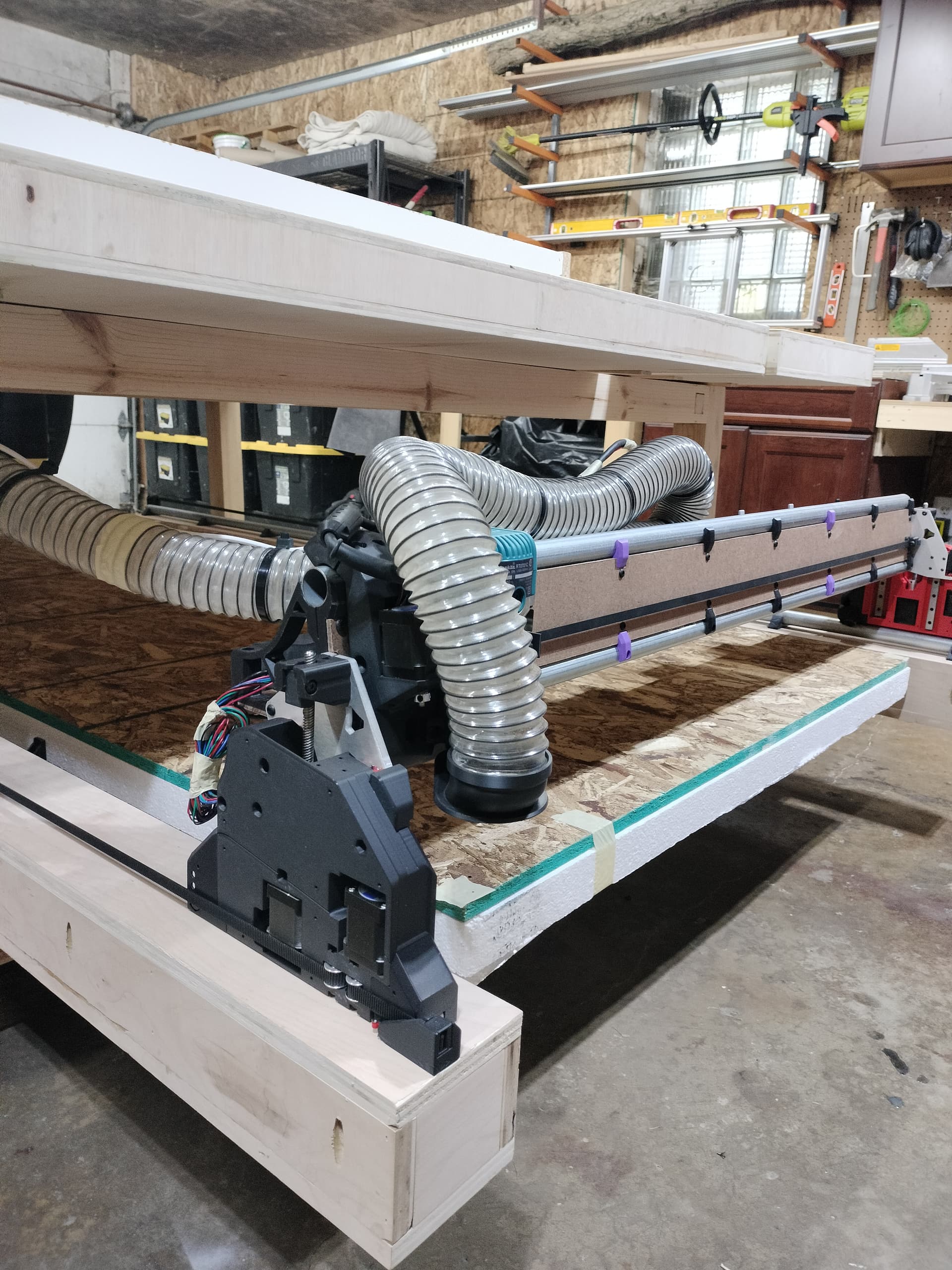

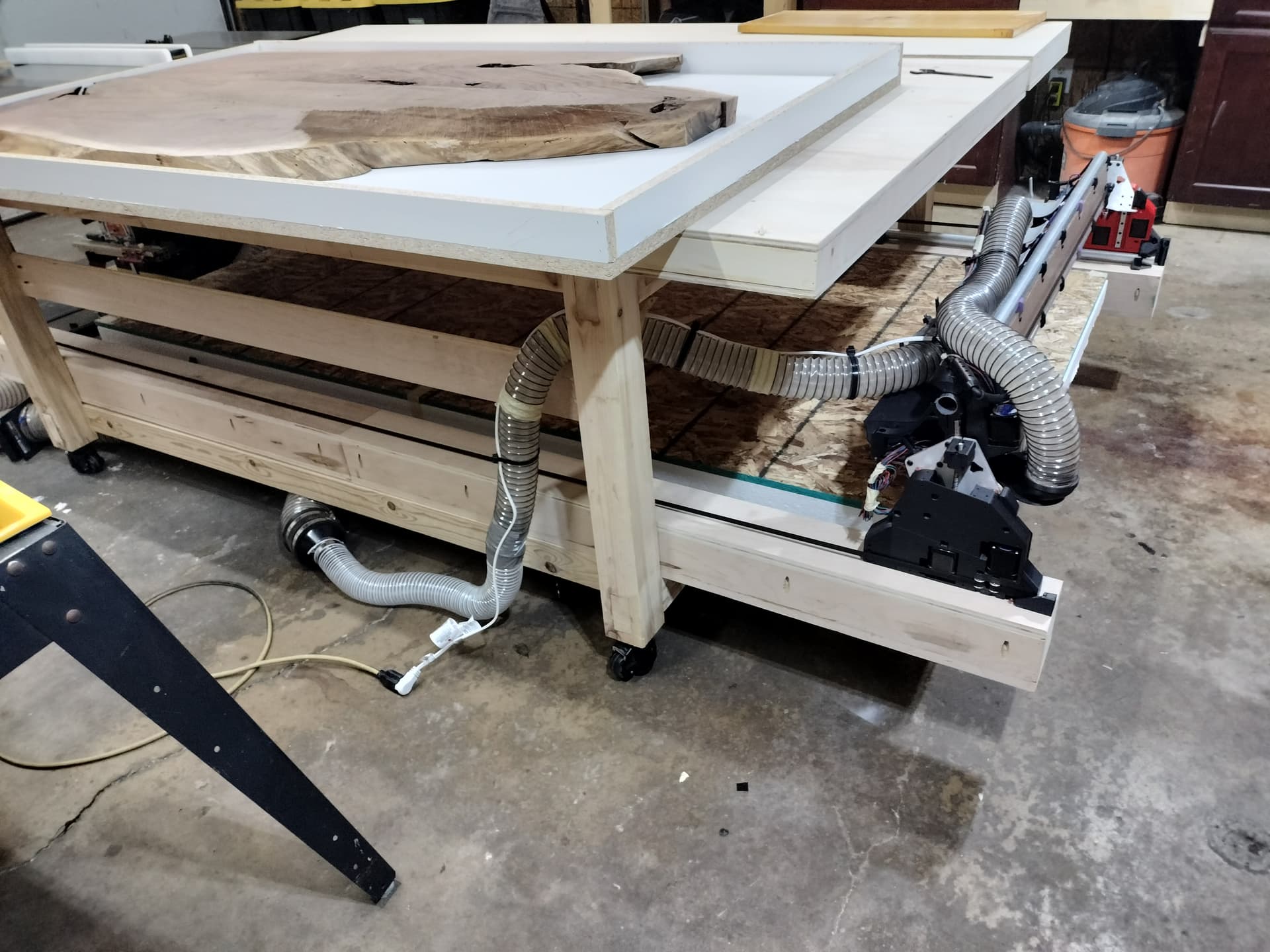

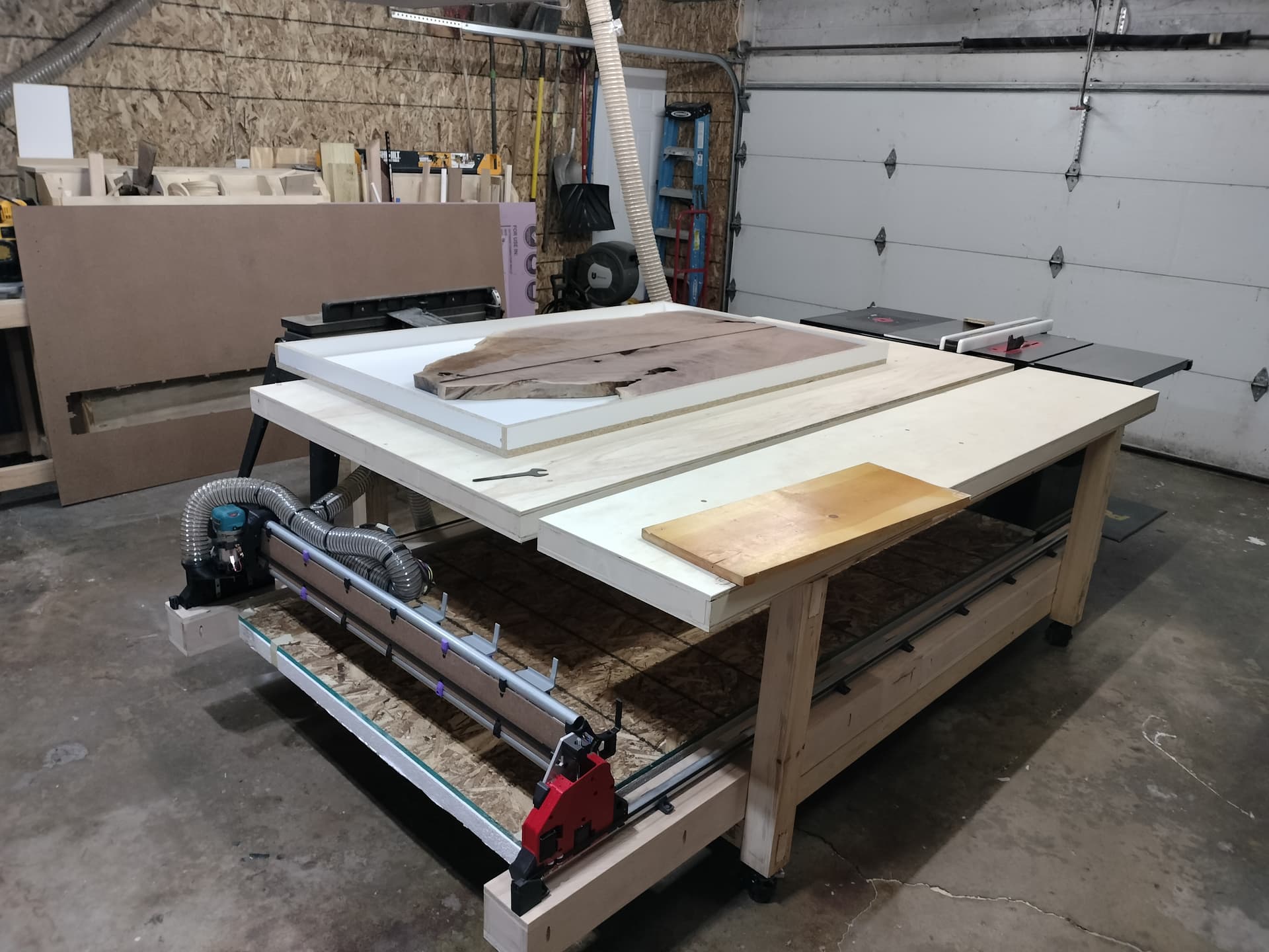

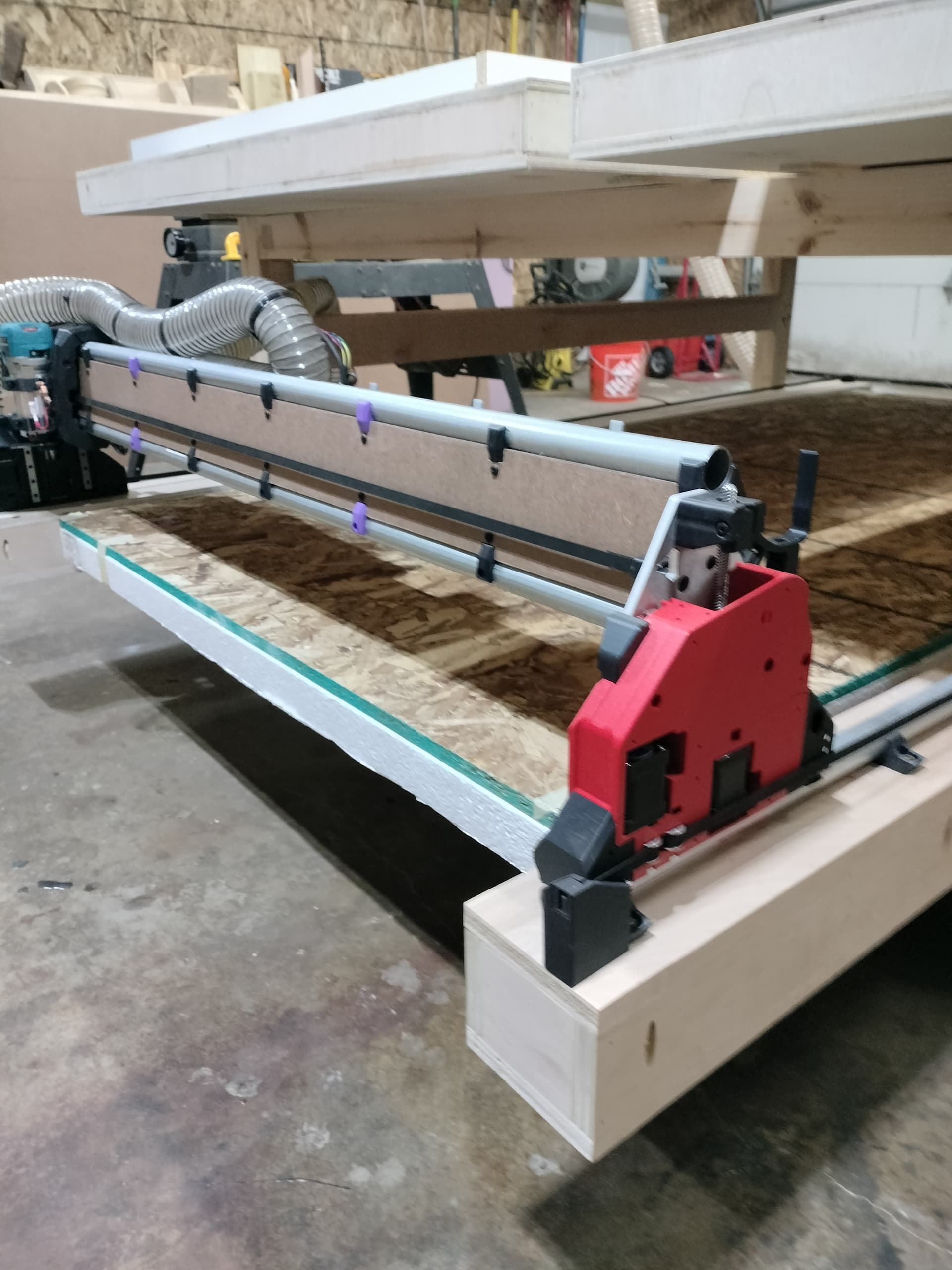

I have my x0y0 to x1200y0 z-leveling down to a .06 difference. My x0y2400 is a tiny bit off but my x1200y2400 is off by over 1.6mm.
I’m not sure what I should adjust? I read you can resurface but I’m not entirely sure how to go about that. Or if I can adjust another setting? Maybe the y pulloff for motor 1? Shim it a bit?
I’m still a beginner in the CNC world so just trying to make this the best I can so would like to know the best practice moving forward.
Thanks!
Well this could mean your table is a bit twisted. Can you add a picture? It might just mean you shim the table or top itself. I would try that before surfacing the whole table.
Some pictures there. I guess what I could do as well is raise that side leveler a tiny bit, or lower the other 3 since the top of the table needs to be flush or lower than my table saw
Yep, that’s what I would try. Note that floors are not perfectly flat, so if you level it and later move it, it might not be flat anymore. It also depends what you are doing for how much it matters. When doing carves, it’s important, but for through cuts, you overcut a bit so it doesn’t matter as much.
