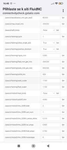

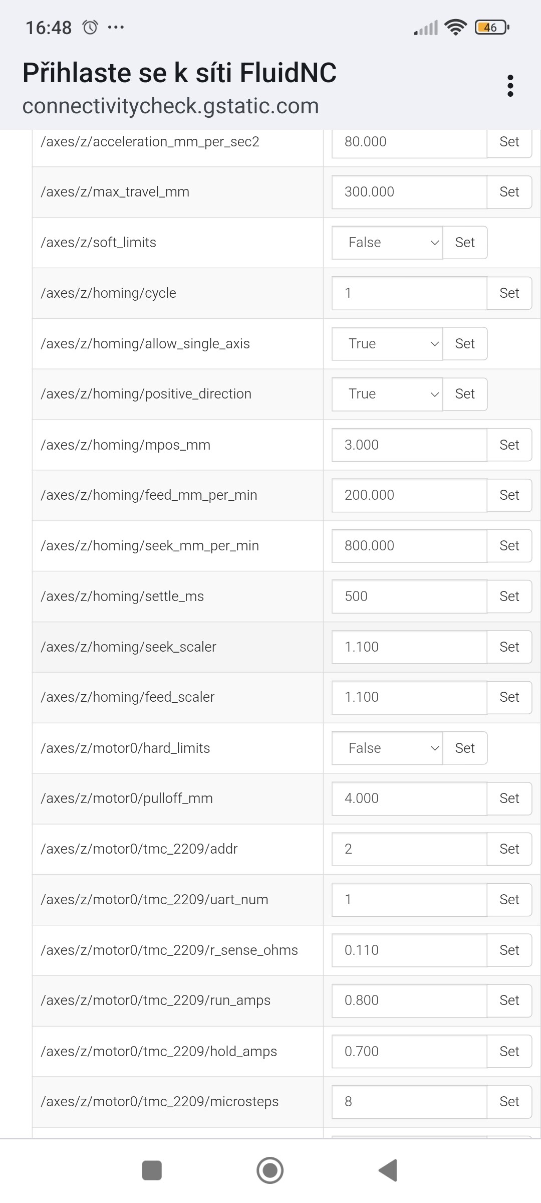

In your config does Z axis Homing show: positive_direction: true?
Well I flipped the cables and it is much worse I guess. Now when I try to home Z it goes up, but it is going by steps like 5mm or something like that. But when it hits the end stop it not stopping. And in fluidNC when I try to go up its going down…
Hello, yes it does. It default, I got board from here with config for LR4, adding picture from config related to Z homing
