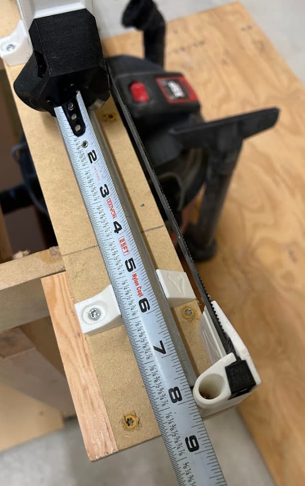

I am experiencing a new issue with my Lowrider V4. This is my second build and generally things have gone well. However, I started to notice weird misalignments in my cuts. Eventually when I was cutting an arc i noticed that my Y1 stepper just wasn’t moving and caused my piece to be ruined. When I tried to home it Y1 just didn’t move and shook as if it was stuck, but as soon as I have it a nudge it started moving.
Thinking this was a weird fluke I reseated my connections and gave the same cut another go after validating it wasn’t getting stuck and my belts were tensioned.

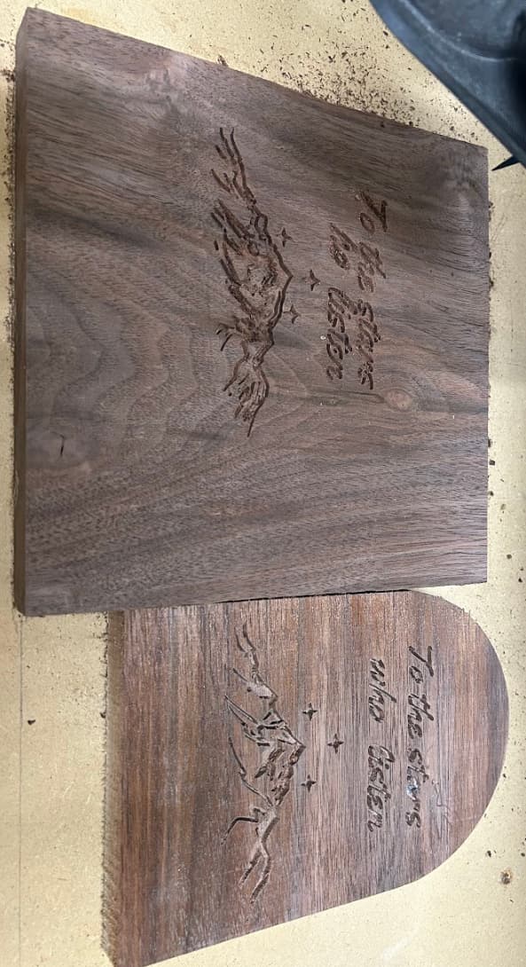

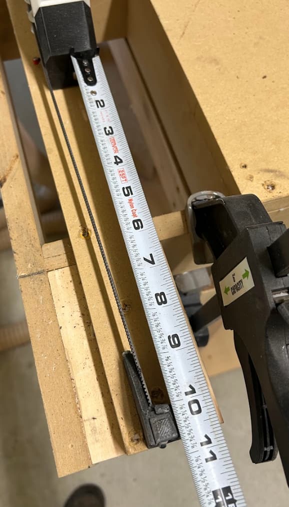

I started the same cut and the Y1 axis did move but it lost step and over the course of the cut strayed farther and farther from alignment. Once again I tried to home it and it just vibrated without moving. Here are some pictures. They show what the cut did compared to what it should have done. I also took measurements to show how misaligned they were. Once again I tried to home it and Y1 locked up without moving. After giving it a nudge it moved fine. Based on that it would seem the issue is with the stepper itself since it is getting signal from the board and it is attempting to move. However, the stepper doesn’t catch on anything when I move it out of power, and I can jog it back and forth the length of the table without issue when I tried. I am having a hard time determining what is going on. Any help is appreciated

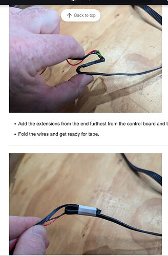

The classic location for this, especially if the problem is on the X axis, is the connection between the motor cable and the extension cable.
Even if the connection looks okay, you may find that the bending and stretching that occurs when the gantry travels along the X axis will put just enough strain on the connector that it causes the motor to stutter and skip in certain locations (ask me how I know…)
The best solution is to bend the cable in an “S” in a way so the connector is inside the S, then tape everything so that the strain on the cable doesn’t pull on the connector itself
Completely agree.
Your picture describes it much better than my words!
Ryan’s picture from the docs lol. And I figured “A picture is worth 1000 words” or something like that :rofl:
