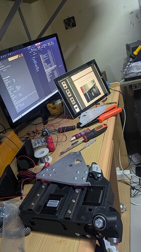

This is how it begins! Tomorrow will start the assembly finally

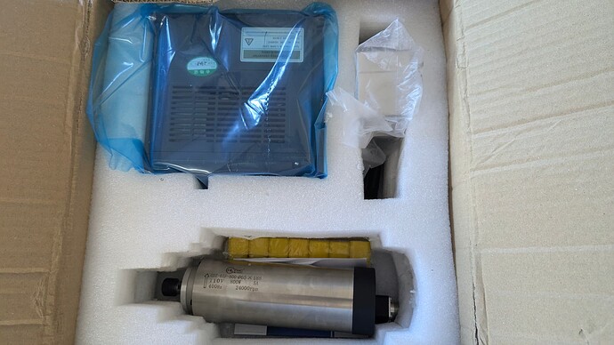

One core with a makita router (already have one, going to "upgrade ir later ")
The other one with an 800w spindle.
For controller/kiosk its Jackpots + raspberry pi with touchscreen and the other one with a ms surface pro3 tablet

Lets start building the second pair!
The ymin needs some repairs :woozy_face: dropped from the desk ( totally on my own) now to wait a couple of hours for the filament to dry before reprint
I see double now

But im alone into this: planning to get the amps a little up (these are goung to be working hard!) so a couple of 40mm server fans with custom pwm tune to keep the noise in check
