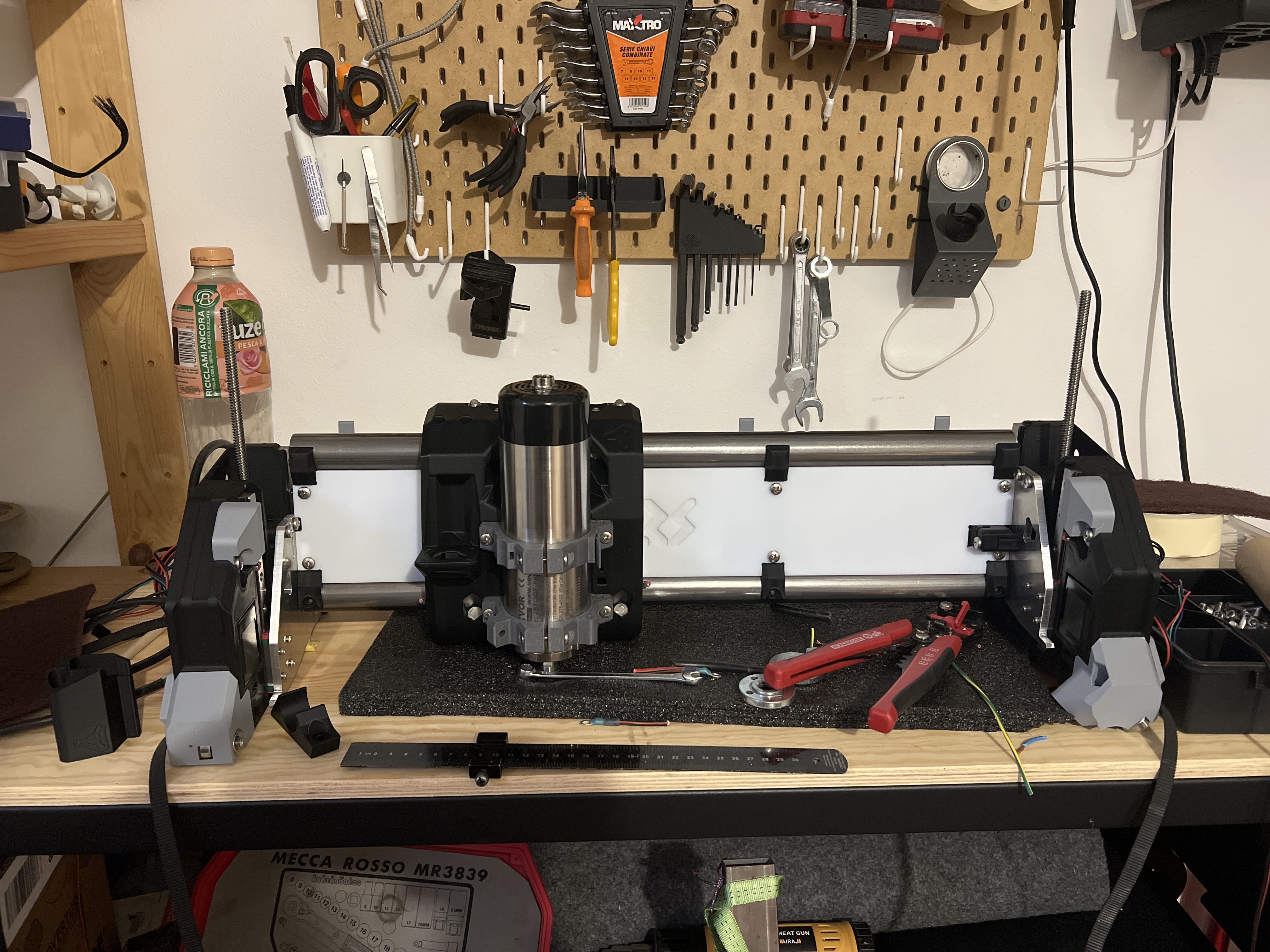

Well the original test was simply “does this make the beam stiffer?”
This last one is a good indicator that the machine is much better with strut plates than without, and that the aluminum ones are probably not MUCH better. That’s a pretty good data point.
I was thinking about angle measurements. I have a phone app that lets me use the phone as a level. It has a resolution of about 0.2° which might or might not catch a ~0.5mm deflection, making it debateable if that is twist or bend being measured. It may well be a combination of both, in fact probably is.
This all reminds me that I need to take another stab at making my aluminium XZ plates again, too.
So the goal of the plates are to have the flat, strong edge in line with the load. Meaning, the material should not matter as long as it does not buckle. Seems like we finally got there. The only other solid test now is lock the steppers and measure each part separately to see how the error is stacking up and where it is coming from.
If it is moving 0.5mm, is that 0.1from the mount, 0.1 from the core o.1 from the beam, and 0.1 from the xz connection, or 0.4 from the core alone.
I am stoked it is no different from metal to wood, I am just not really super happy with how much it is moving before the rest of the rest of the system gets brought in. I can’t wait to check a 4’beam versus a 2’ beam.

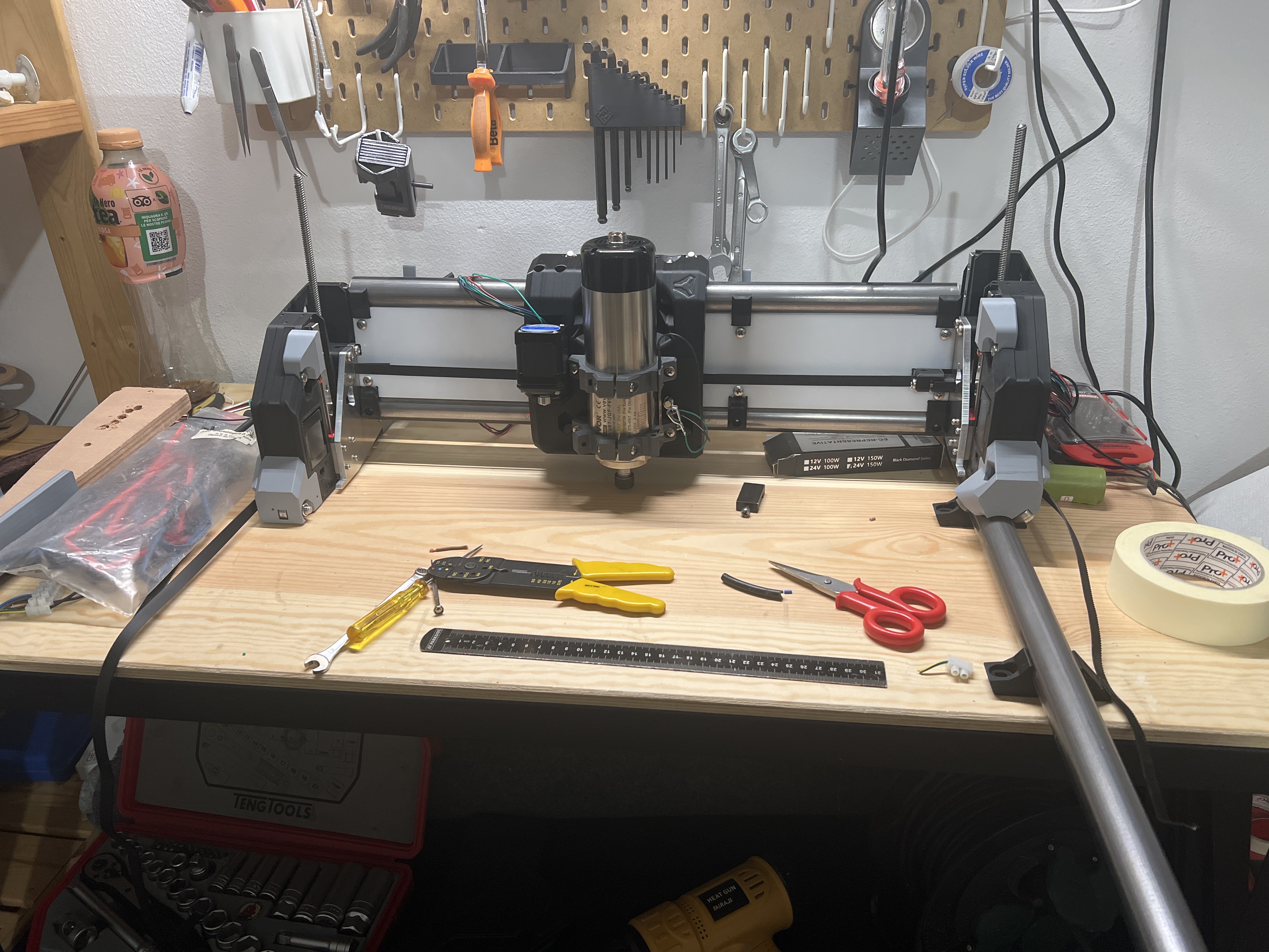

The good point is that all the printed parts, screws, tubes, bearings are the same, so we can have a reliable comparison
Anyway, the deformation test is close between metal and wood, but the twist of the gantry seems to be smaller, I have to perform that test too.
EDIT: if I rise the front wheel of the MIN side, after 5mm the MAX start rising too… huge!
The gantry seems and feel way stronger than before, maybe those 0.5mm are coming from other parts

I’m trying to look closer the YZ area, and seems that the twist is somewhere there. Two points seems to twist: the linear rails and the connection between YZ and Front wheel.

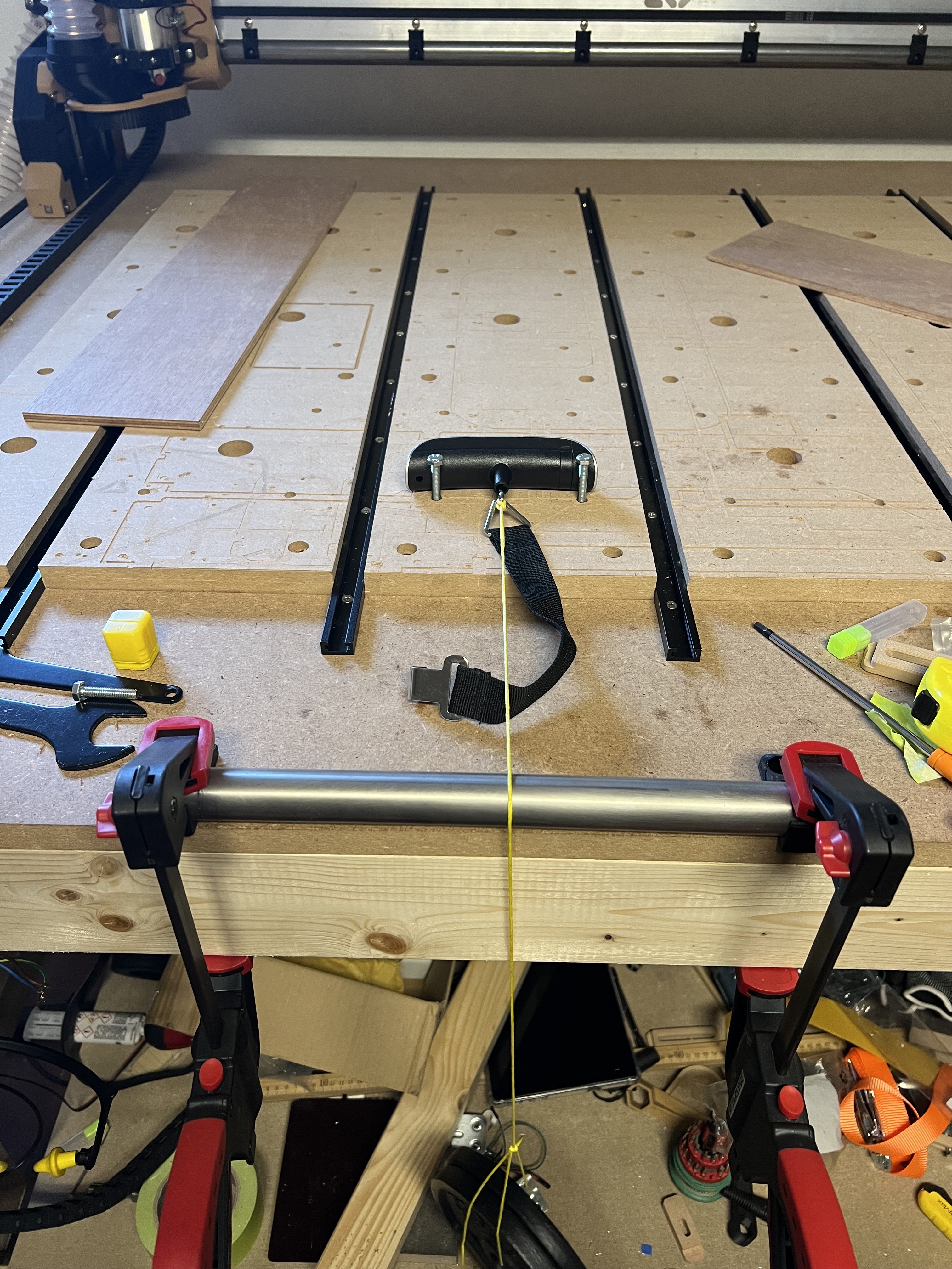

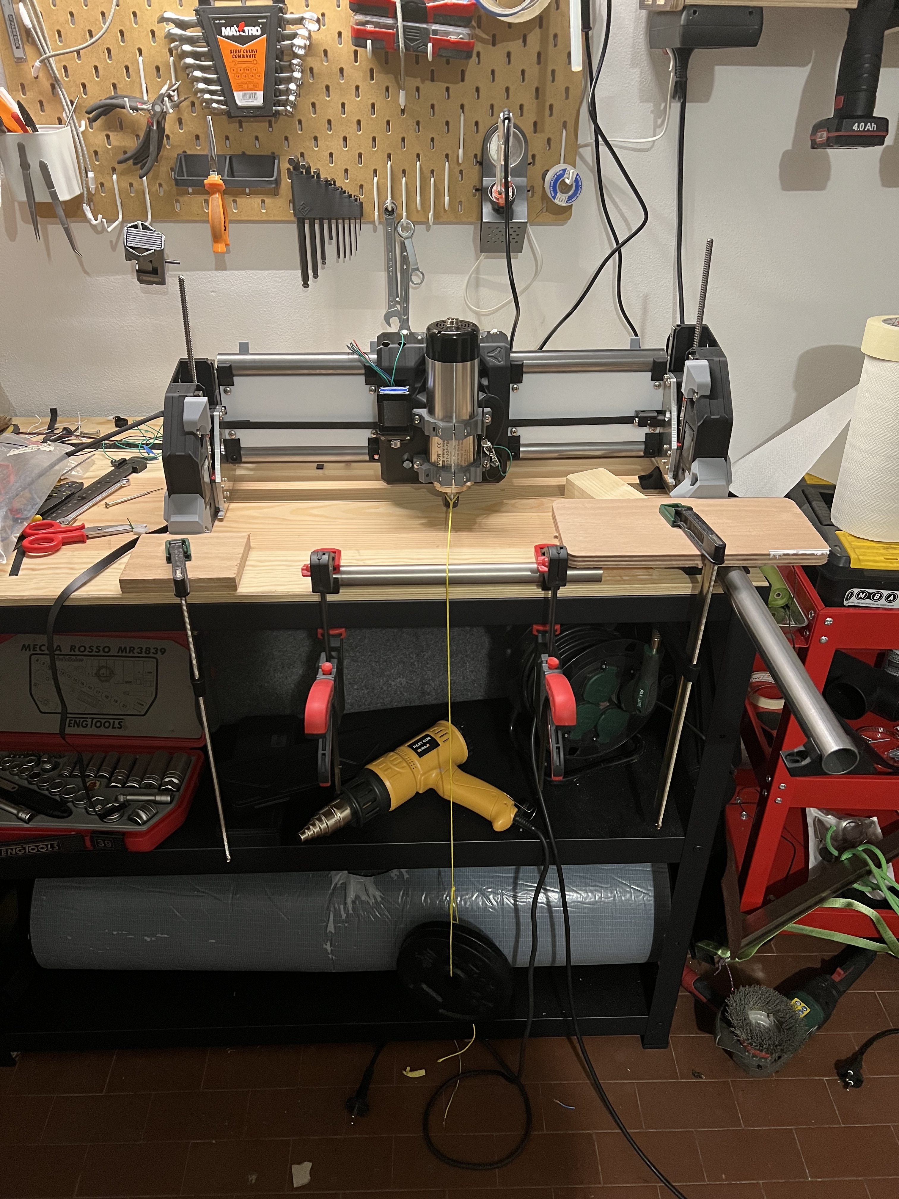

With 4kg seems to have no deformation, or less than 0.1mm

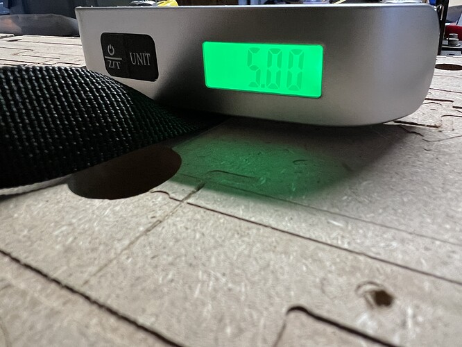

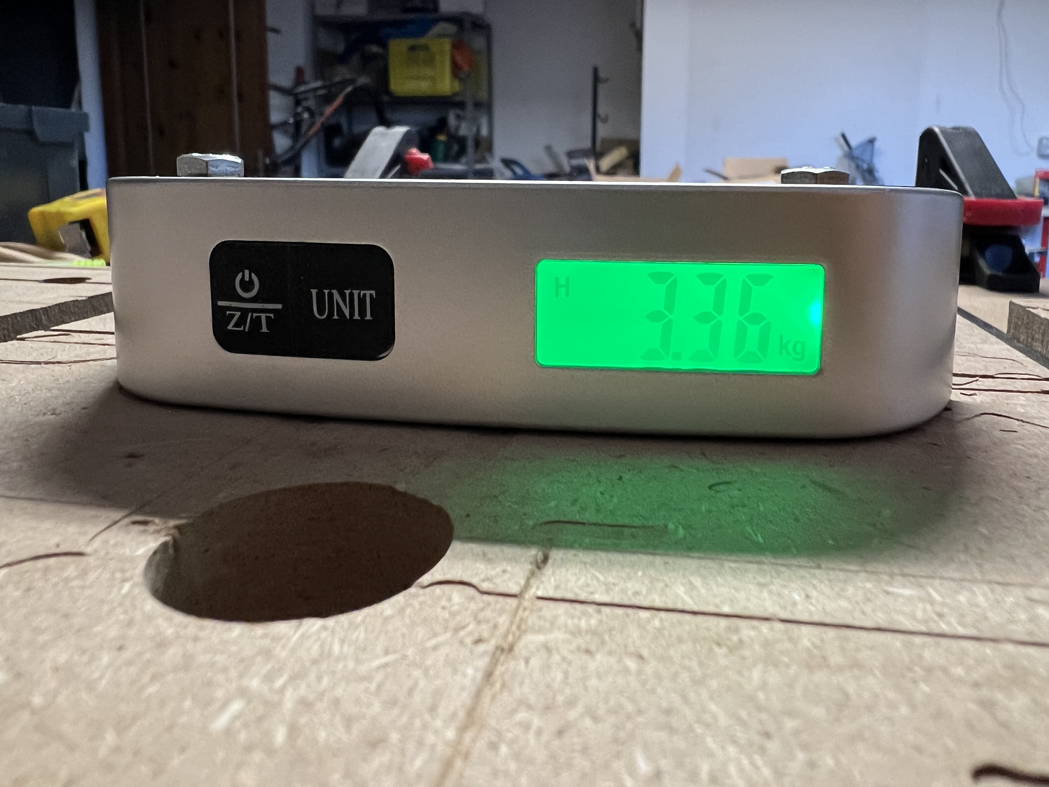

This will apply a little bit less than 4kg of force due to the rope bending over the EMT. This may be “good enough” for these purposes. Putting a force gauge between the spindle and the EMT would tell you how much force is lost and allow you to compensate.
All measurements here are relative, so I don’t think it needs to be super precise, it just needs to be repeatable. If it’s 3.8kg of force each time then the comparison holds the same, relatively.
We don’t have a good absolute measure for the force we need to handle via the cutting tool, so it’s less about exactly how much force produces how much deflection.

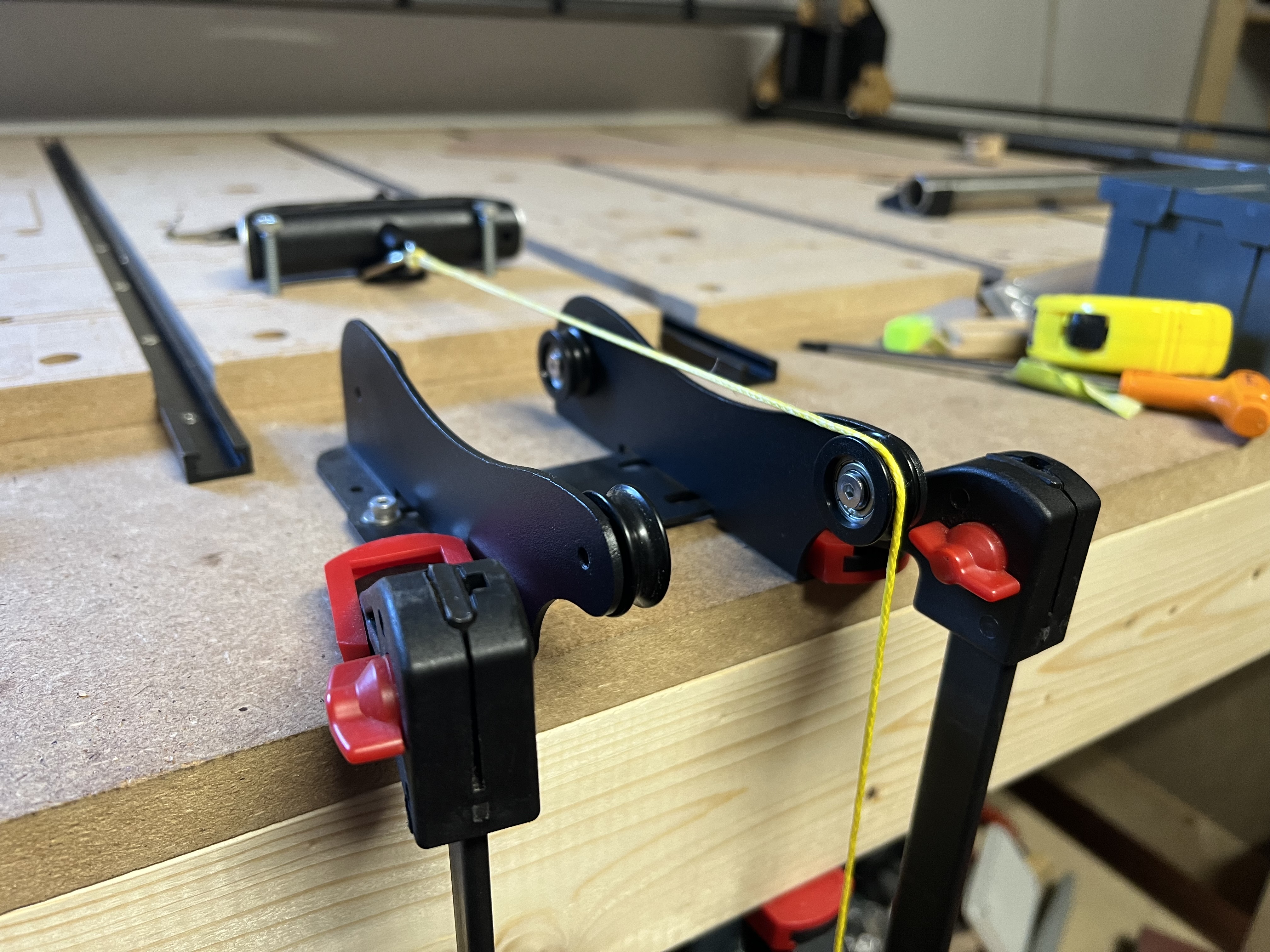

That’s true, I’m using a Dyneema cord that’s really stable and slick, and creates low friction, and used the same setup on each test to be comparable.

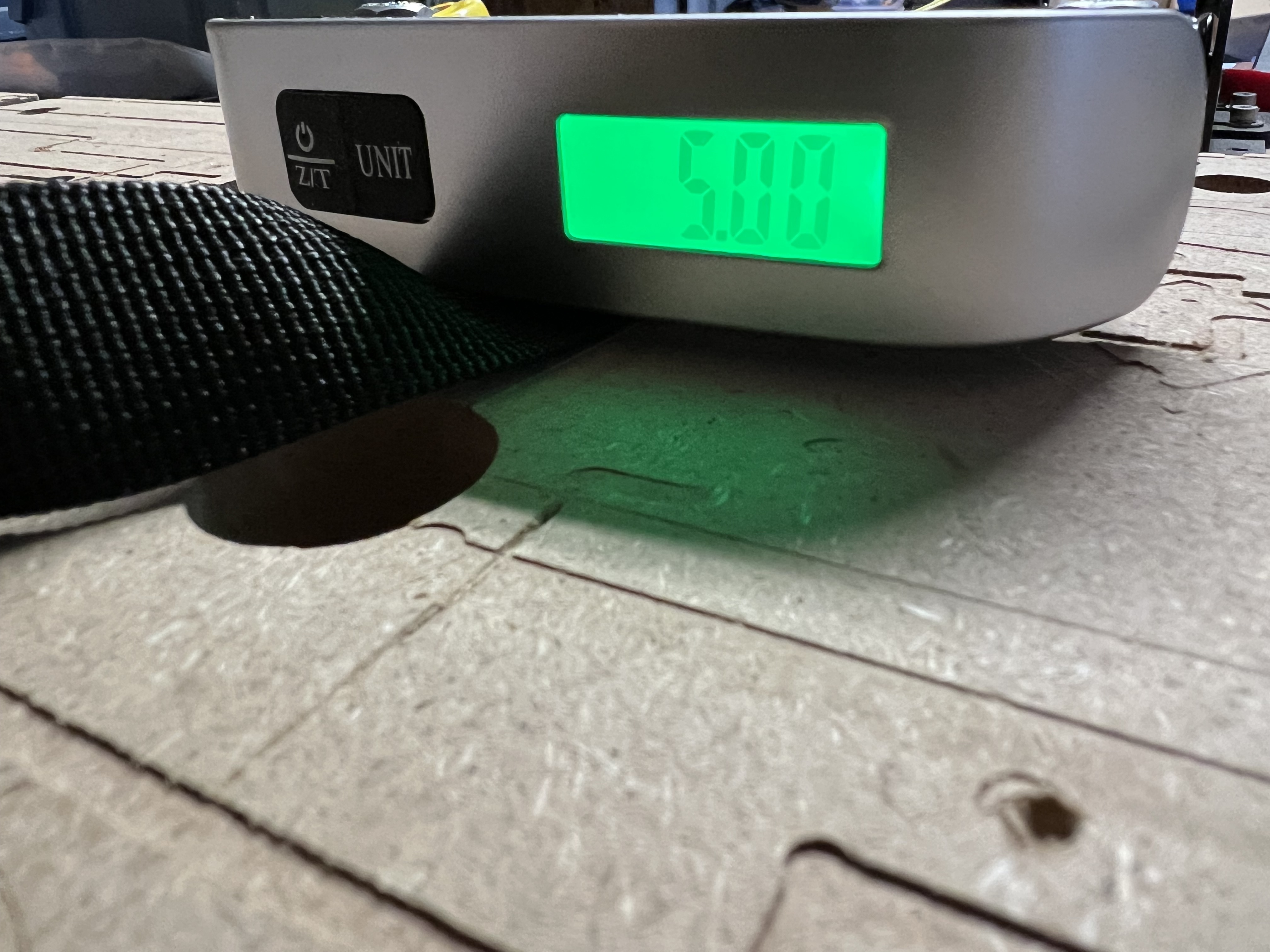

The real applied force is about 3.4kg and seems to be a realistic value anyway, cause it’s close to what we will generates during normal cuts. Anyway, I’ll correct the weight and perform the test again, with a caliper instead of a ruler, and a bearing pulley instead of the tube.
With a pulley instead of the tube the force match exactly the weight applied.
I’ll test both machines again with 5kg.
