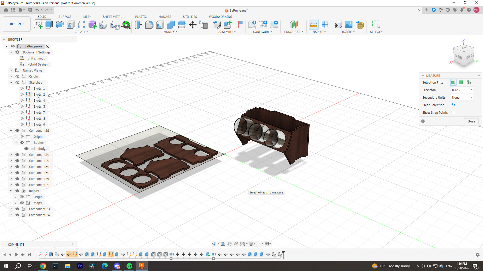

So now I just designed and cut this, which is something a friend needs for art stuff.

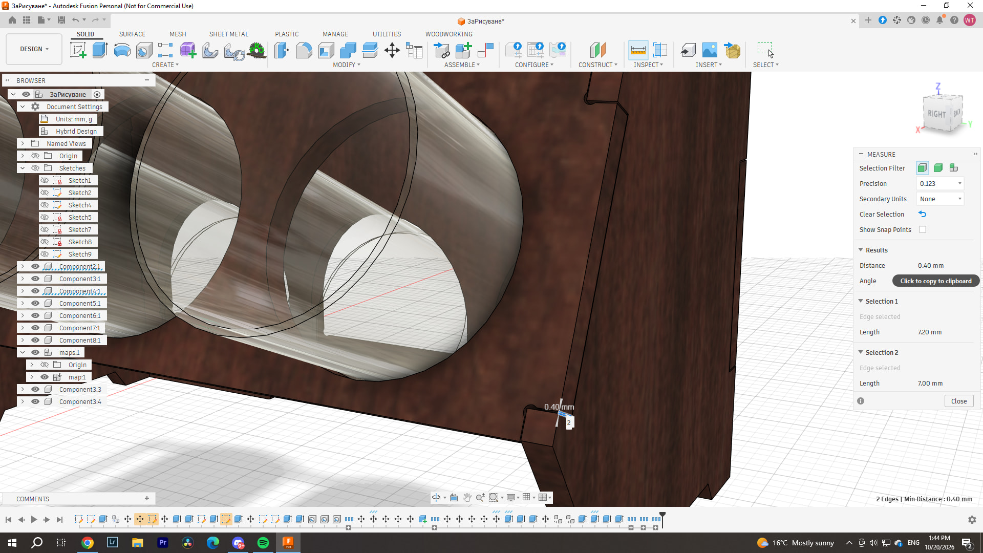

For example, current small project I set 0.20mm on each side of the parts that I need to fit, so total 0.40mm. I set them at 0.40, because those were the tolerances on Ryan’s table, and everything fit perfect.
I’ve measured diagonals and every part every time I cut with the LR4 it’s square and cutting straight everywhere, and on the whole 2500mmX1250mm, anywhere I measure the cut, its exactly within +/-0.20mm of the exact size set in fusion.
However, when it came to assembly, them parts were somehow 1/1 equal size down to 0.03mm?
This is the first time I tried to set bigger tolerance in the 3D model itself, so it fits easier and not like my first project, however it came out too tight again.
How do you go about with setting the tolerances on your LR4? Do you always cut test pieces, is the tolerance the same every time or does it deviate and you change it each time you cut, I’m 100% green to CNC and everything I learn is from trial and error with the Lowrider, thank god it just skips a step or ruins a bit if I make a mistake.
Now I’ve set them to .40mm on each side. The glass diameter is 65mm and I’ve set the holes at 66mm, and they were spot on the first cut. I’ll wait for some advice before cutting this one as I’ve got material for one more left :sweat_smile:

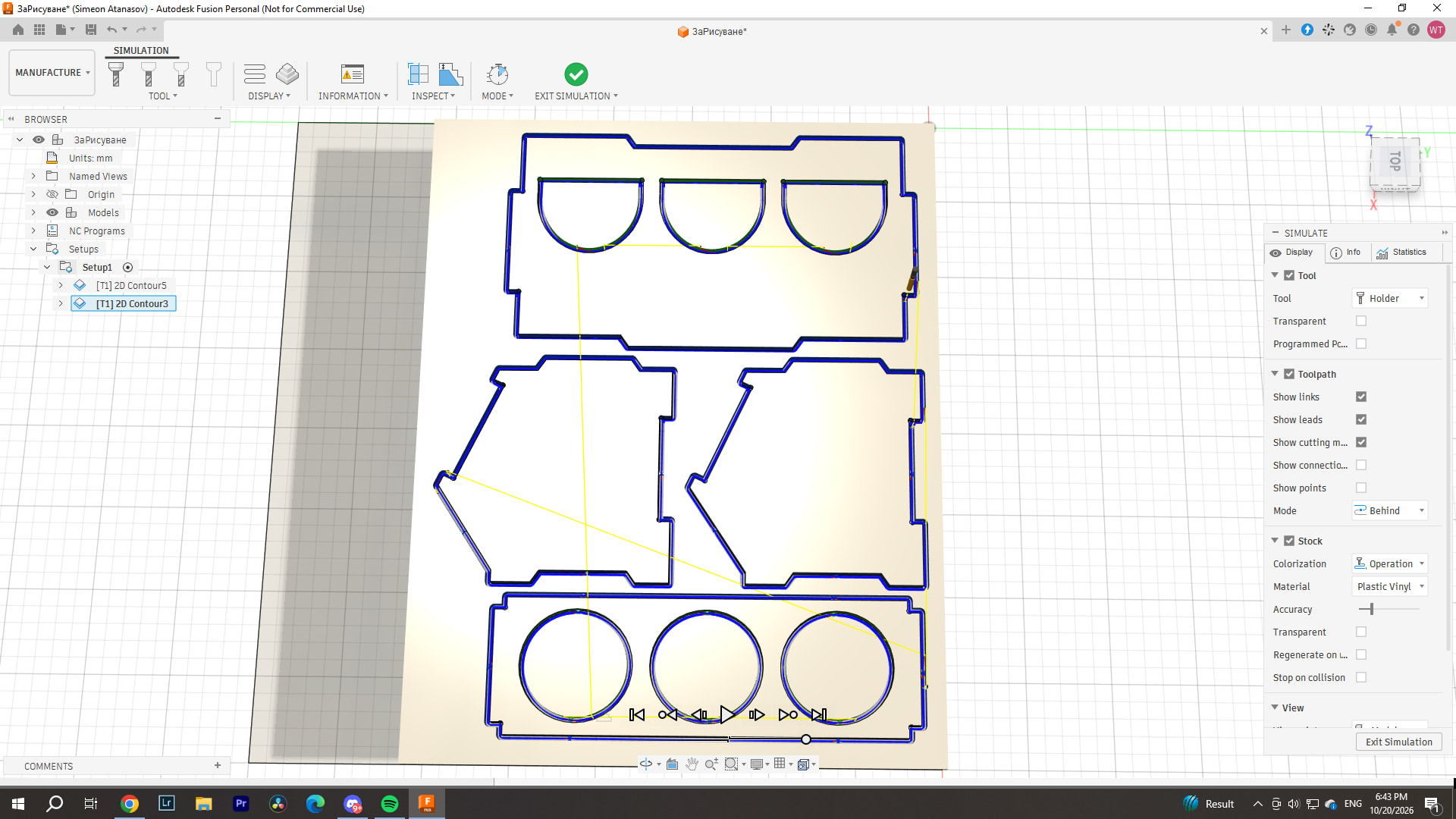

Are you using a full depth finishing pass? You noticed that cutting on an X Y diagonal produced the tightest joints. By leaving 0.8mm of stock on your initial cut you can go back and do a full depth cut removing that 0.8mm and get a much more precise joint. Give it a try on a test piece.

I’ve not yet done finishing passes, for now I’ve been cutting to exact dimensions from the start. I’m still learning each feature one by one and playing around. For example I now use ramp at 35 angle and It doesn’t stop to plunge for the next pass but just gradually goes down, sounds much better too.
I use 3.175mm upcut single flute carbide bits, its cutting lenght is 15mm aaand I’m still not very well versed in these things, but I don’t really know what I’m using, I couldnt find it anywhere for an option to change conventional and climb. But I use 2000mm/min feedrate, 1.5mm doc, 35 degree ramp, 1500mm/min on the ramp, 300mm/min on plunge. at around 15/16k rpm, its a line before dial 3 on the makita so its somewhere there. I’m guessing at default it cuts conventional?

If you plan to measure anything, always do a finishing pass 100% of the time.
Make a single pass and measure your cut width. Almost all 3.175mm bits are 3mm.

Measuring the bit does nothing, it has to be the cut.
Use those numbers, 3.05 sounds fine. This also accounts for any spindle/collet runout.
yes Always, 10-20%bit diameter in wood.
