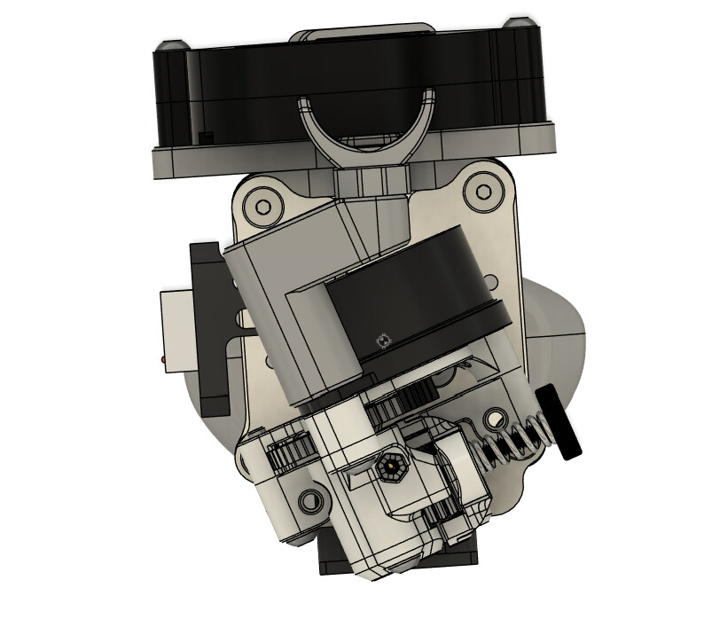

One side effect minor advantage of the gear reduction is it puts the motors outboard on a separate part so you could use a more heat resistant filament and add more meat for the screws to grab and take up the slack as deflection occurs over time.

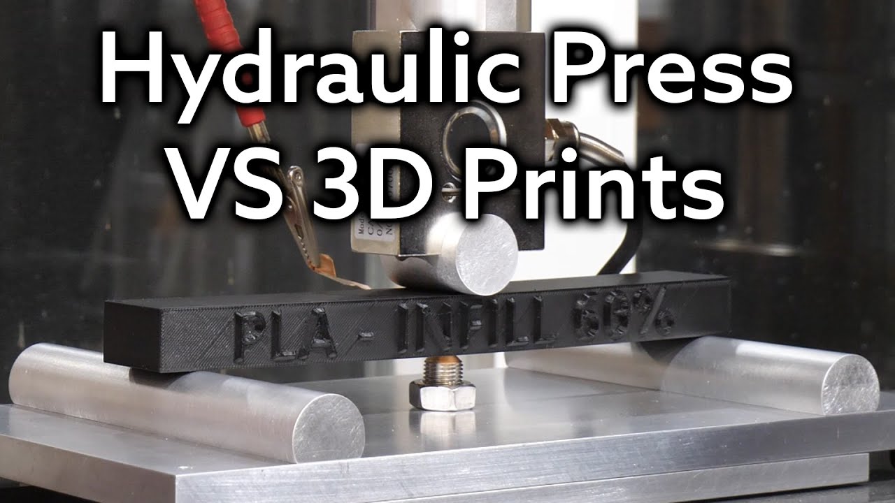

Two great things to watch regarding part strength
Tech ingredients did an amazing video two weeks ago. Worth watching for the description of how composite materials work by itself. But the results are super interesting.
He specifically tests the impact of infill density on bending strength of PLA when loads are applied to beams parallel with the layers (doesn’t test isotropy so we don’t have results yet for loads applied perpendicular to the layers, but has said he will)
Interestingly the results I interpret as exponential - e.g the difference in bending strength between 10 and 30% is minimal, but the difference between 60% and 80% infill is massive.

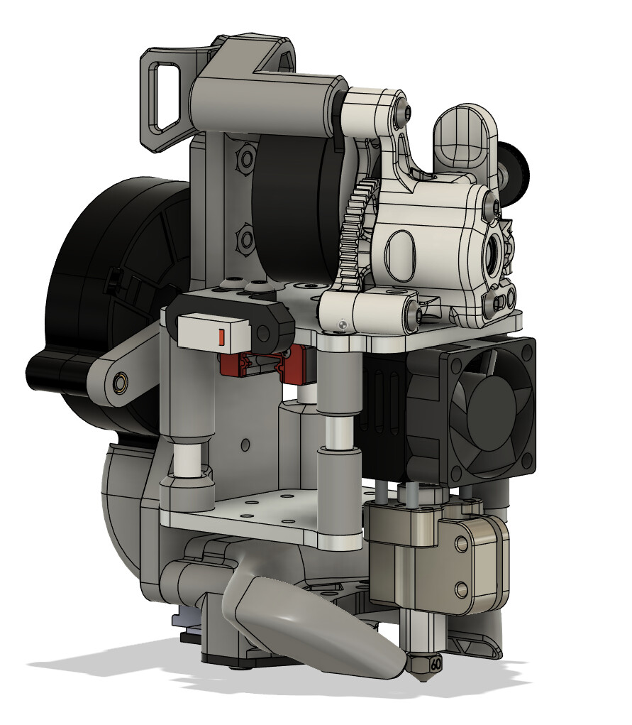

You say flying gantry so I assume 2.4 or SV08? I designed the Fourbie mod(Fourbie/Fourbie v2 at main · MakerBogans/Fourbie · GitHub) - mostly to get improved balance on the hotend and AWD since people wanted it. I decided rather than reinventing the wheel with the toolhead I would start with a vz printhead as the base and I am glad I did. As far as toolheads go as I believe the biggest limiting factor for performance on the 2.4 is the toolhead and gantry balance - essentially the same thought process as lowrider - reduce the moments and get more performance with less expensive components. Also just where all of the forces run in front of the gantry extrusion is loading up the xy joints - forces are in the wrong place.
My toolhead now only shares its DNA with the VZ toolhead - and the ducts and cable stay remain the same. Because why change the ducts. But its essentially a mod still rather than a new toolhead. I just worked to further improve the ballance and get the centre of mass as close to inside the mgn rail as possible. I didn’t quite get there with this version, but its damned close sitting on top of the carriage.
(COM is that little sort of checkered dot in the middle of the screen)
I mention this because I was blown away at how much more effective a single 5015 is using the goliath duct(not using with goliath) than in the voron toolheads, and I am getting similar cooling performance to dirty bird which is twin delta 4512 - it should be worse. However only specifically with the GDSTime ball bearing 12v fan overvolted to 24v(yes, this fan can take it) Very interesting. At least for me :smiley:

I have a design for a totally different toolhead that should give me a lot more flow and even better balance, and (fingers crossed) much better cooling. I just have to mill and test it and I keep getting distracted with other projects like building lowrider :smiley:

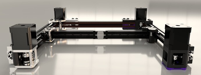

Should be a fun progression. Crossed gantry designs don’t scale super well to that size with any of the designs I’ve seen or played with from a performance standpoint. This is because gantry weight increase with size higher than other solutions. But would be a lovely reliable machine and that does scale. I had 1500h of basically maintenance free 15 to 20k acceleration(higher for infill) 400mm/s printing on the k3 with essentially no significant mechanical maintenance before the bearings gave out. That’s a 180mm machine. You won’t see that kind of performance from a 500mm machine but given it will be printing slower, you may get way more hours. The very linear forces in the motion system and ahort(relative to build volume) belt paths are well suited to reliability. Metal gantries - while again have little positive impact on speed - fantastic for reliabiloty(reduced mean time between failure). Will be a very cool project indeed.

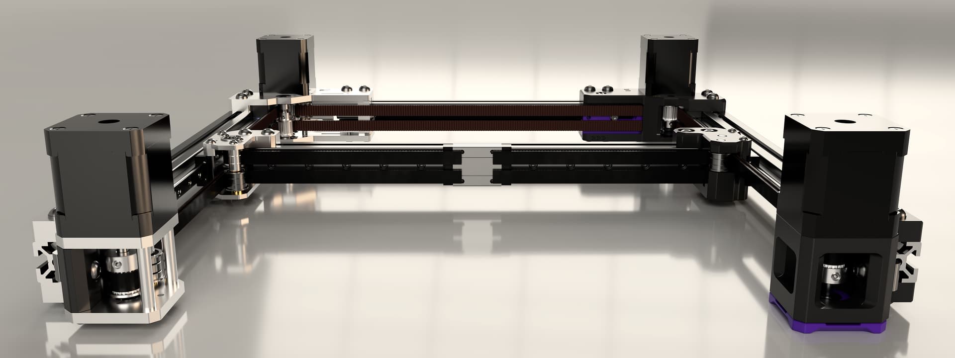

I think I mispoke… the metal gatry stuff is really me replacing the plastic parts with machined versions. This is the monolith project in the picture, but the idea is to do everything like on the left. Holding belt tensions better, and added rigidity. Who knows though. Its all just an idea I have been kicking around for a long while now. My 350mm SV08 very rarely leaves me wishing I had a bigger machine, so it might not be worth the hassle.
Monolith is an excellent gantry :slight_smile:
I once had dreams of large machines. Then I started calculating the plastic costs and decided against :smiley: lots of my use cases for larger things work better with hybrid cnc and 3d printed construction.
What I’m finding is that one axis being bigger makes more sense than all three. You can increase the y travel without changing the x gantry. You can get way more z travel without losing anything on the x and y. And like i said, 350x350x350 has almost never had me wishing for more.

Btw, I wanted to test your gear reduction for enhanced force on the motors. Do you have those available/are willing to share?
