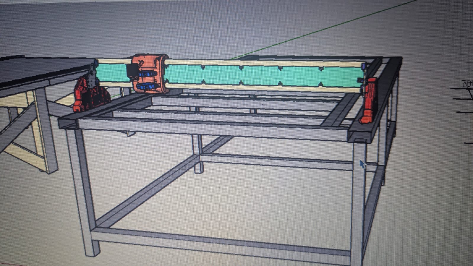

exactly all this. I didn’t color scheme when I built my LR3, I just used whatever pla I had and I really wanna do different this time and would like to visualize it. I also made some very cheap (low effort) files for my “Mods” that; now that I know 3d modeling better wanna spend more time on and as I do like tinkering, “re-modeling” everything can be very time consuming.
but none of it is detrimental. It mostly spacing everything in CAD appropriately for easy remix is what I am aiming for. I 100% understand Ryan’s reasoning

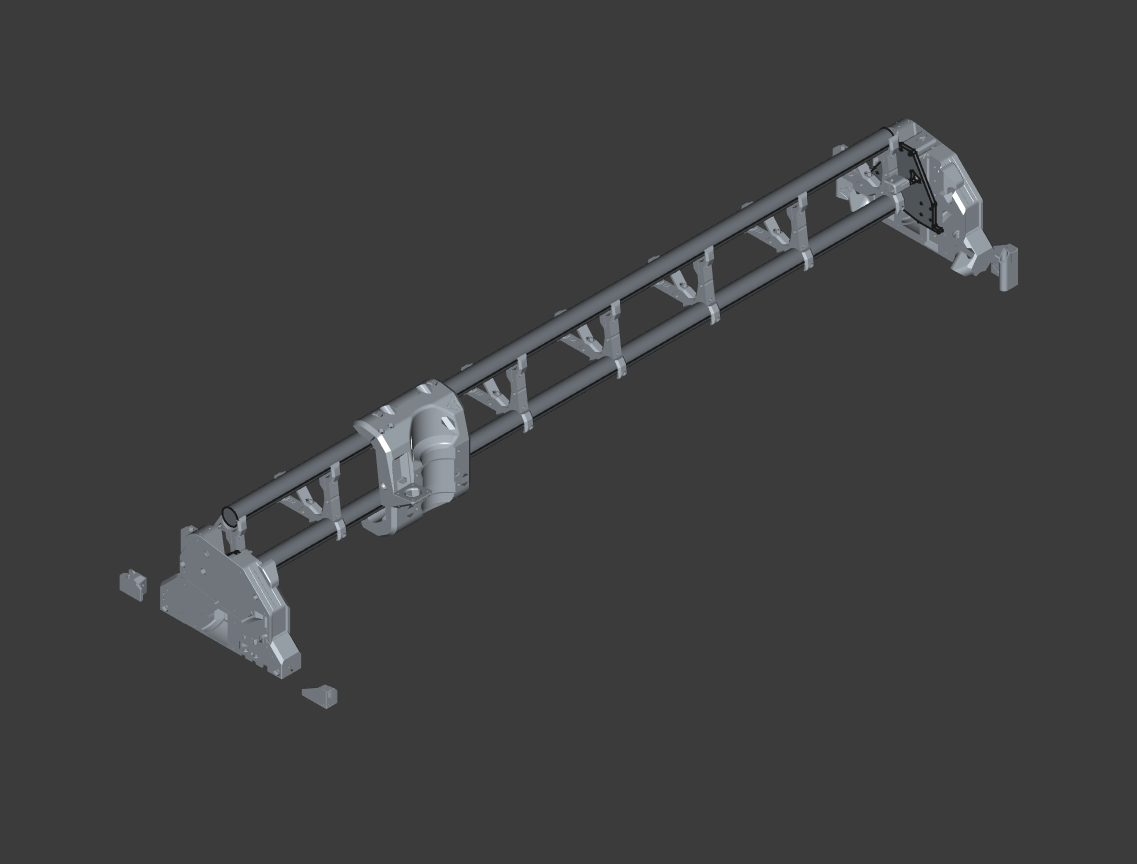

If you just want to place the parts colored/and assemble them in cad: import them to SketchUp and soft the mesh faces. A fully lr4 asembly eats up a ton of RAM
Its rough but I’m getting there, Nothings is appropriately attached and in no way am I doing the hardware but this is close to everything I need. Just gotta align a few more things :dizzy_face:
idk if its just a freecad thing or maybe a ignorance thing but alignment sucks
Can you share your file when it’s finished? I recently completed my first build but was similarly disappointed to learn the CAD wasn’t available (no, STLs don’t count :stuck_out_tongue:) and would have really benefitted from a complete assembly like you have there.

I did mine in SketchUp and worked out just fine (except my 16gb of ram cried)
Sharing stl assemblies is fine, but… we have already had several incorrect assemblies shared on the LR4. So I highly recommend you do this yourself. If you look in another thread we spent 3 days checking the calculators, my personal cad, the stl’s that are shared…all because of an incorrect assembly, that was being used to build a table.
If you change the parts to a different file type errors can occur, important details can be lost and that is not good for anyone.
