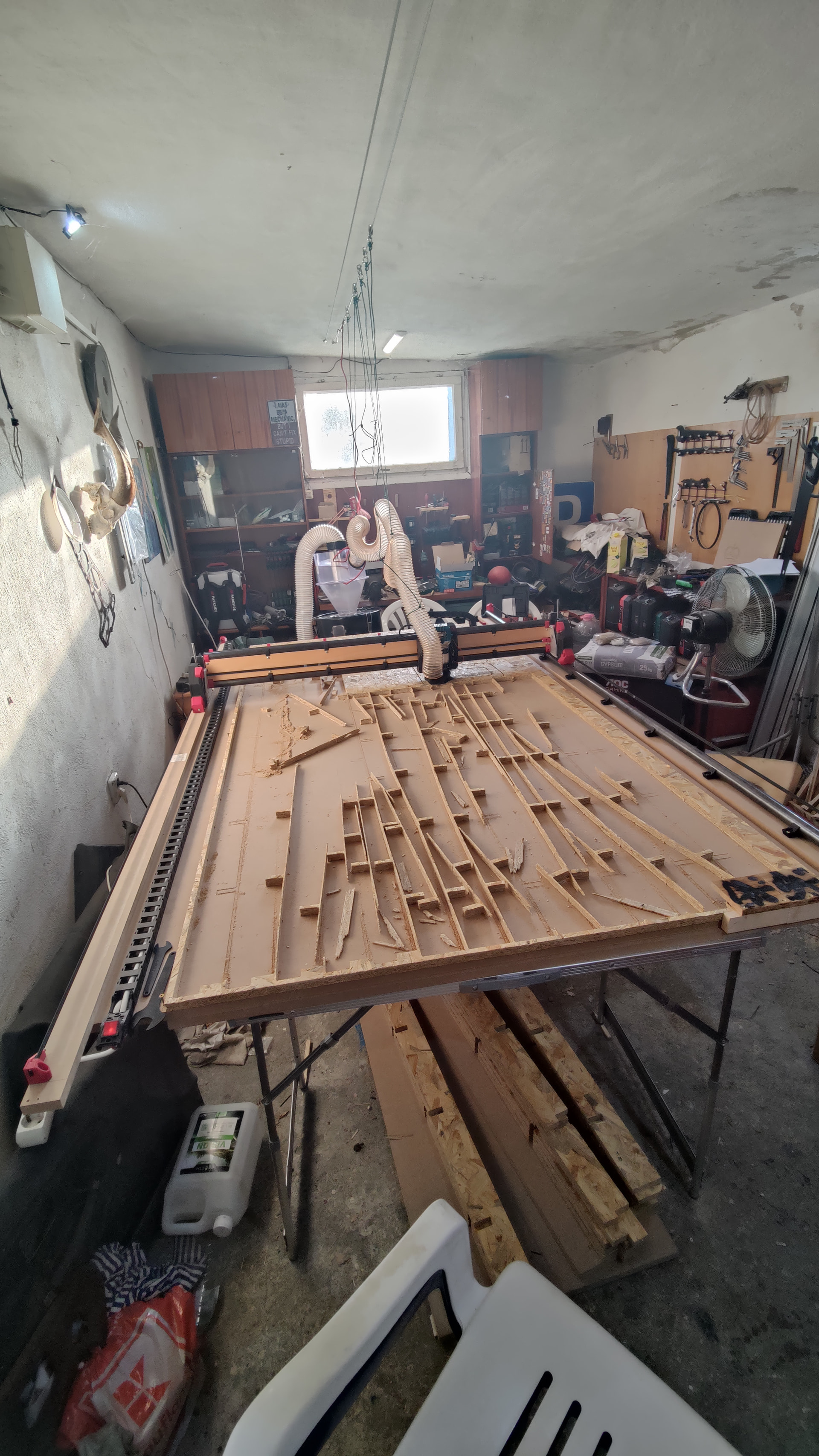

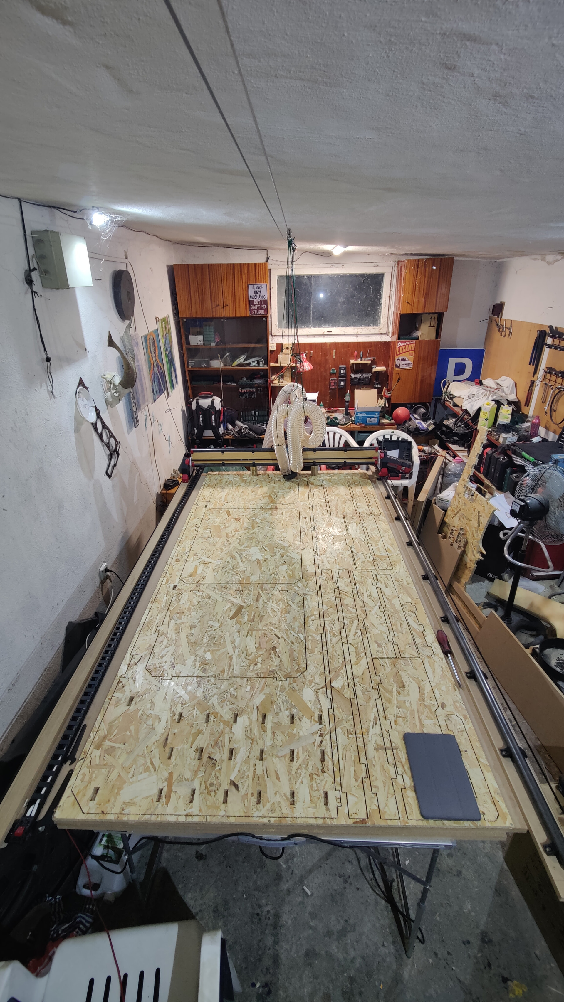

For now I’ve cut 7mm plywood for my strut plates, 18mm OSB3, 15mm OSB3 and 12mm OSB3 for the torsion box, the top and bottom of the full size table Ryan shared and the settings I’ve used until now are on a 3mm bit, 17krpm, 1.5mm depth cut, 2000mm/min X/Y and I have not touched the Z cut and travel speeds in the post processor from the forums here for fusion 360.
As these cuts take lots of time, I’ve ran this machine for 12 hours the first time, since the post processor was capped at 1000mm/min. After that I bumped it up to 2000mm/min but I still use 1.5mm depth of cut.

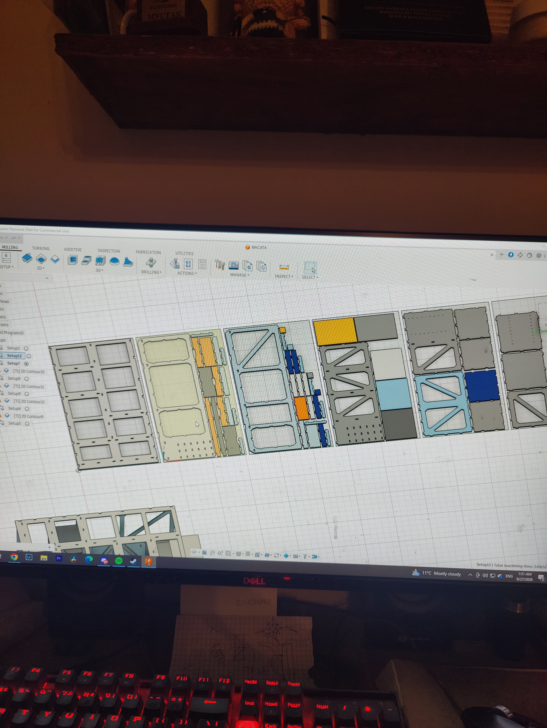

Now I want to try the ramp feature in fusion, since the bit for my previous cuts just plunges straight down, even though only 1.5mm I want to make the cuts a bit faster and safer if possible.
I’ve set the ramp at 35 degrees and now I’m wondering what Z cut and travel speeds are safe, as I’m unfamiliar with this ramp setting, and the limits of the LR4 as a whole.

All I have left for the table base is the sides and drawers but I want to try new settings and get more knowledge with each and every cut sheet. Also a little side note, fusion 360 cutting times estimate and real time cut estimate left me babysitting the machine till 9am once, they are sooo different.

Went perfectly! Cut this for 3:20hours with settings listed above.

Even though i haven’t cnc’d before, i kinda went straight into cutting. Oops… :sweat_smile: Good news is its cutting without issues (somewhat, still have that jittering/vibrating to figure out). I don’t know how i missed the milling basics! It even has a nifty calculator in there. I haven’t tried finishing passes too, i must look into that, ive been cutting just final dimensions from start. Im cutting full sheets, it has accuracy of perfect 0.00 to 0.20mm from end to end, amazing machine you have made!
