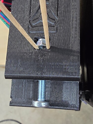

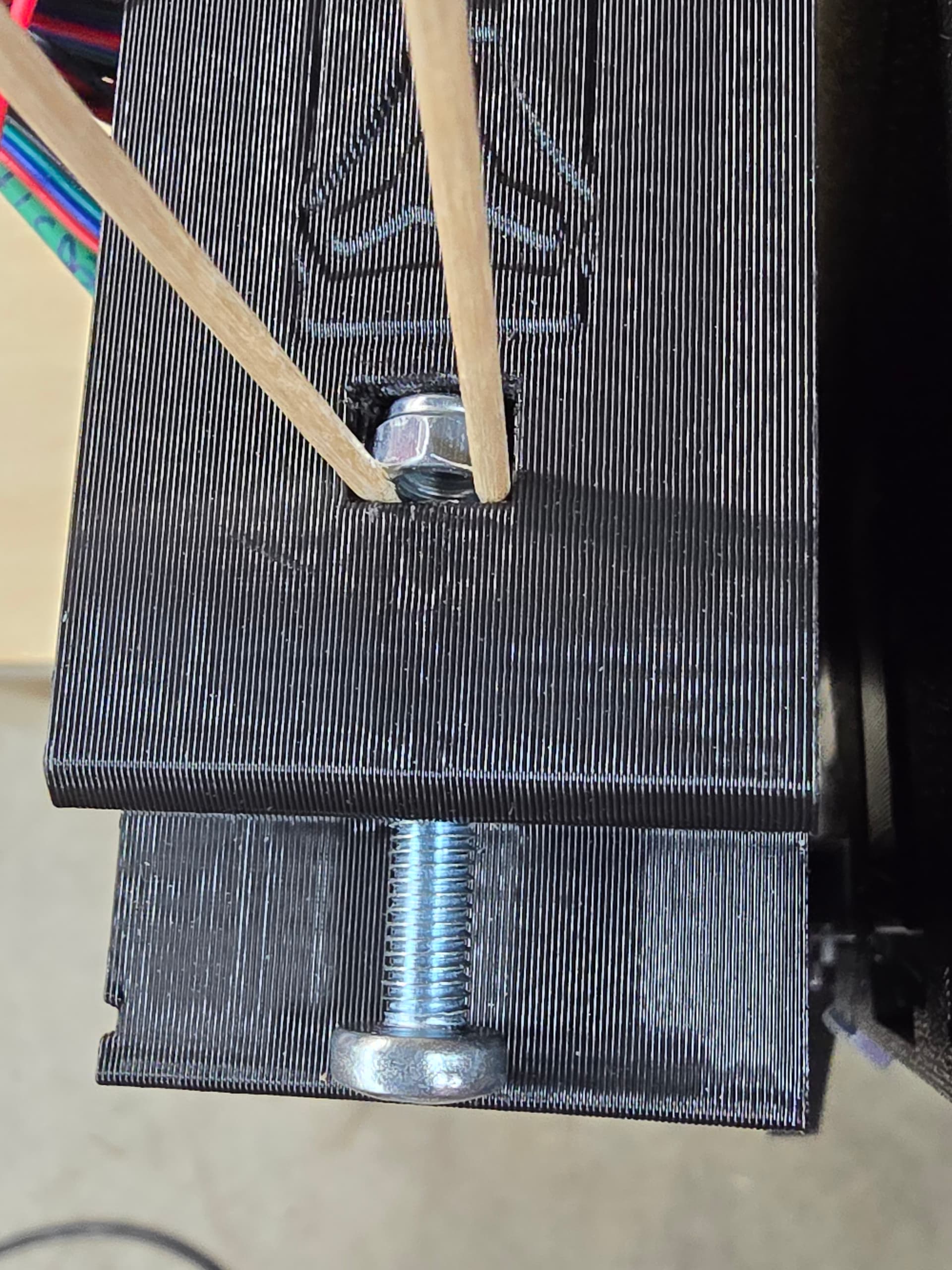

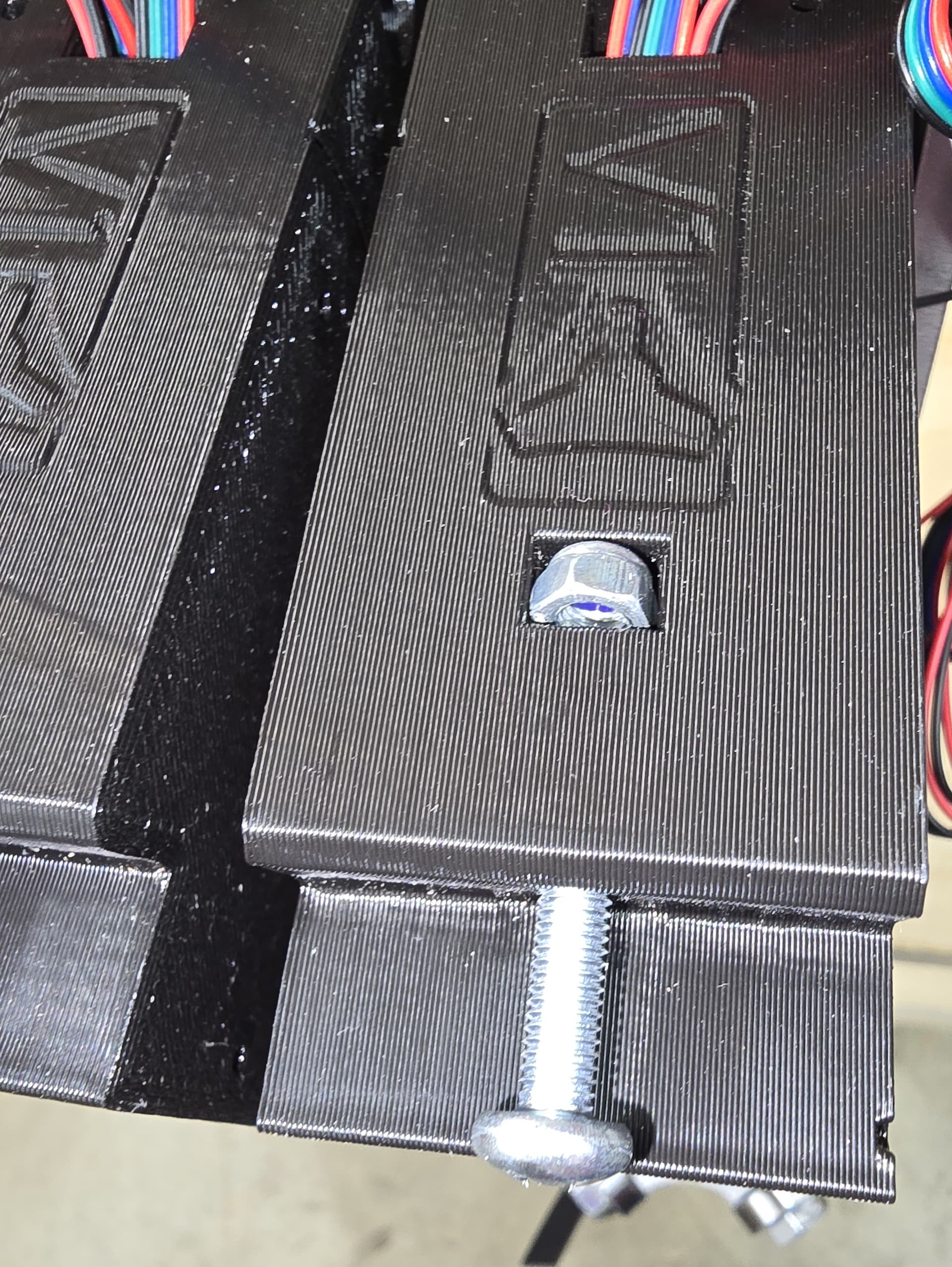

I’ve been having a lot of fun working through this build and appreciate all the design cues Ryan has built into the LR4 printed parts. But I’m stuck on the back wheel assembly for both y-z plate assemblies.
I can’t get the nuts into their pocket far enough to line up with the screws. This is the step: https://docs.v1e.com/img/lr4/yzw8a.jpg
I’ve oriented the screw according to the pocket orientation and every other way I can think of. The nut is just not seating into the pocket deep enough. At first I thought I had a nut-to-screw perpendicularity problem, so I tried using a couple toothpicks to push the screw to the ‘top’ of the pocket. No dice. Whatever I do the screw hits the nut edge that is furthest into the pocket.
