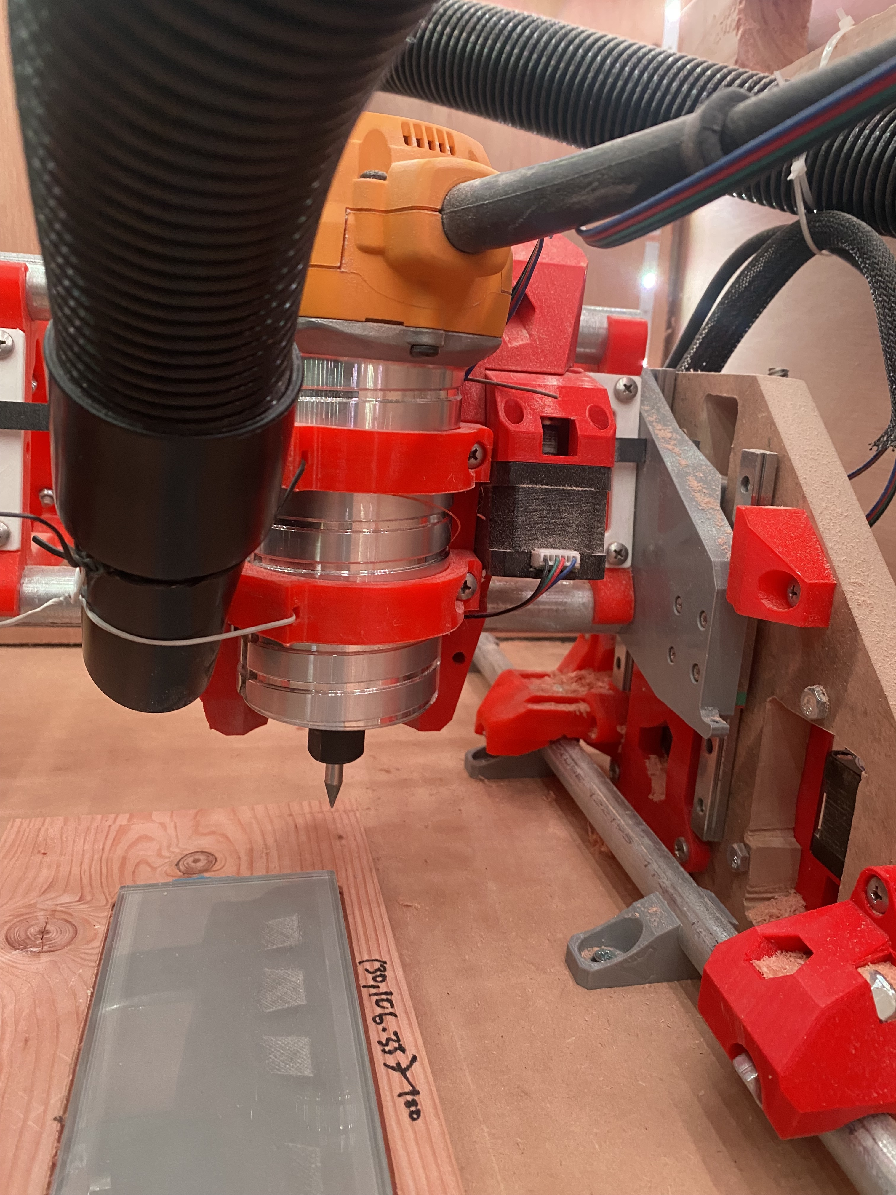

Does anyone know if anyone has made a quick-release for the LR4 (Dewalt 611) router holder?
I’m printing parts for an LR4 build right now. I’ve been using my LR3 a lot lately and really don’t like pulling out a screwdriver whenever I need to do a tool change.
Would be cool to have come kind of cam lock/clasp/over-center mechanism for the top and bottom holder where you can just pop it off, swap the tool out in the router, and pop it back in. Don’t know if something like that already exists but I couldn’t find one on, ie, printables.
Thanks! :pray:
Are you removing the router every time you change the bit??? Once I get my router in and trammed it never comes out again unless I have broken something or am testing something. I change bits with the router in place on both the LR3 and now the LR4.

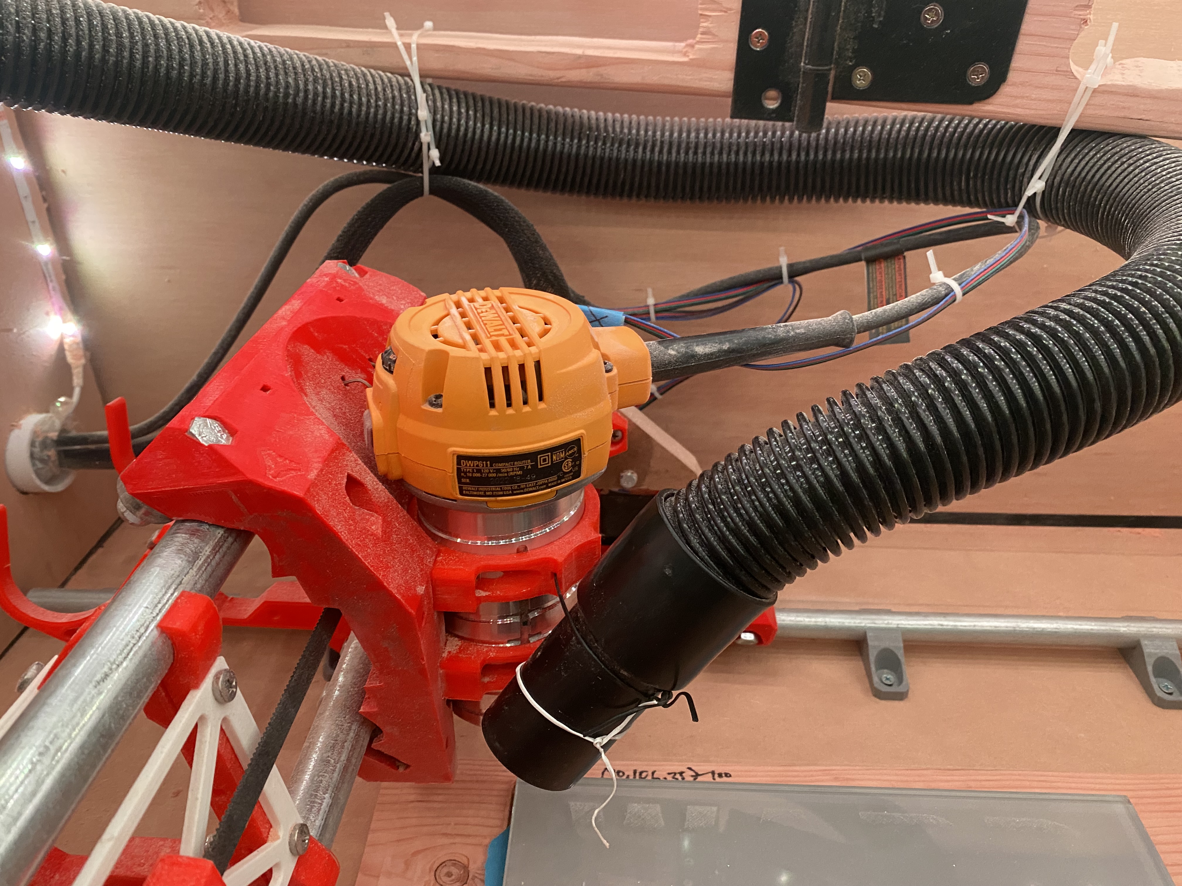

Yeah, with my enclosure setup I have a swing arm for the vacuum hose that I run the router power cable along. It positions the router “backwards” against the core so the router’s release button is basically unreachable
I see, Nice enclosure setup! Can you not rotate the router around and put a “loop” in your power wire to attach back to the hose giving you access to the button? Seems that would be a LOT easier than removing the router every time. But I am just going off what I see in the pics. I am sure something quick release could be drawn up. But I am not sure how well it would hold up to something like the router. Would sure hate to see that come lose at some point during a job.

Smart! I’ll try it out and see if it works for me. I suspect I may still not like the ergonomics of having to crouch inside my enclosure to reach with the wrench but I won’t know until I try :person_shrugging:

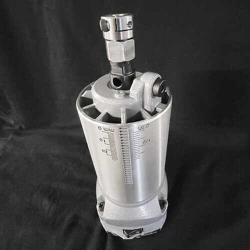

I was trying to find the right one for your router to link to it:
https://musclechuck.com/
It’s a device that replaces the collet/nut on your router and changes it to a split-ring style clamp. That way you can install/remove tools using only a hex head wrench perpendicular to the tool. That plus a decently long regular handled hex driver and I think you’d be away.
They seem to be pretty well beloved by people who have them. I’ve seen people saying they even reduced runout compared to the stock collets…
I think the main downside is cost. The only reason I never got one is that the shipping to New Zealand was brutal and pretty much doubled the cost.
Edit: They’re not bit-size specific, they still use a collet type arrangement to vary the clamping size.
Looks like the only 1/4" router they suit is the Makita, unfortunately.

I found a post on routerforums.com where someone says they e-mailed MuscleChuck and got a reply from the owner saying they’re working on products for various 1/4" routers such as the DeWalt 611.
Could be worth dropping them an e-mail if it’s something you’re interested in.

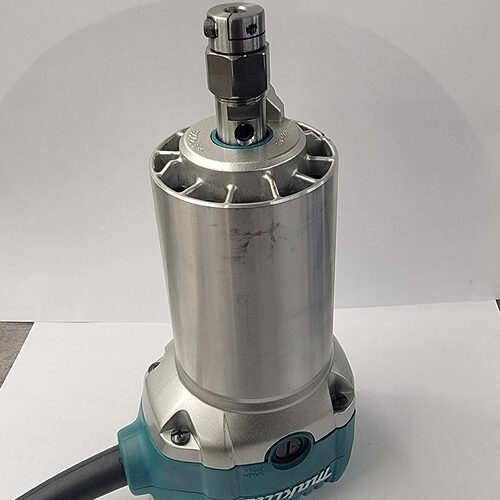

I found this listing on their site for “1/4 inch Musclechuck” and showing it on a Makita Router.
Does anyone know if that would work on the now-discontinued Kobalt router?
I swear they had an er11 collet one when I looked, i would use that one.
Honestly if i knew about this would have got the regular makita lol, :stuck_out_tongue: but i went the er11 version
@RockinRiley @DougJoseph
That seems like it should work with anything that uses an ER11 collet system, such as the Kobalt router.
Their website is weird. They have a bunch of stuff not listed in their compatibility list that’s just straight up available in the store.
