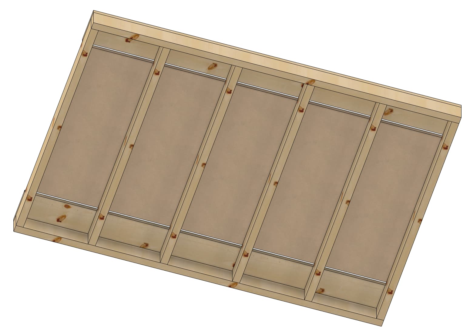

Do you think this is a viable table design?
2x4 ribs with aluminum T-tracks on top
MDF pieces between them, attached to the 2x4s from below with brackets (not pictured)
1x8 “rails” on the side for the machine to ride along (same as my current LR3 table)
Sounds like it’s reasonable to build and should be able to remain flat enough. Looks good.
A bottom to the table will help with making the table a torsion box when assembled which will make it much more rigid. This is helpful but not necessary. (Heck I’m using a sheet of plywood.) So long as the runners will support the machine and the machine itself is reasonably flat, it will be fine.
Reasonably flat varies by what you want to do. Cutting sheet goods, a mm or two of variance probably fine, though that can cause problems with stuff like V-carving large signs, or doing large 2.5D cuts (like putting long dado grooves in a workpiece.) Like I said, I use a sheet of plywood, and it’s fine.
