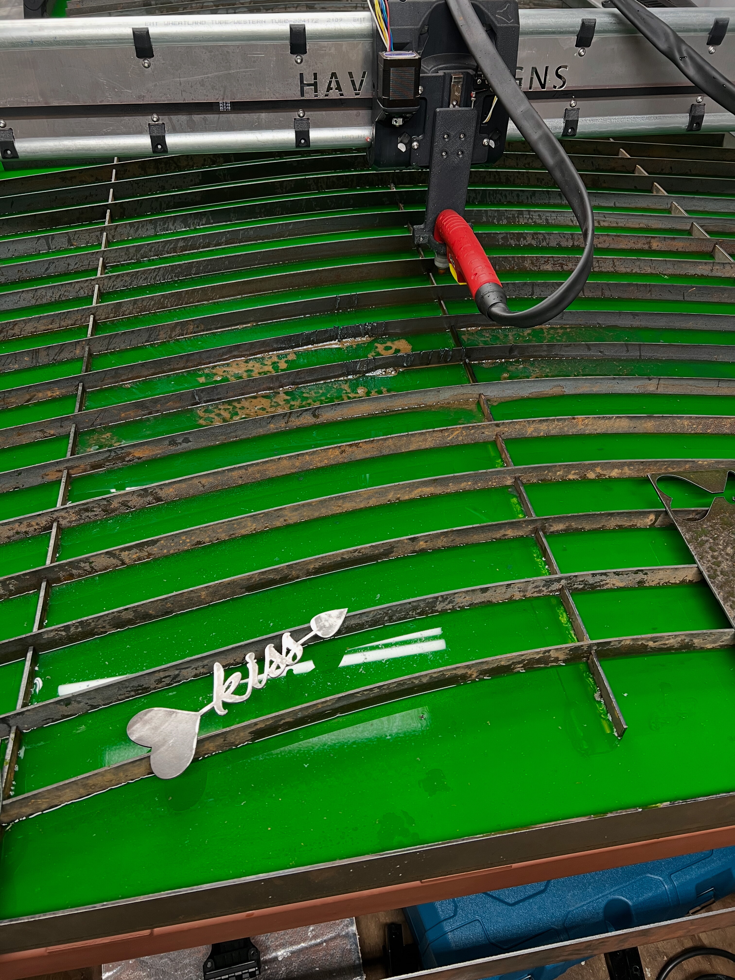

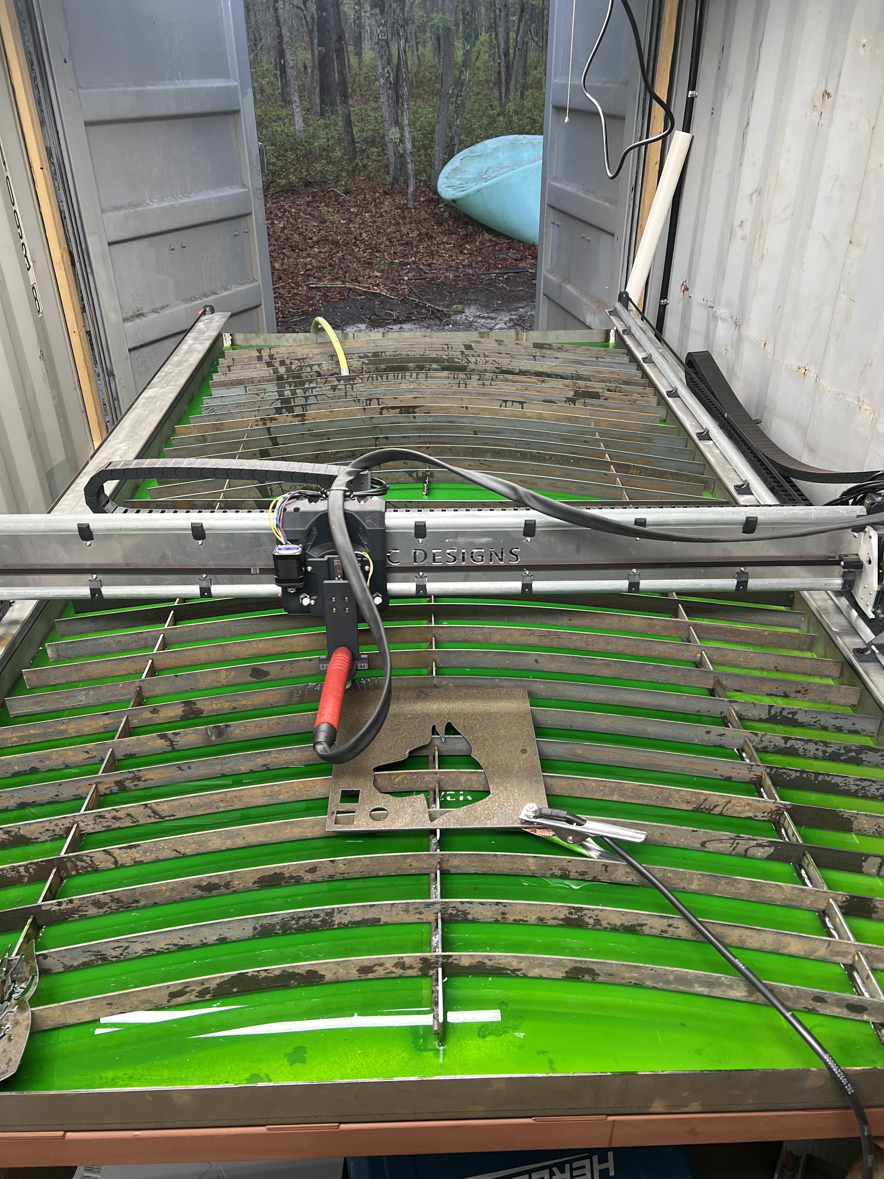

Last night I finally got her up and running after a 3rd rewire and controller change.
4x8’ cutting area
10ga bent and corner welded Water table is 56”x108.875” 3” drain
Under table water storage with air forced refill
Scrap metal table build with 6x6x1/4 legs and 2x3” support posts and 1/4” plate
Controller I ended up with was proma cnc with thc
Drivers are stepper online dm542t
For the z axis I ran both motors into one driver and running 1/4 micro steps and 1.96 amps
Plasma cutter is a prime weld cut 60
Everything wire has shield drains
I’m very happy with the quality of cut just for my test torch mount I still have to redesign it and make it more rigid…
Big thanks to anyone who has helped me along the process

Looks great and sturdy.
What sort of projects are you looking forward to making with this?
1/2”-3/4” base plates for large columns
Brackets for for projects
Anything that people ask for otherwise

Looks great! Any chance for a video of it in action? :grinning:
I gotta pick up some steel I only had alittle piece I brought home for test will post one probably tomorrow I need to print a new stiffer torch mount first
