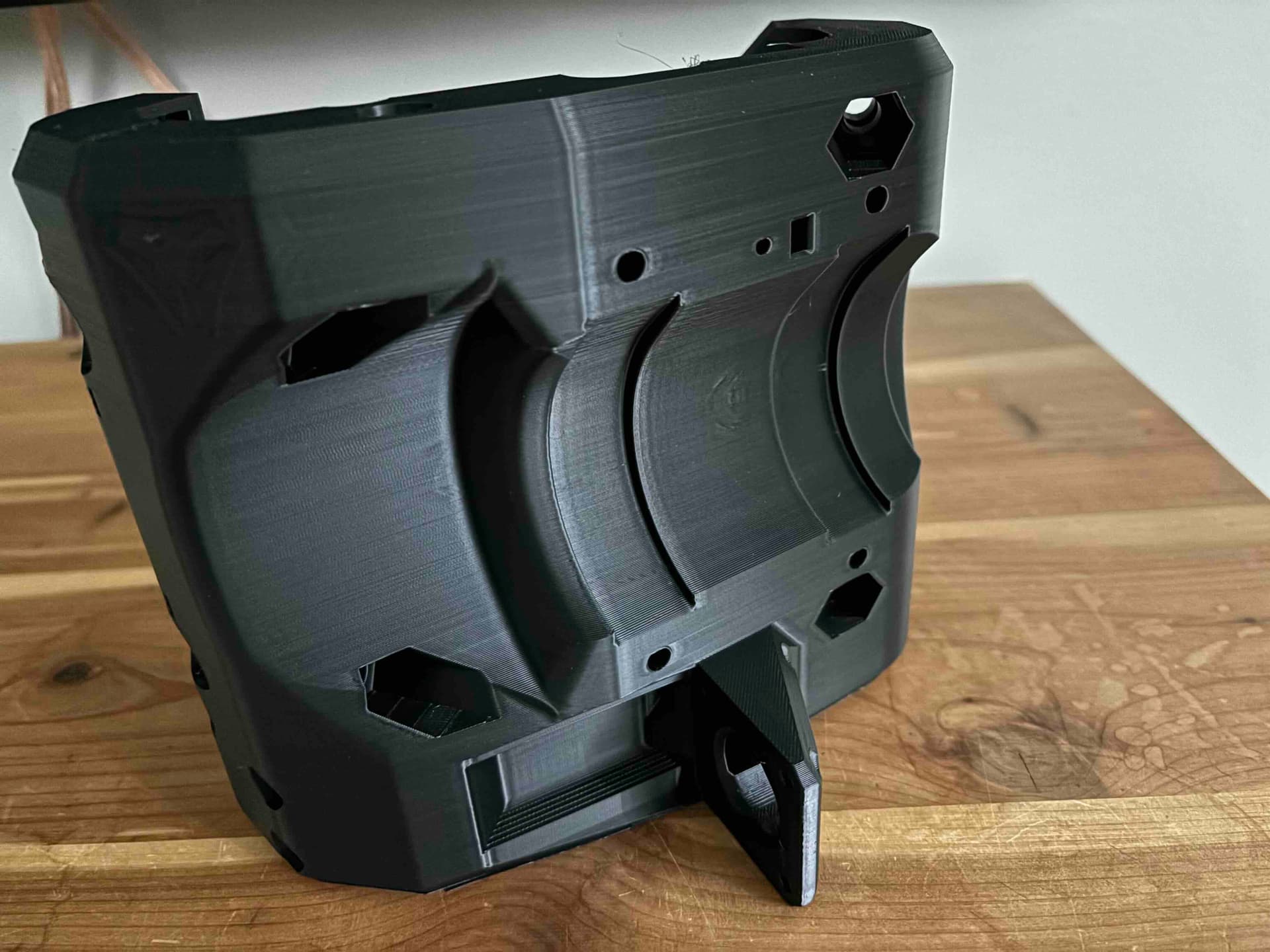

I just pressed start on the print for the core on my Creality K1. Hopefully it turns out alright. Up until now all of my prints have basically been toys. This will be my first functional print. I am just using the PLA that I happened to have on hand.
I spent a bit of time calibrating my K1 prior to this and had to make some adjustment for skew. Other than that it wasn’t too bad.

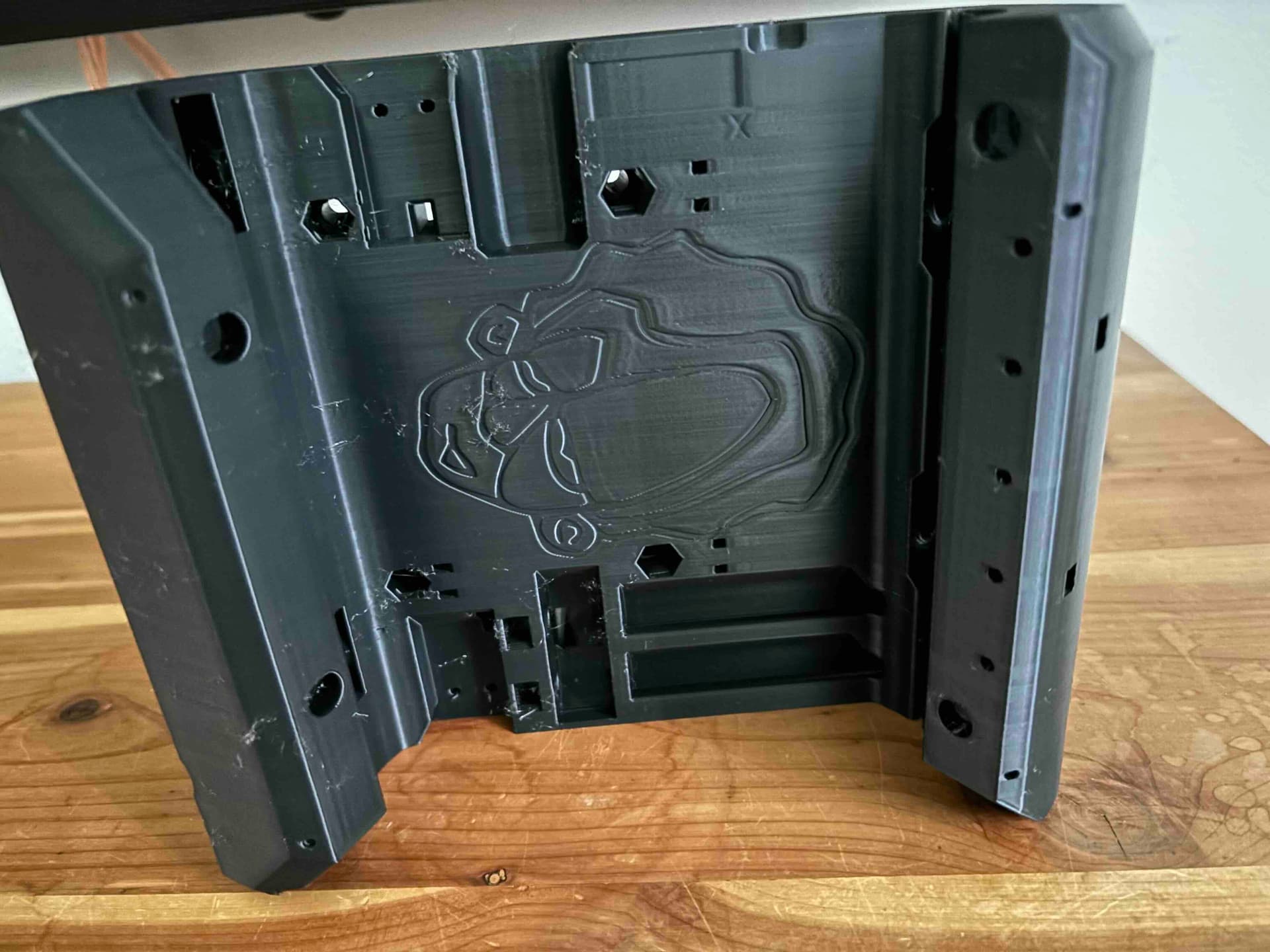

There is a tiny bit of stringing in a few spots, but other than that I think the core turned out pretty good.
Are there any key points that I should measure on the core to make sure that it is ok? Or is there enough adjustability in it that it doesn’t matter?
