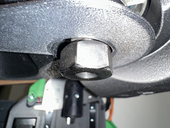

Hi @vicious1,
I just installed my router and the dust shoe and I can confirm that there seems to be an issue it. As you can see in the picture below, the router shaft is not in the center of the dust shoe hole. I couldn’t get it to line up correctly.
Is there maybe something off as the other in this thread suggested.

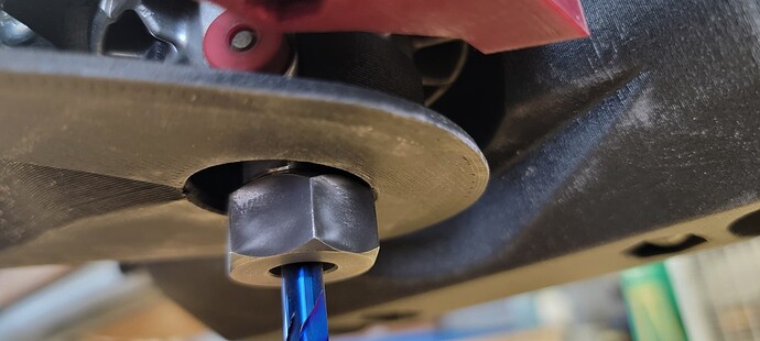

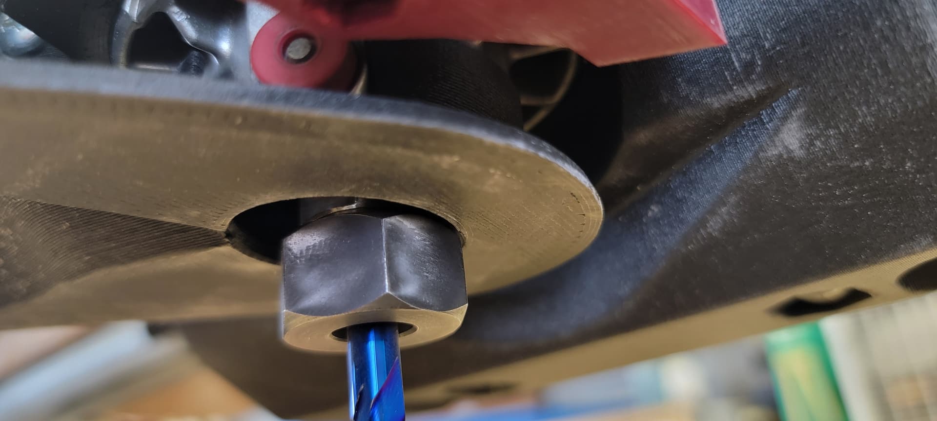

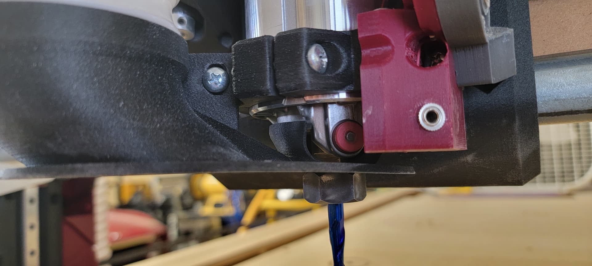

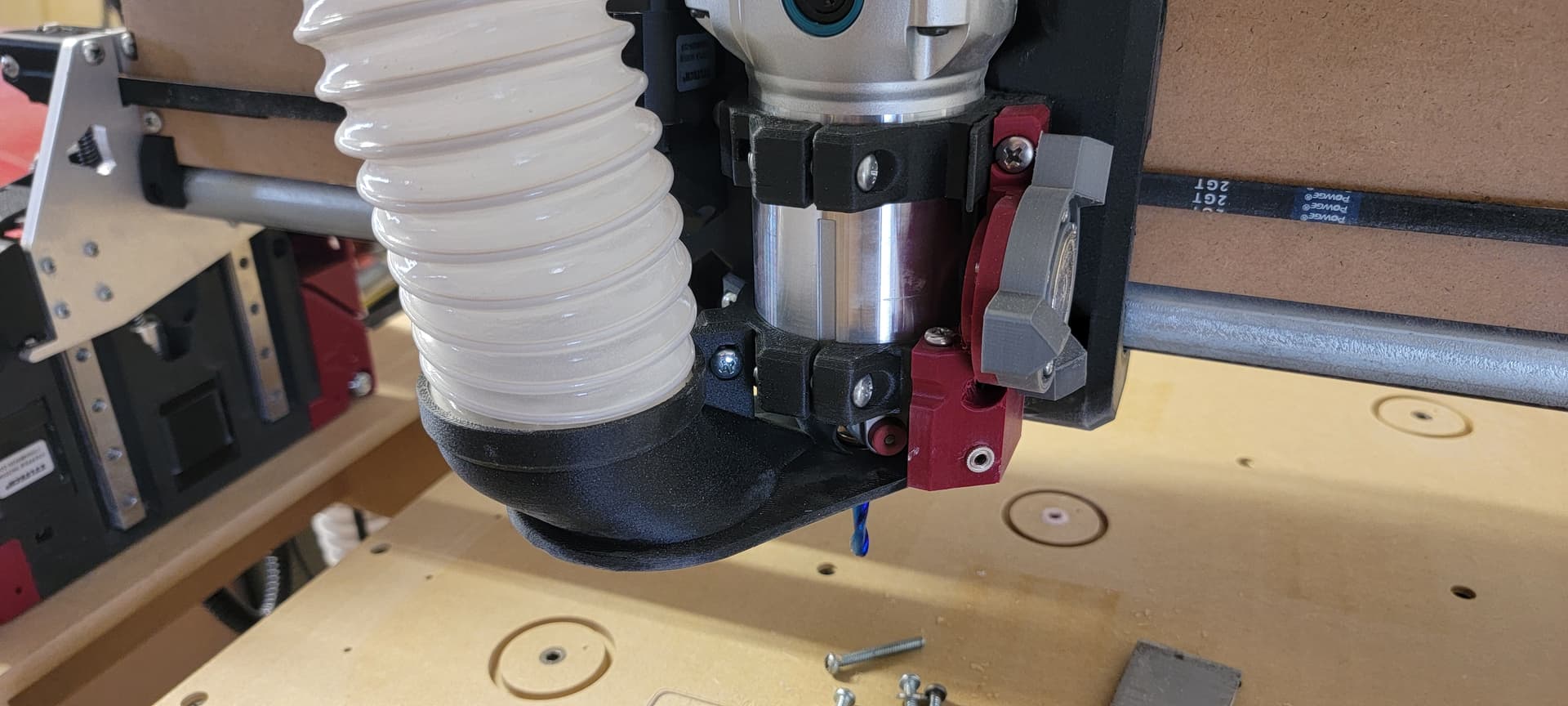

@vicious1 Here’s a few pictures of how my Makita dust shoe is sitting. It’s functional for me, not technically rubbing. That being said, I do remember it being difficult to get into place and the brushes sit at a slight angle allowing some dust to escape at some z heights.
Let me know if you want some different angles.
