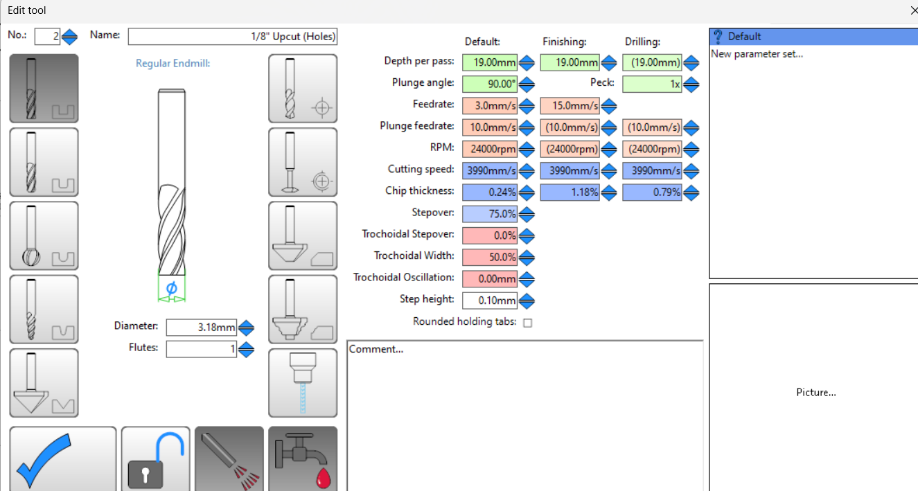

Just using the ‘drill’ option in estlcam.
The bit settings are below. Its 18mm MDF, set to cut to 19mm depth.
Jim kind of said it all: endmills are not good for drilling. You can see them turning black after a few holes pretty often.
Ahh I get it. Of course, its flat on the bottom not tapered like a drill bit. This never occurred to me.
