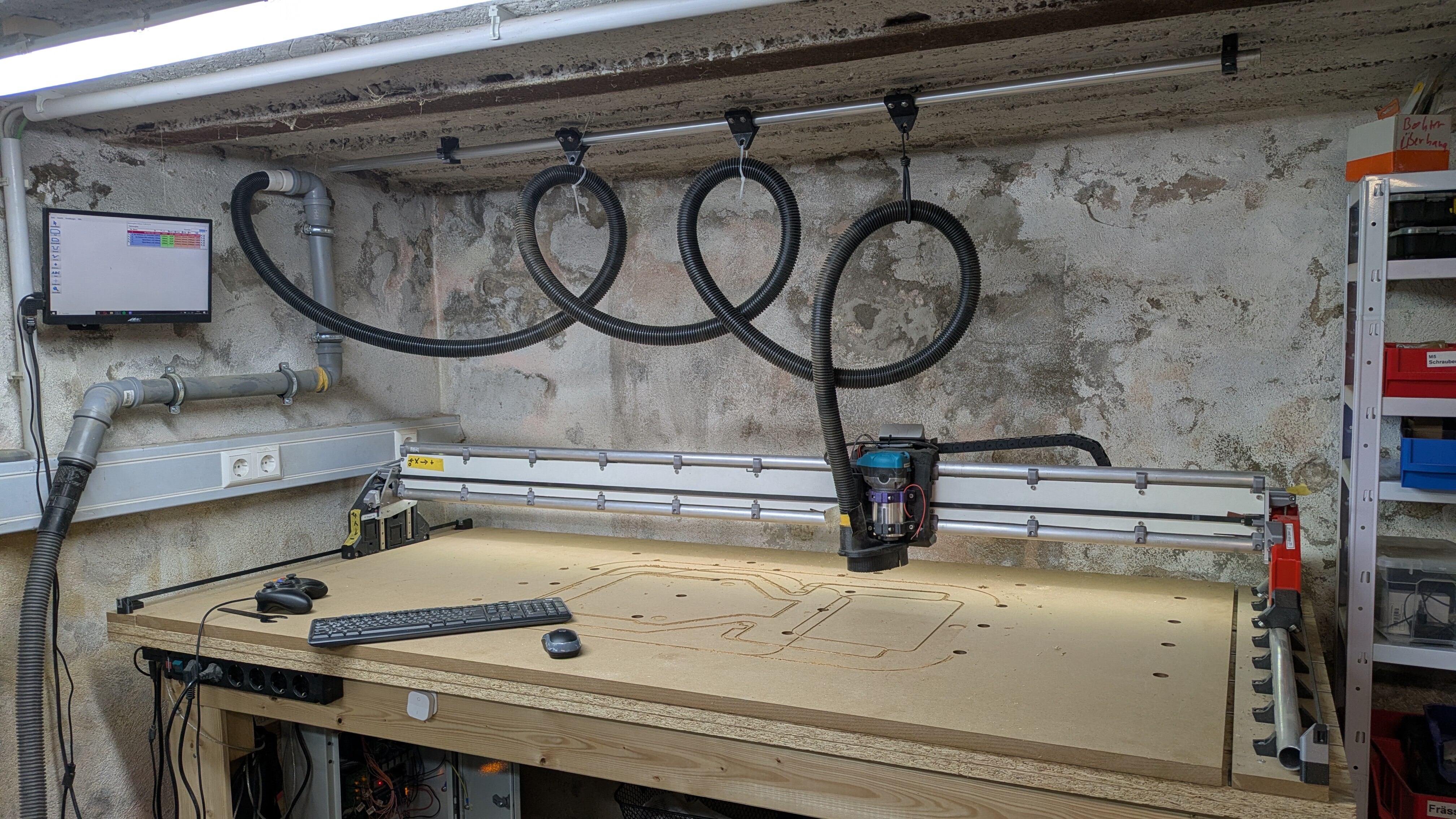

LR4 Karlsruhe - Germany 2m x 1m
Großer Lowrider V4 in der nähe von Karlsruhe
2m X-Achse, 1m Y-Achse
Estelcam mit OpenCNC-2 in separatem Schaltschrank
Energiekette an der X-Achse
Absaugung über Abgehängten Schlauch von der Decke
Angepasster Dust-Shoe für kleineren Schlauchdurchmesser, Spannzangenmutter zugänglich.
Vorher gab es einen LR V3 in der gleichen Größe, mit 1m X-Achse und 2m Y-Achse gebaut, das war aber zum Arbeiten mit meinem Werkstatt-Layout nicht optimal.

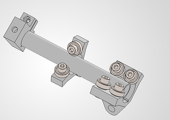

Looks like a great build! I am also interested in the runners for the hose. Did you draw it yourself? For what OD of pipe?
It’s a remix of these runners:
www.printables.com/model/945338-34-conduit-roller
(As a new member, I guess I’m not allowed to post links yet.)

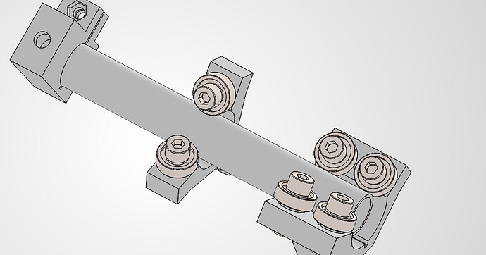

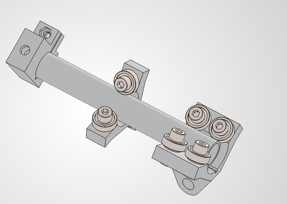

Printables’ one-piece hangers could get stuck if they were pulled too hard in one direction. That’s why my hangers are twice as wide, with a bearing on each side.
The rubber straps used to secure the hose coils are also important to ensure everything works properly.
I’ve designed them in SolidWorks:#

How is the 2 meter axis working? And what length of hose is good? The link in the docs goes to 10 feet.
I’m glad you like the design. I just published the pieces on Printables.
Nice, thanks so much! And it’s even 25mm! I have those rails left from the LR3. :slight_smile:
Yeah, I´ll print 2 of these tomorrow!

The long X-axis works very well for me, especially because I can easily reach the table from the front and use it even when I’m not milling. Stability and speed are higher in this configuration than with the Lowrider 3 with a 1-meter X-axis, which I had set up previously.
Regarding the exhaust hose: You have to experiment with the length of the exhaust hose. Adjusting and changing the diameter of the loops had a major impact on functionality for me.
