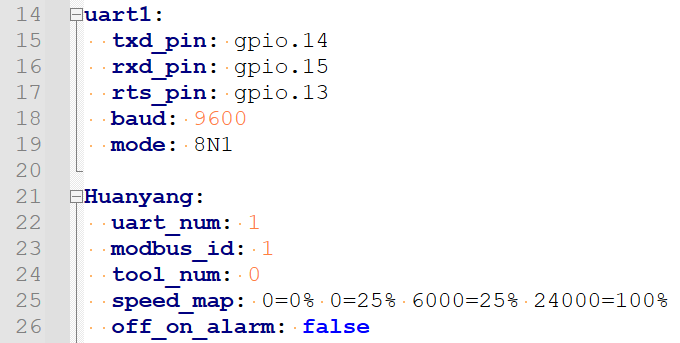

On Notepad++ my UART1 and VFD blocks look like this:

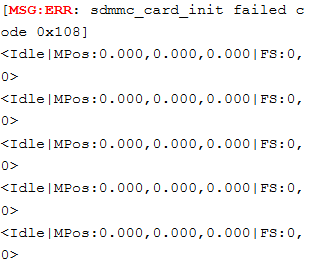

BOOT Log here:

When getting the SD card error, do you have USB connected to the controller? Or is it powered by 24v?

I’m assuming that $SS output is from when you had it connected via the web installer since it shows the TMC drivers as not detected?
Is it disconnected from USB when you’re having these issues? And restarted after disconnecting USB? It won’t initialize properly if it is powered from USB first.
If that’s not it, I would try doing a fresh install from the web installer wiping everything. It’s possible there’s some issue with the flash which that will resolve.
USB being connected with a power+data cable before the Jackpot is powered is a likely source of issues. Another would be a current loop with the spindle interface.
If this isn’t a USB related issue, disconnect the RS-485 module and repeat the assesement of boot reliability.
