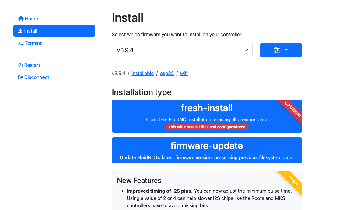

Tried Chrome Version 132.0.6834.160 (Official Build) (arm64) and Edge Browser
After I use the Webinstaller → Install FluidNC → 3.9.4 Processor type esp32 Wroom → wifi → fresh-install I get the info, that the controller now is ready to work. When I click continue the site loads and tells me:
The controller does not seem to have FluidNC installed, do you wish to install it?
Kind regards and thanks for every hint / help

Why can i not see the WiFi-Settings to the left while try to installing fluidnc?

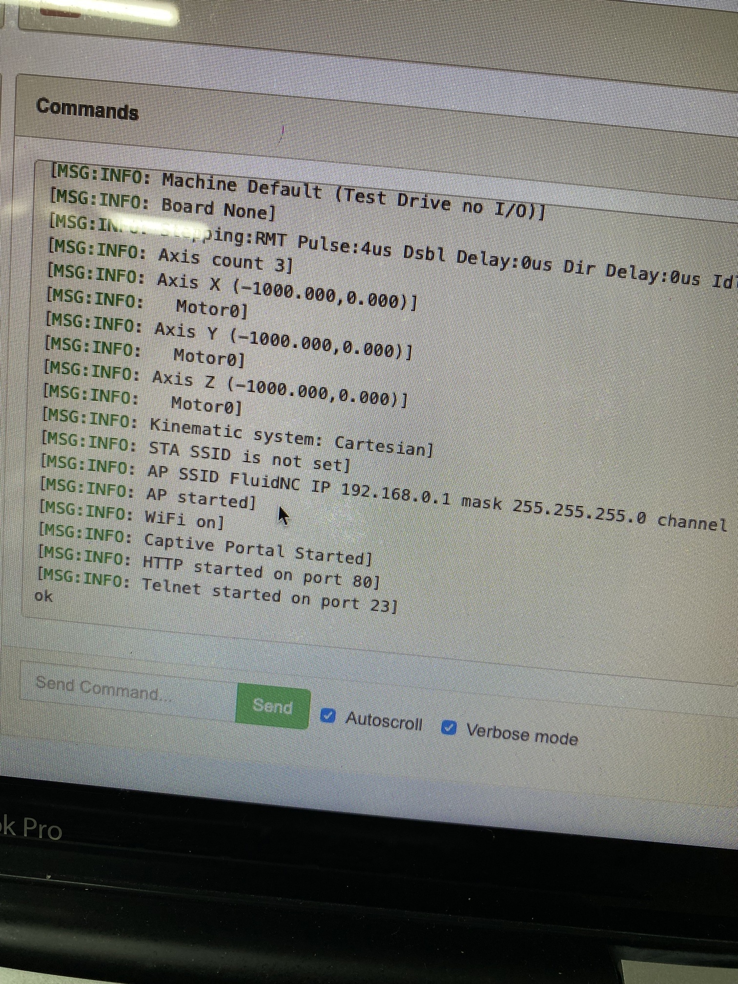

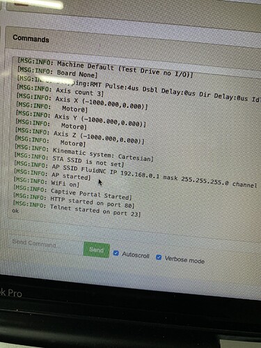

I‘m rubbing my eyes … just connected the ESP to the jackpot - then inserted 24v dc from power supply … power on … checking wifi networks and TADAAAA - there it is …
Thank you so much for this hint. Never mind that the power from usb is not high enough. Fantastic! I will send pictures and Videos when i‘m done! Great! Have a nice day - we see - ahhh read us! Kind regards, Steffe
