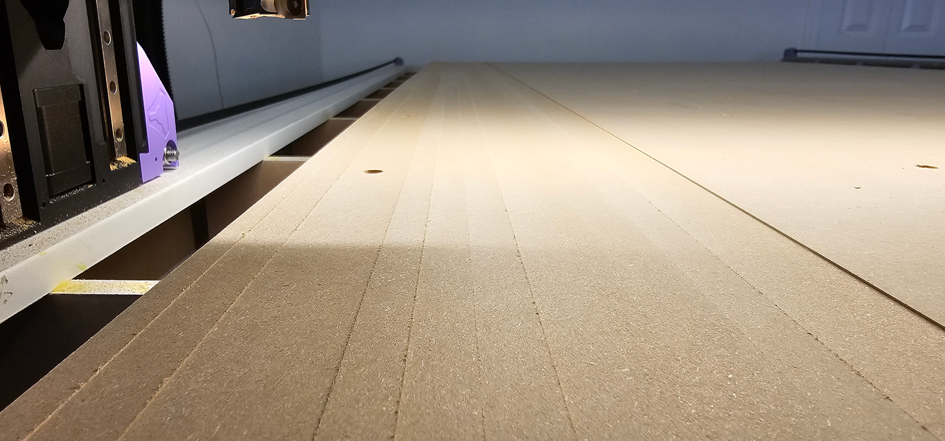

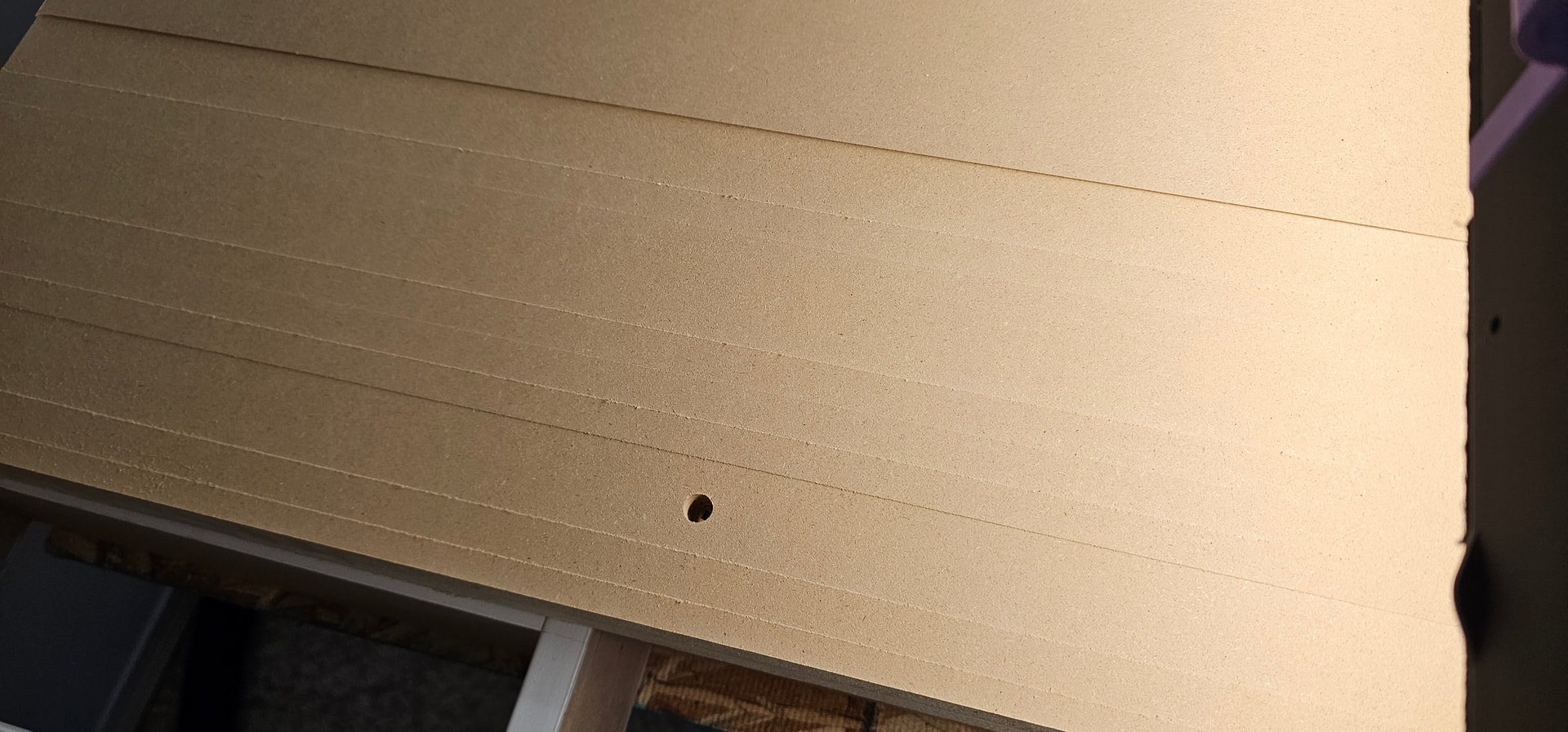

As a specific example, I tried surfacing my spoilboard with a very simple gcode script I put together. I was using a 1-1/4" surfacing bit with a 50mm/min plunge rate. The machine lost Zmin steps with most passes, resulting in stepped zebra striping down the table. Here is a snippet of the gcode I was using:

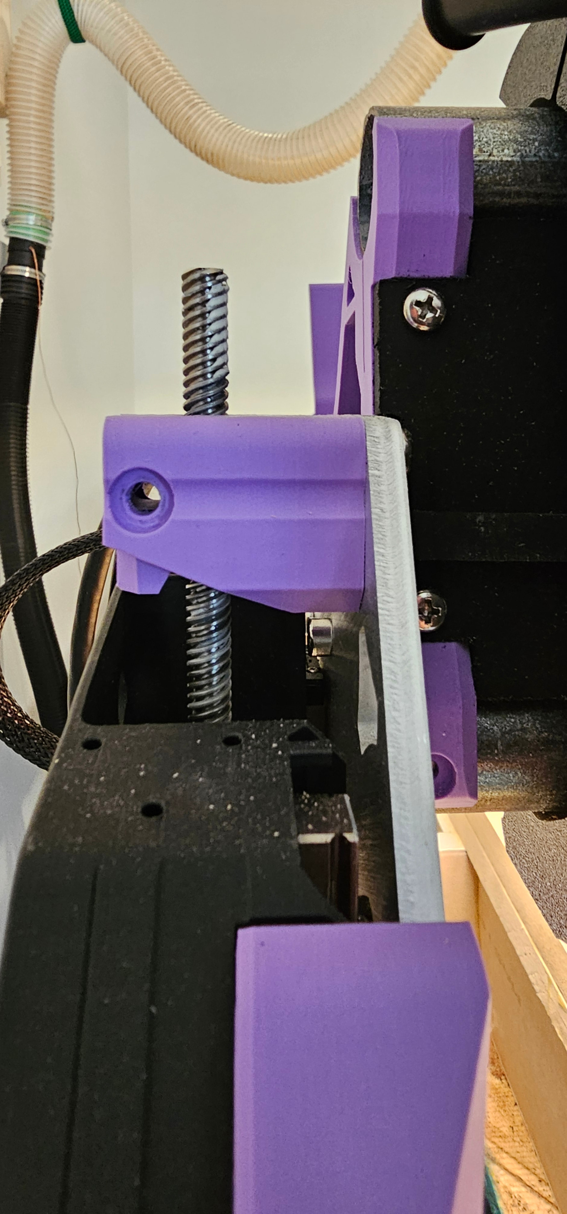

Looks like I can now upload attachments! That was fast. Here are the two gcode scripts I discussed, an export of my FluidNC settings, and some photos:
z_test.gcode (1.6 KB)
surfacing.gcode (5.1 KB)

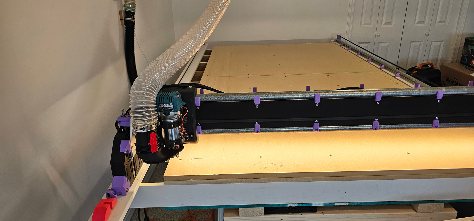

You need to attach that hose to the top of the core with Zip ties through the 2 holes. The hose coming from the celling isn’t the best idea, but at minimum attach it to the core.
I did have it fastened to the core originally, but it ended up putting more strain on the system at the Ymax side of the table.
Despite how it looks in the photo, it’s not actually putting that much force on the dust shoe, so moving it to the gantry is a lower priority

I tried adjusting the z-axis max move rate from 900mm/min to 800 mm/min and the acceleration from 80mm/s2 to 70 mm/s2, then ran the spoilboard surfacing operation again. Still lost steps, though perhaps nominally improved, hard to tell.
Next, I turned up the Z stepper hold and run current over a couple of iterations: first to 850/750 mA, then 900/800 mA, then 1000/900 mA. With each increase, it lost fewer steps while running. On the last try with 1000/900, there was only some barely perceivable striping on the spoilboard from the surfacing operation… I’m not sure that’s actually lost steps though, it may just be because I’m using a wide 1.25" surfacing bit and my router hasn’t been trammed.

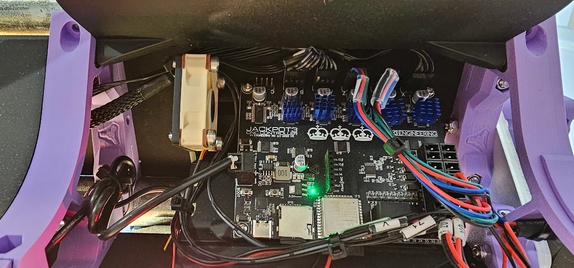

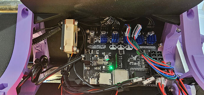

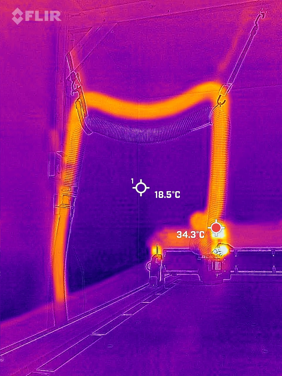

I kept an eye on the stepper motor temps with my thermal camera while I did this. Even at 1A run and 900 mA hold, it settled at 30°C after 45 minutes of running. I have the LR in a fairly cool (~15°C) basement but I’ll keep an eye on it as it warms up, and also as I run jobs with more Z movement.
At the end of the day, it just seems like my Z axis is overloaded compared to other people’s builds for some reason. I’m not too sure why this would be as I didn’t deviate from the standard BOM and there isn’t any noticeable binding of the Z screws, but I’ll keep playing with it and see if it continues to be an issue.
Ps. It’s kind of interesting to see how much heat the dust extraction pulls from the system
When you turn on the suction the hose will get considerably shorter. That is just not a great option. The hose is pretty simple to run along the back and add zero strain to the Core system as designed. On top of that it will work better not trying to lift debris up 4’.
I know if seems pretty minor but I assure you it will affect your cuts.

How did the board temps look? You have a fan on the side, but the v1e case has integrated airflow that should give better cooling if needed. The drivers disapate most of the heat to the board, specifically the bottom copper layer.
Something is fishy here, not exactly convinced you are skipping steps either, typically it would be a pretty large drop and it would get worse each time not better.That picture does not seem to be a big drop, it really could be as simple as the hose is letting off pressure and it is relaxing down.
Ok, you guys have convinced me, I’ll take the time to rework the hose.

Board temps were warm but not alarmingly so, around 38° at the heat sink if memory serves. However that was after 20 minutes of running so it likely wasn’t fully heat soaked. I’ll continue to monitor that as well.
I wish it were that simple. The photo is deceptive because I would let it run a few passes before stopping, adjusting something, re-homing, and and starting again roughly where it left off, which is why it seemed to recover. Each pass in a run was definitely stepped down from the previous.
I did confirm it was losing steps by measuring both Z stubs relative to the YZ assemblies at a set position before and after running some surfacing passes, and each time Zmin dropped 1-2 millimeters compared to where it should have been.

So Noah, maybe adjust your Z rapids in the webui a little lower just to confirm it is not a speed thing. If it is, then you have Z binding of some sort (usually all the way at the bottom)
Let’s see pictures of the two Z-stubs and leadscrew/nut (each side).
