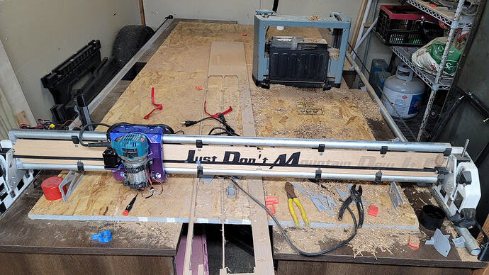

And just think. If you would have slowed down a little bit and taken a shallower cut you might would have had it already :rofl: :rofl: :rofl:

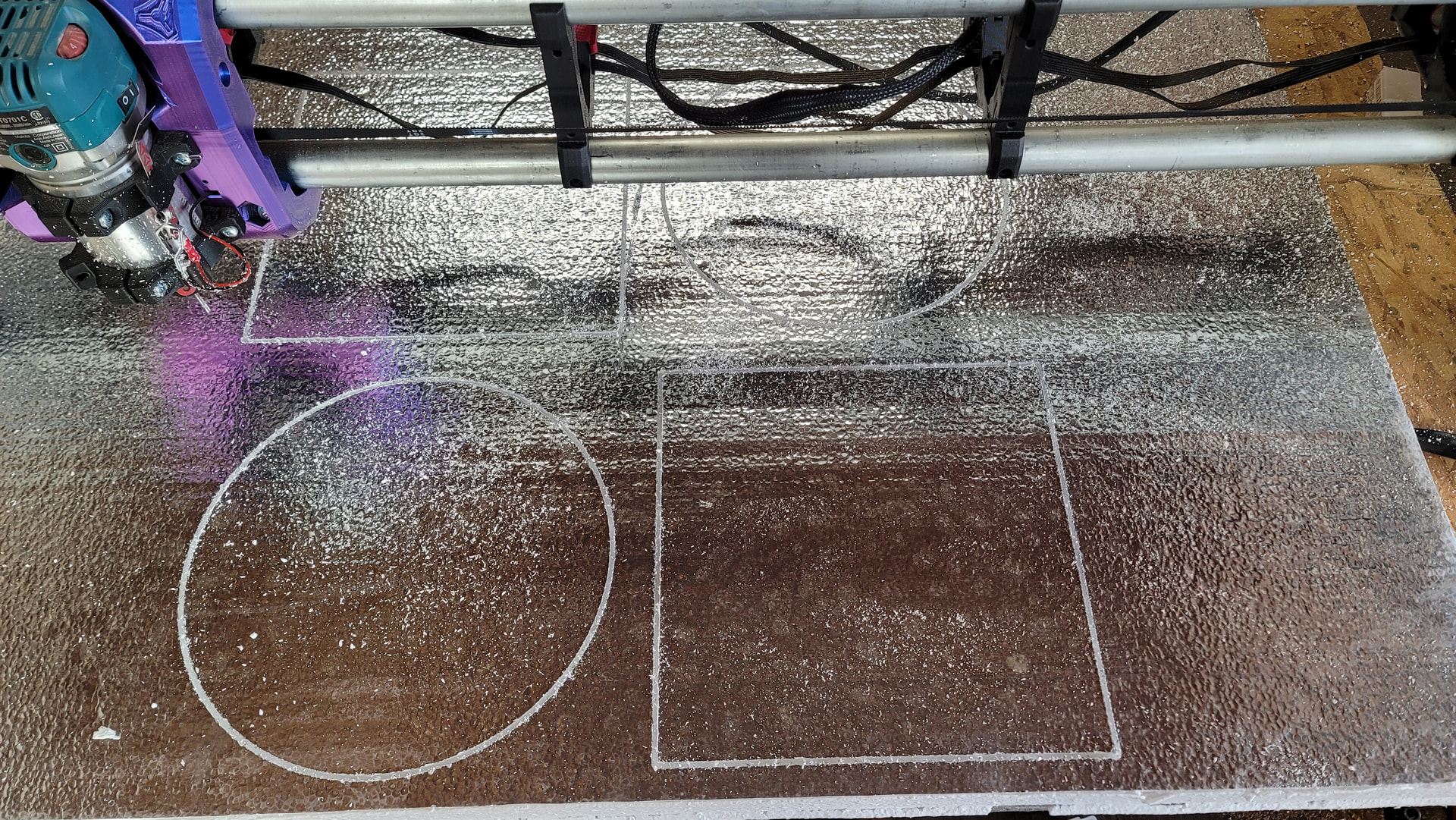

On a serious note, I knew I should of hit stop when pocketing the letters and leaving the little missed lines in the center of the letters and bad finishing passes. But I thought well the screw holes look good and the screws fit nicely. I can always just re cut the struts once the janky ones are on for a better next set.
Also: add a finishing pass at full depth, 0.3mm at least. You want the struts to be an exact fit. :slight_smile:

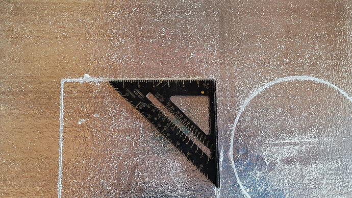

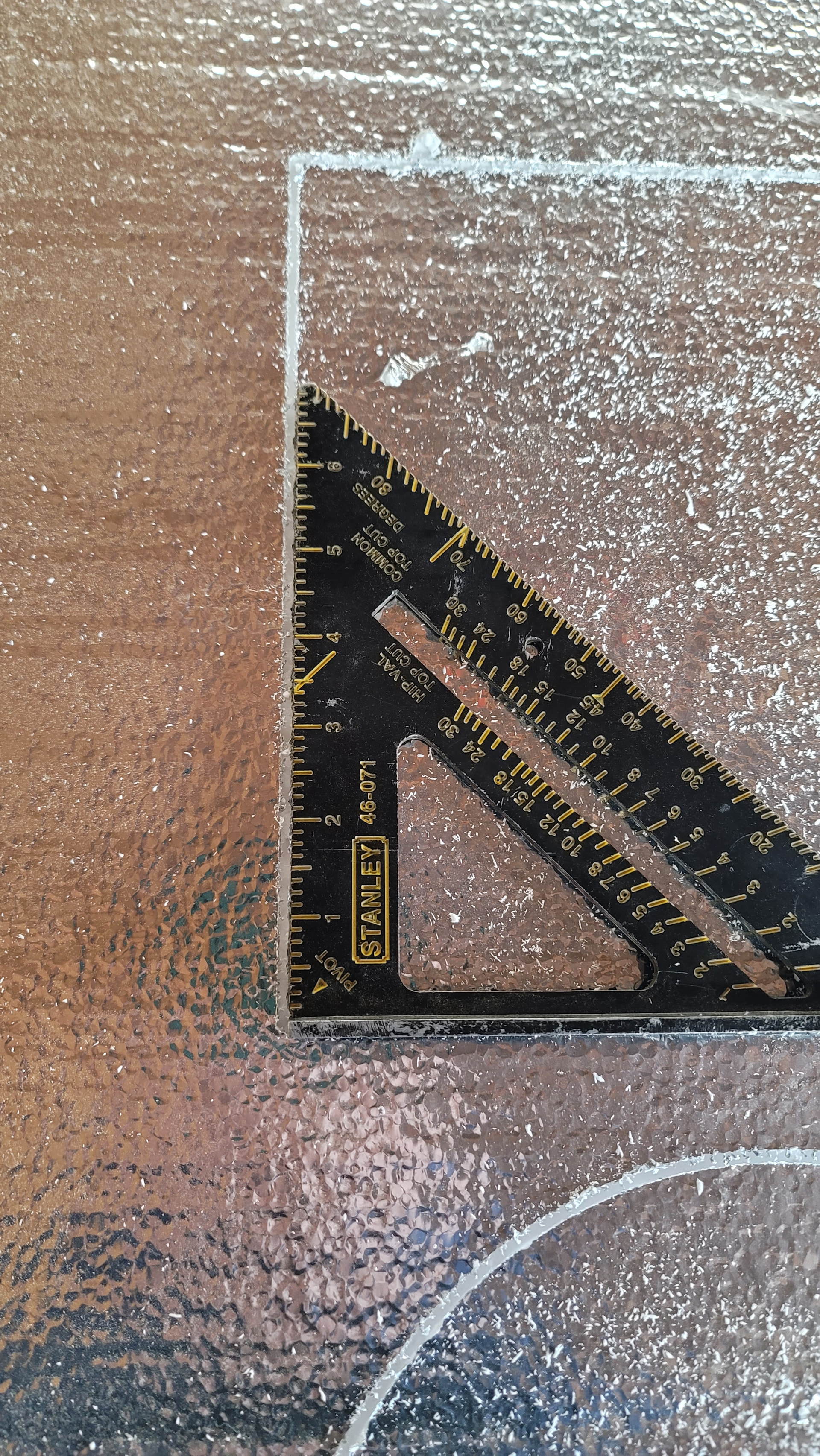

So I wanted to make sure I was square. So I made some 10 inch squares and circles each one was off by .5mm on both X and Y. I think I’m close
Now it’s time to see of I am still square after installing the struts

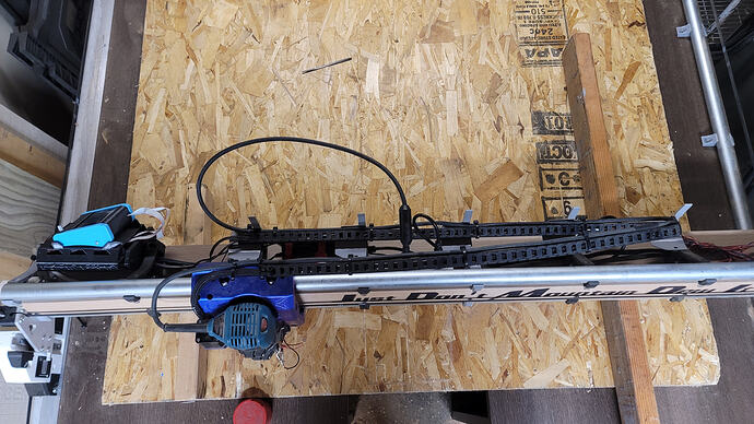

That and print one more brace…oops

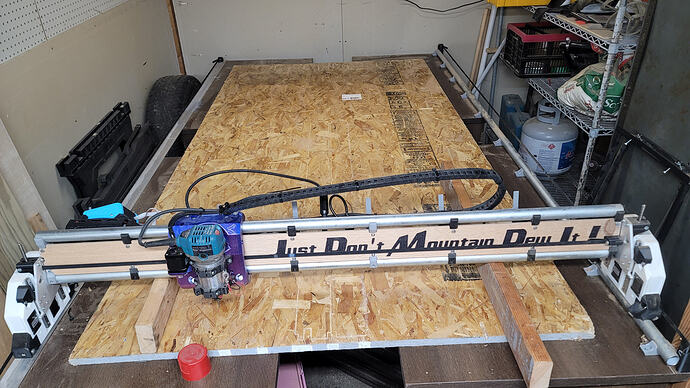

Got all the wiring cleaned up and ziptie and secured. TOMORROW WE CUT!!!

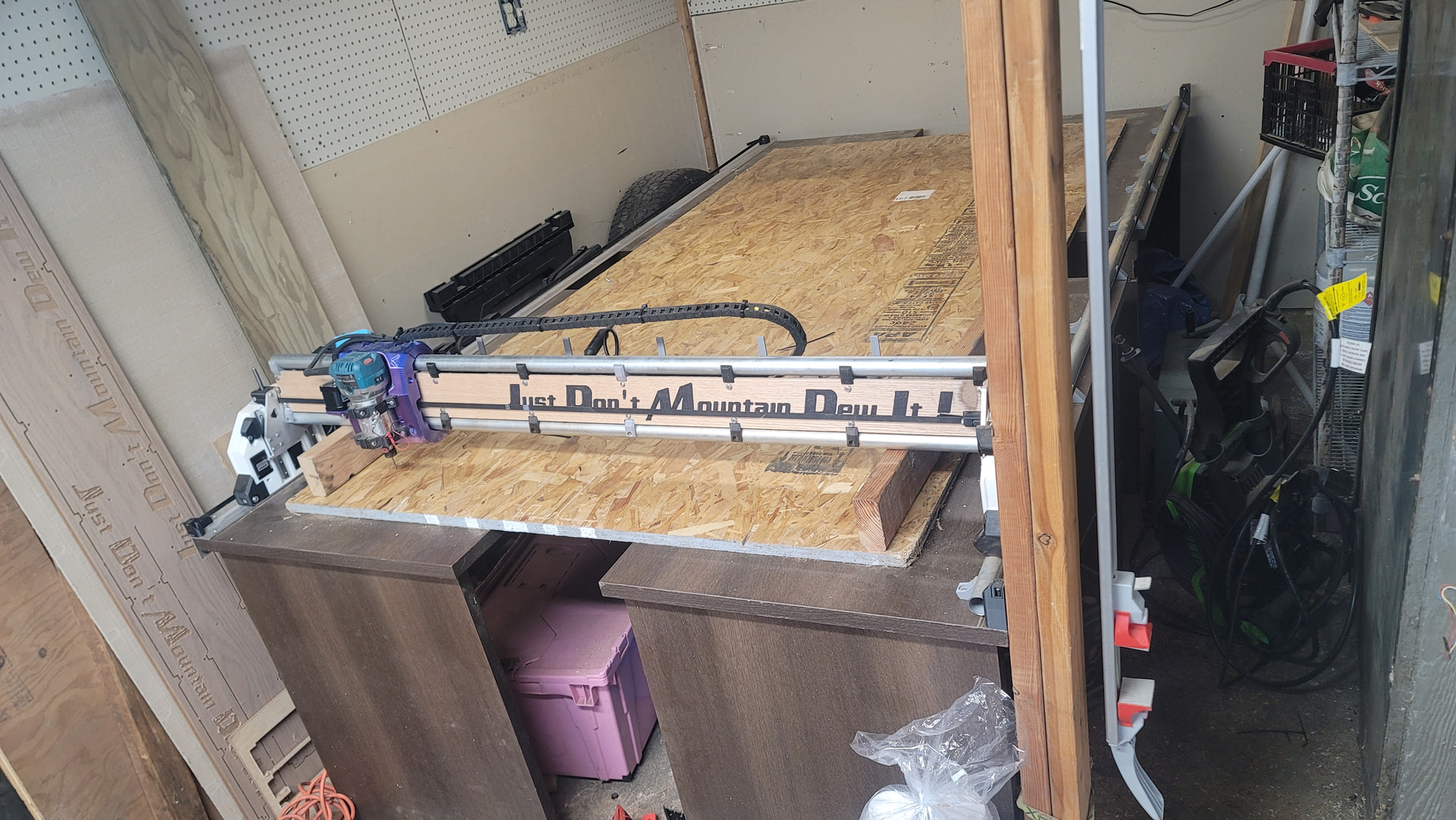

Now that winter is over, the table is cleared and ready for cuts tomorrow!
