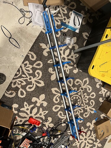

So far, I’ve built the core and both YZ plates. I’m working on the gantry now when I have time. The build is taking longer than I was hoping as my youngest kid is playing basketball and we live in the middle of nowhere and games are hours away. However, I’m still waiting on the Jackpot to come from China so I’ve got some time.
I’ll try to post some pics, especially when I get to making some chips but I’m getting more excited as things are coming together.
Oh, I almost forgot, the build theme is Red White and Blue, #merica! :smiley:
Here are some pics of the build so far. I had to design a new tool holder for my spindle as it’s a wonky 52mm diameter. Luckily someone posted a 55mm diameter one to Printables so I just tweaked that one.

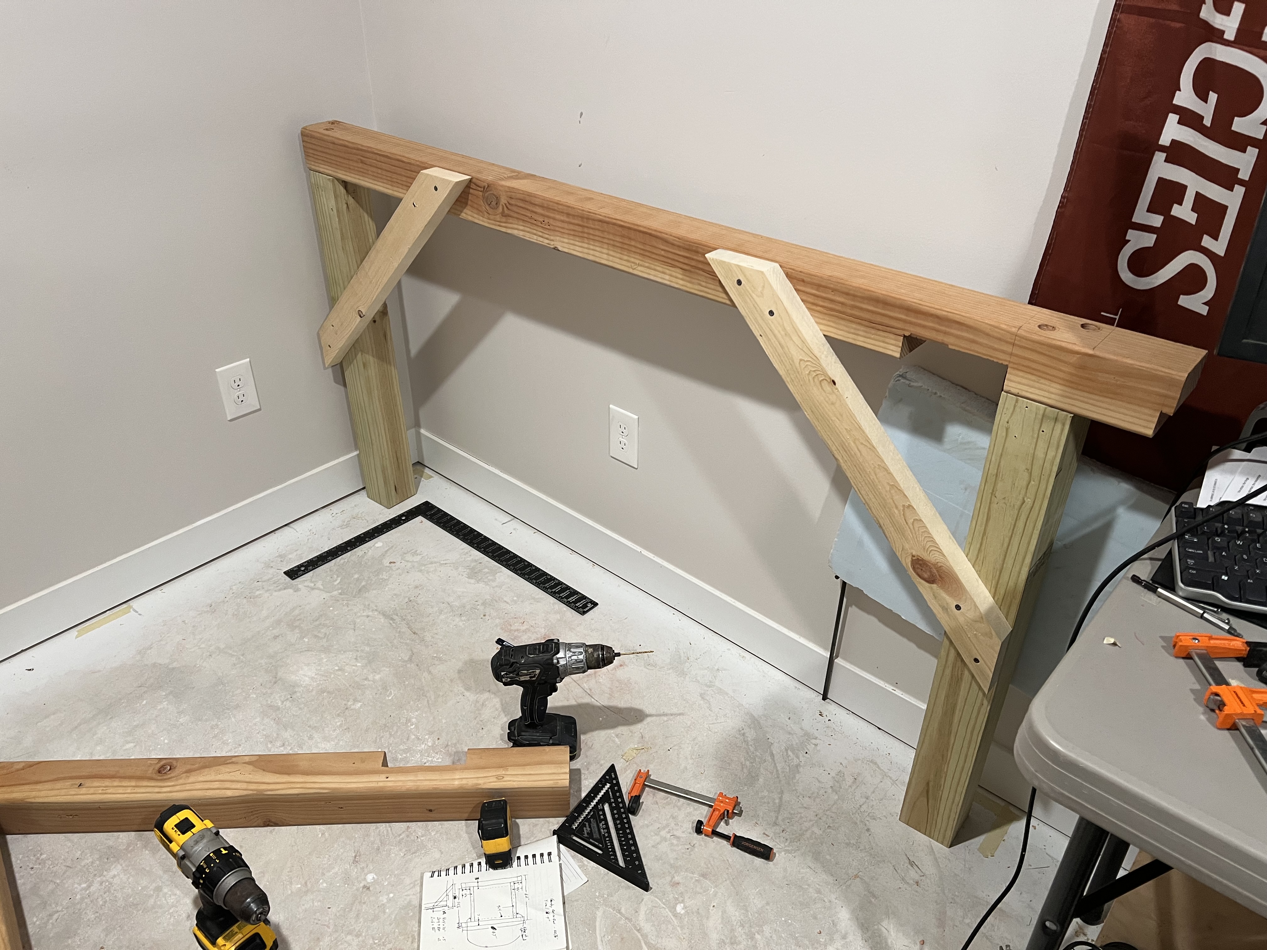

I completed the gantry, mostly. I’m waiting on a few more electronics bits and then I’ll clean up the wiring. I thought I’d shift to building the table. I had to use wood from older projects like my son’s old loft bed but I was able to piece everything together pretty well. It’s bulky but should be pretty stable. One day I’ll build a nice table for it but oh well.
I designed this a little on the larger side so I can put a half sheet of MDF in it with a little room around the outside for wiggle room. I’ve got some threaded inserts for M5 bolts that I’m hoping to use in the spoil board for work holding. We will see how well that goes in practice though.

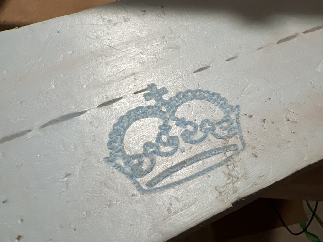

First cut! Just used a v bit going into foam but it worked quite nicely! I might need to try some MDF now :grinning:
Right, I’m having way too much fun with this already! It’s so much more stable than the oversized mpcnc I made a few years ago.
