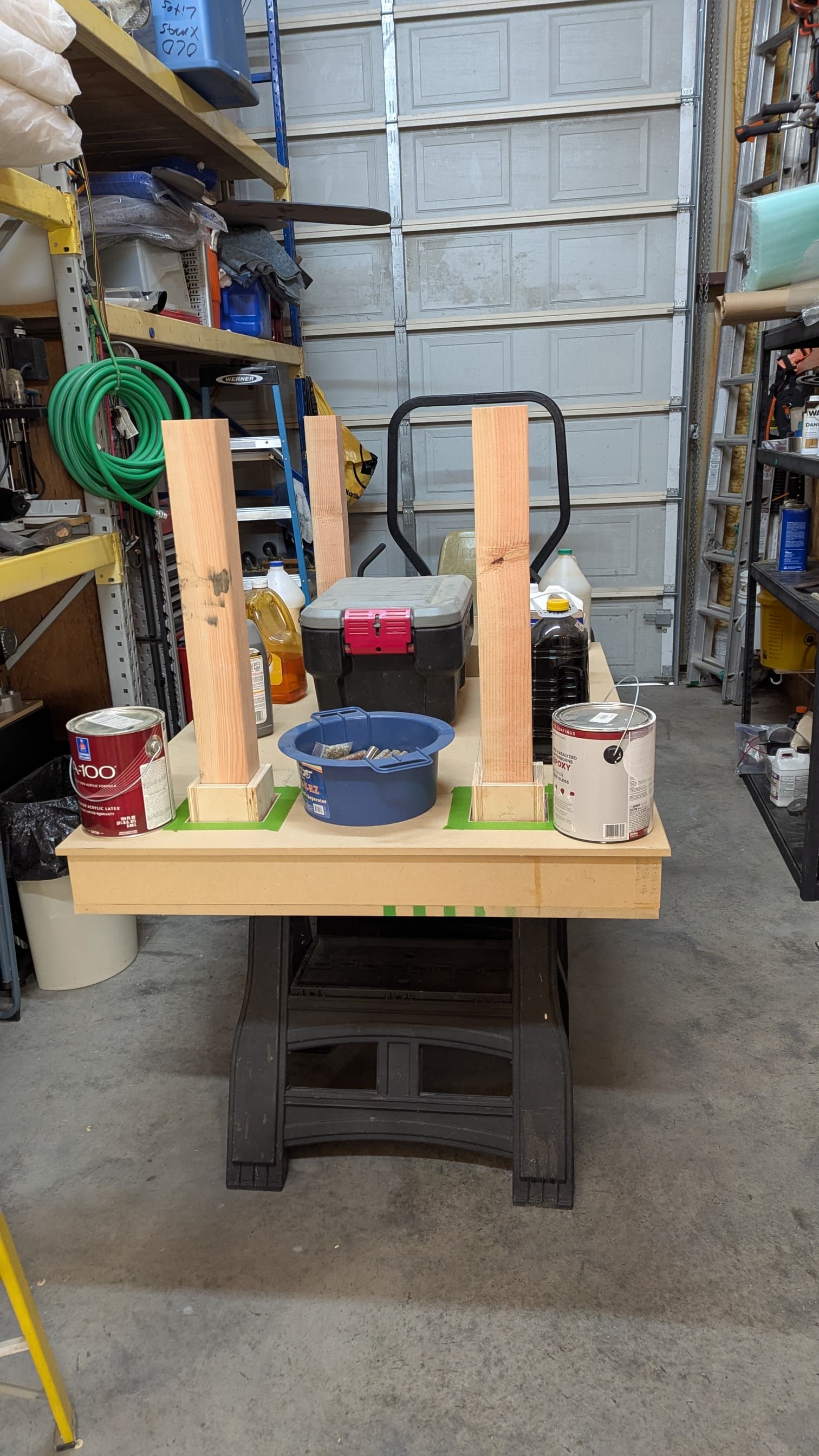

Well I’m well and truly committed now …

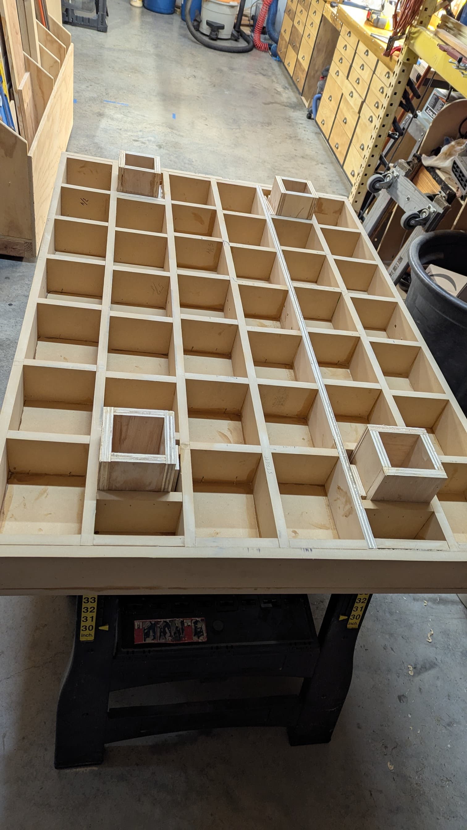

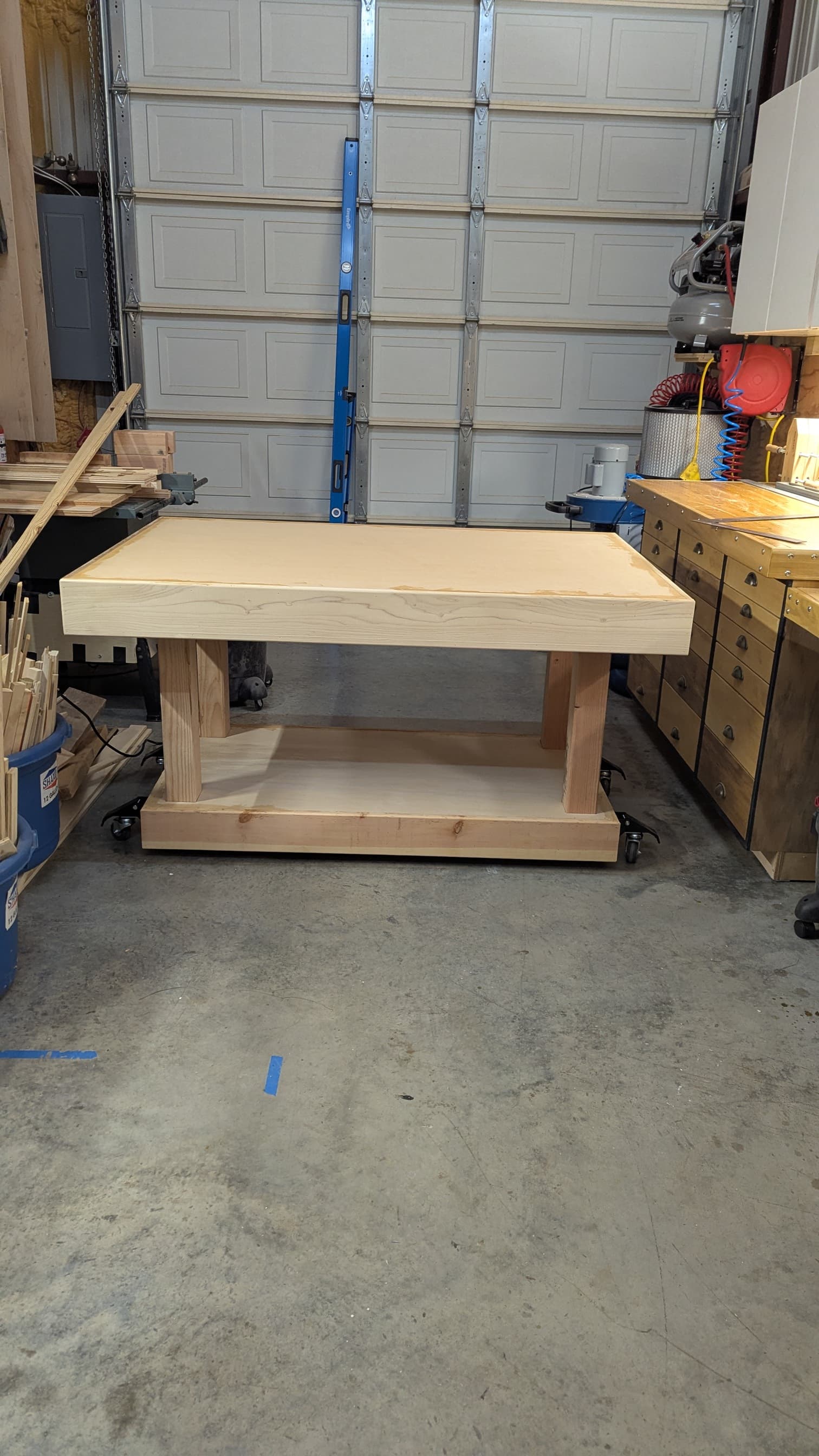

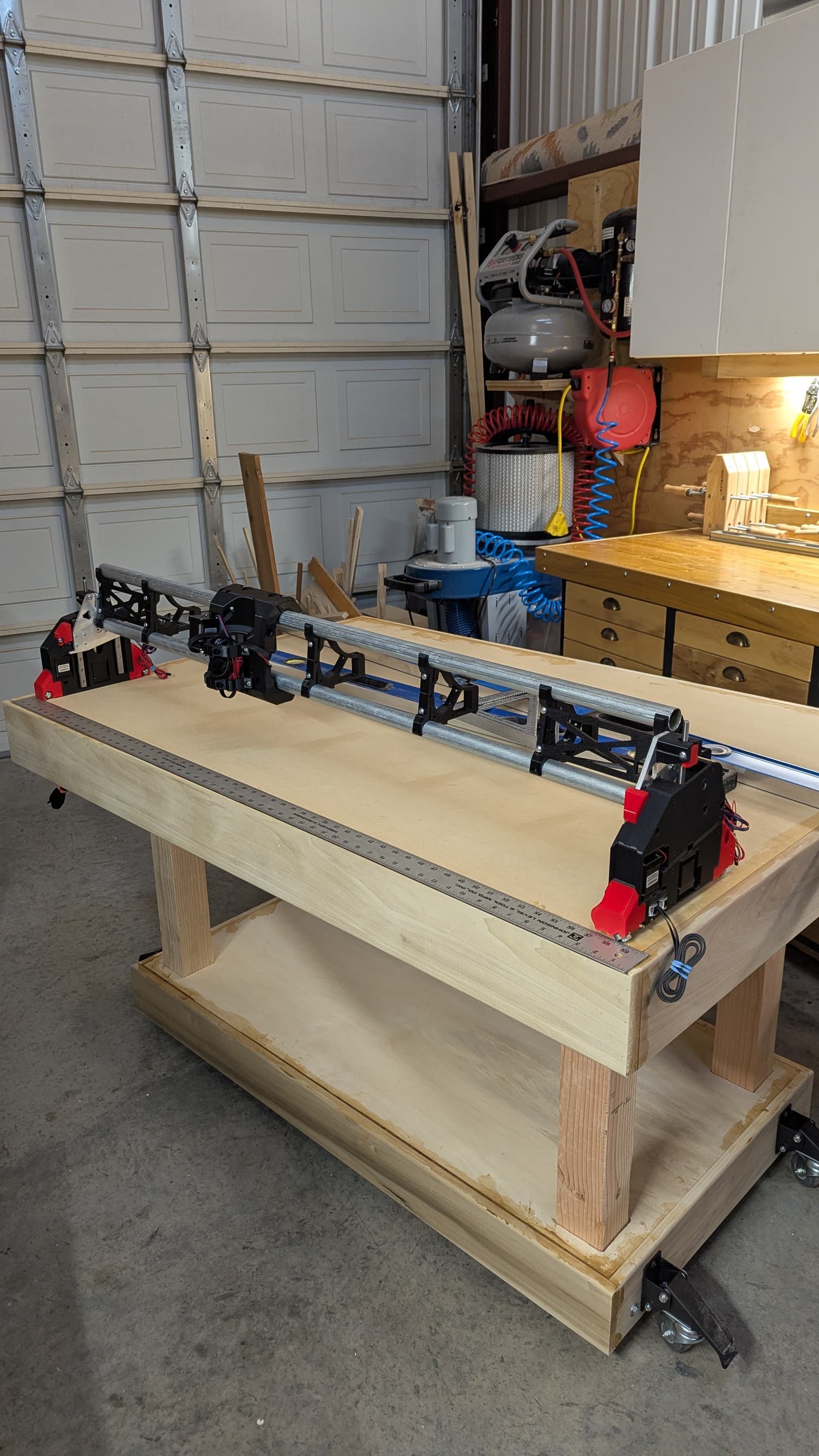

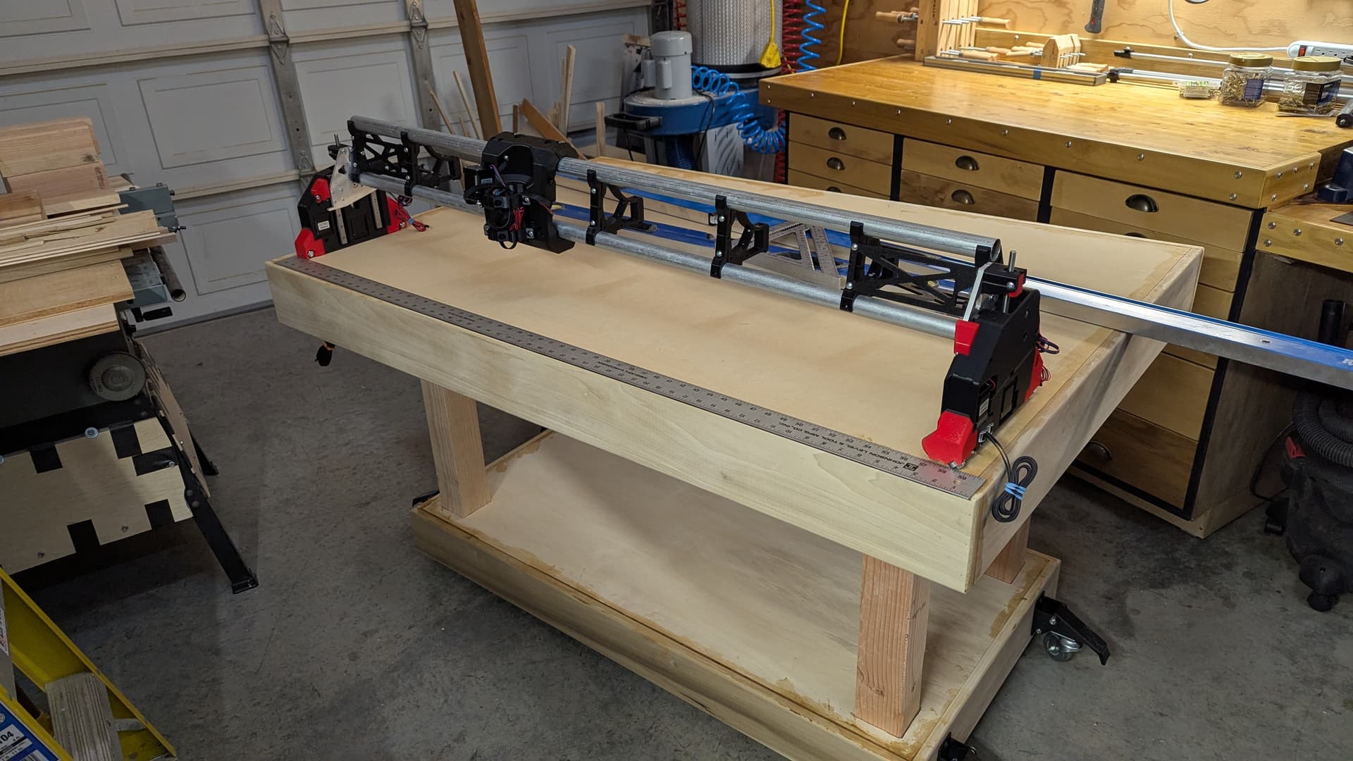

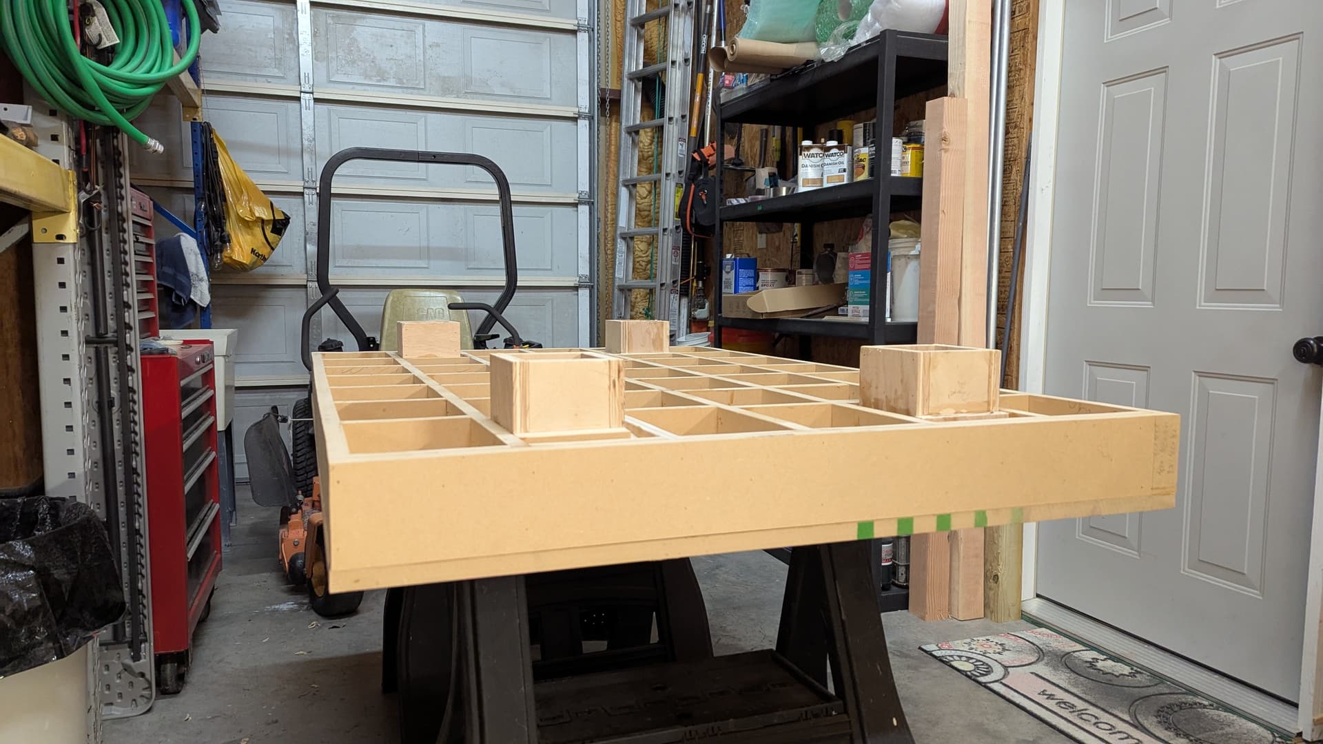

After a bunch of measuring, soul searching and rationalizing my choices (space/time/$$) I chose the LR4 because I believe I can comfortably re-arrange my wood shop to handle a 60"x40" table which will yield an approx working material size of 48"x27".
My goal is to build the largest practical size LR4 I can accommodate in my shop while ‘attempting’ to retain the potential for using it on a full sheet of plywood or other 4x8 material if when needed.
The 48" ‘x’ axis size would allow me to theoretically (via some yet to be determined means) accommodate 4x8 sheet material sometime in the future.
A secondary goal is to be able to utilize the table I’m building to provide a nice flat assembly/work surface with built in hold down clamps (via “t” track).
I know this will require the Y axis belt terminations to be made easily connected/disconnected (I’m assuming this has been done successfully… ??)
Anyway … here a few pics of the current state of things. I think I’m about ready for wiring but still need to double check some preliminary post build measurements.

Making great progress so far.

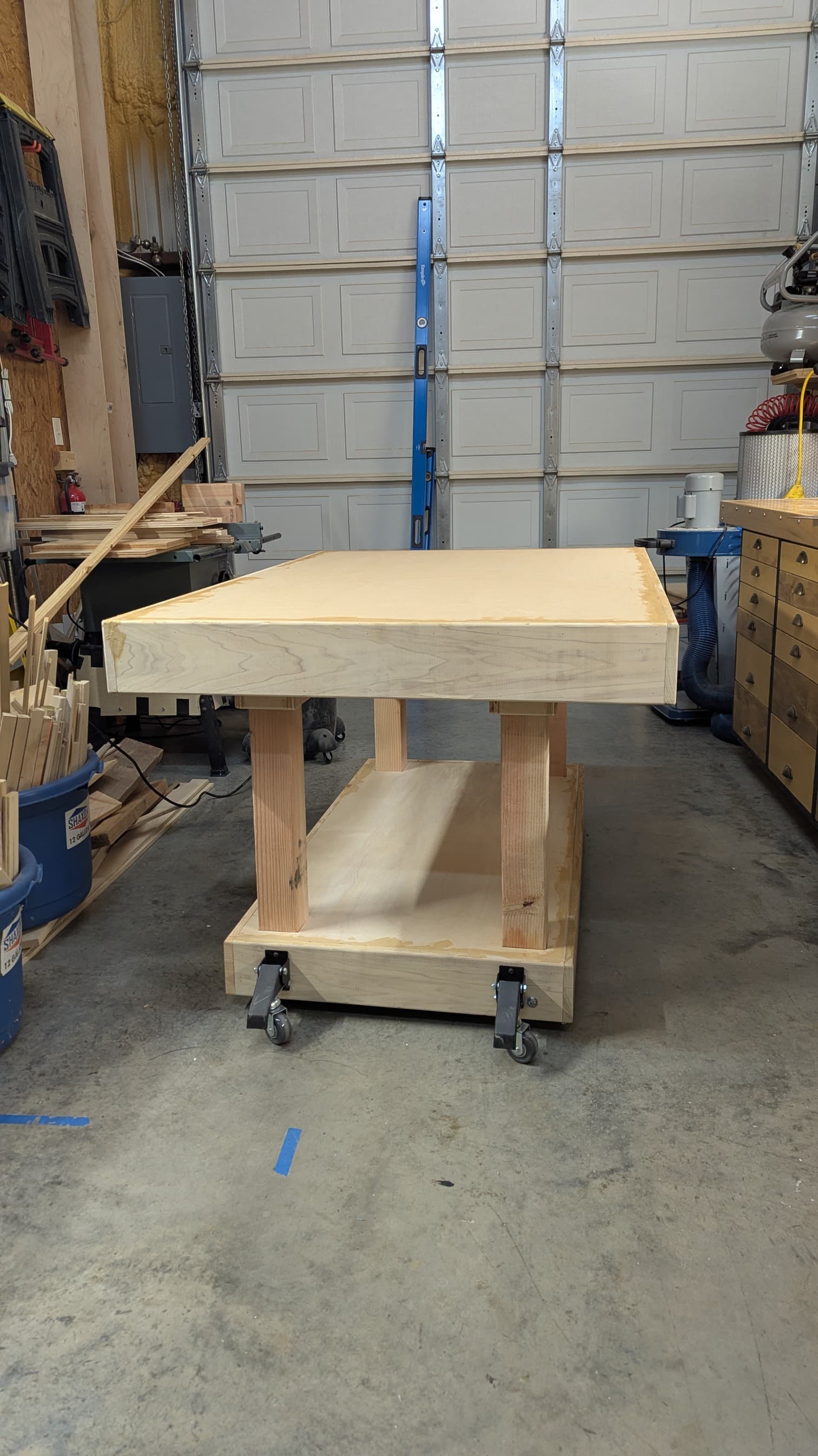

What type of fold down caster mount are you using?
The unconventional X axis being the long axis will cause a bit of workaround but it does preserve the chance to go to a bigger table. Maybe even have a temporary table that you put out for large sheet work (can be as simple as flat goods on the floor!)
Then swap back to the smaller table for everyday use.
It’ll be interesting to follow along your build.
The casters came from Rockler wood working store / shop. Those were purchased more than a year ago for another project but not used… I’m pretty sure they are still available.
I didn’t use them originally because they are a bit unsightly and a potential ankle biter when not in use. Also they were a bit pricey (Rockler is a $$$ store in my mind) but probably available elsewhere at lower cost.
Functionally they are great … if interested look for another type that is very similar in design but incorporates a bracket that mounts to the table (like these at half the cost) which the lever and wheel connect to for use. If I hadn’t already had these that’s what I’d use here. In this case the table will be up against the wall most the time and the top overhangs the bottom which will minimize the likelihood of the casters interfering with something being placed next to the table at floor level… and if it bugs me it’s just 2 large wood screws to remove them.

If you keep the machine orientation so that the linear rails on the table are Y and the gantry is X, then you’ll have far fewer issuse compared to you trying to make the long axis Y.
I think you’ve built a machine that will give you a lot of flexibility and which can support larger materials when needed.
The tale of woa would be if you insisted on making the long axis Y for this setup. If you don’t do that, then I expect everything will be fine for you.
