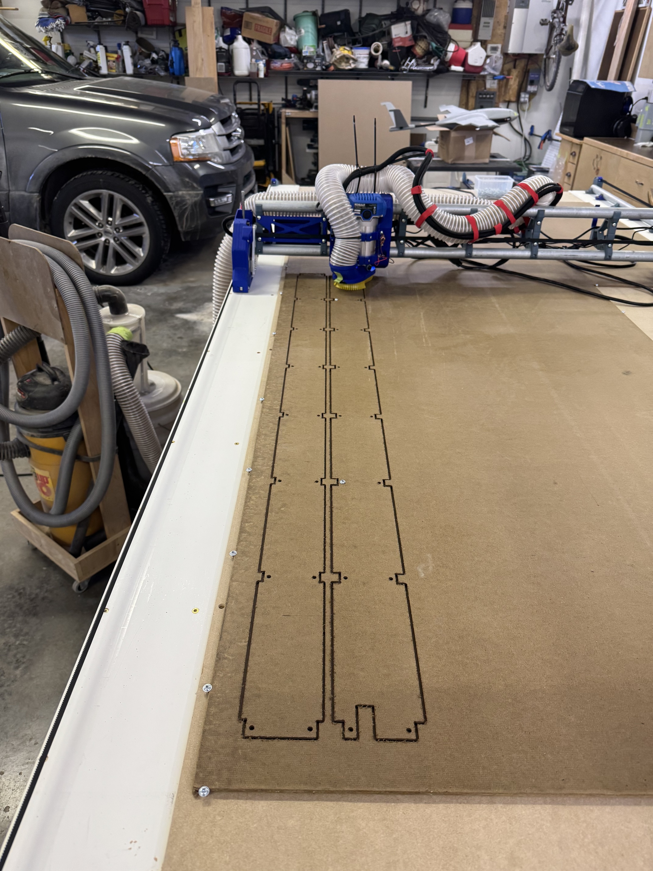

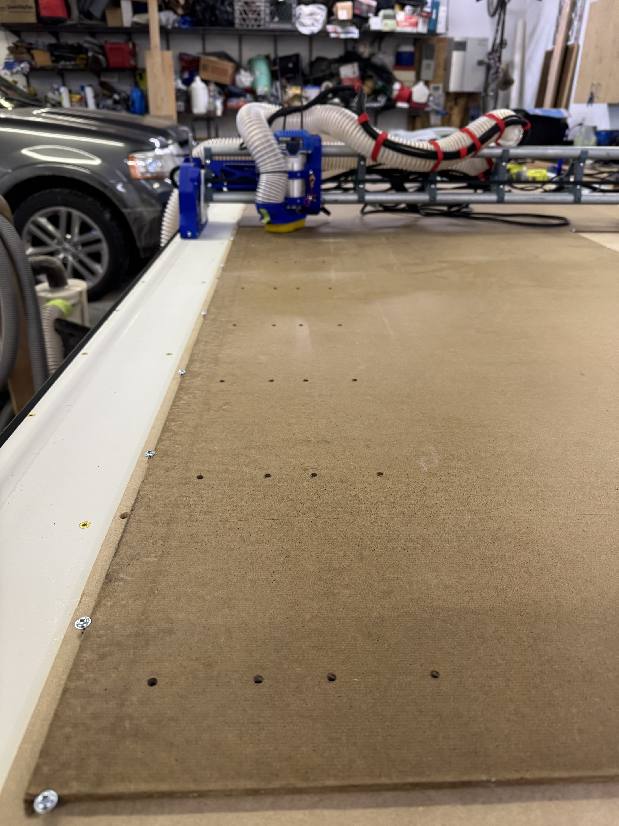

Wanted to chronicle my build for others however health issues didn’t allow the time. I did mange to make my first cuts today. The strut plates came out perfect! I’ve held out for years on 3D printing, CNC router, CNC plasma cutter mainly because software always has me scratching my head. I always knew it was something I could learn just never decided to put my time into it. Without the community here on the forum it would have been much harder and more costly to get to my first cut.
I still have to tidy up the wiring and dust hose and check the square and tram. I decide I would get the machine true after I installed the strut plates.
Definitely want to thank Ryan, beta testers and community members for a great machine!

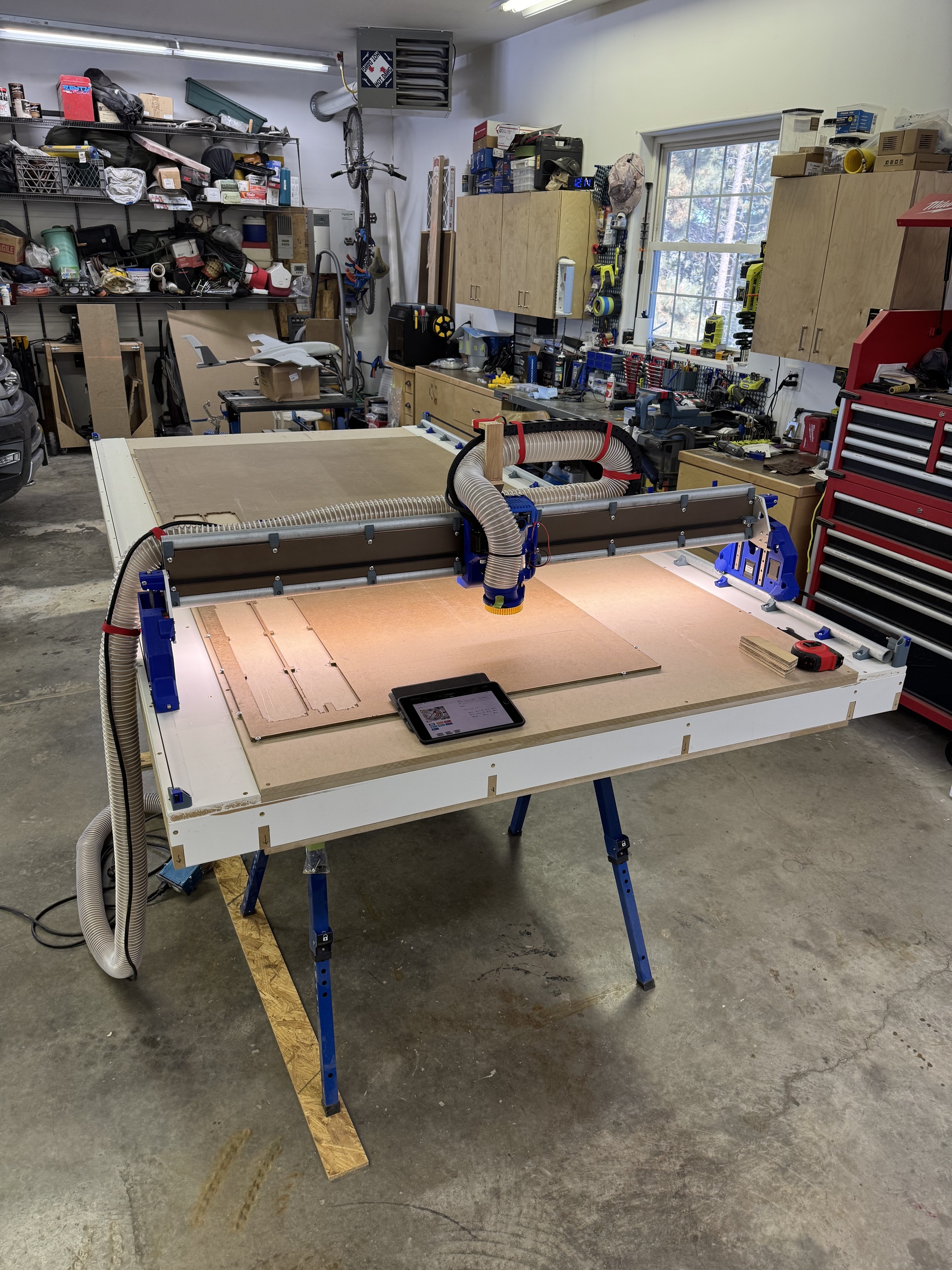

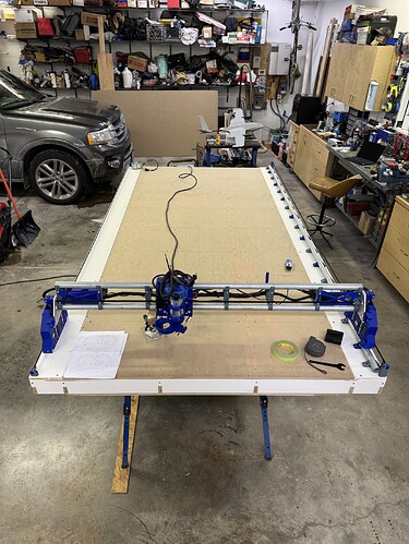

Well I have my LR4 complete. I made a redneck prototype drag chain mount to test and it seems to work well. Now I’ll check square and tram and we should be ready to make some cuts.

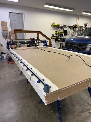

Looks like my build came out square. I checked it today and measuring diagonals X=1200 & Y=2550 it was only 1MM difference!

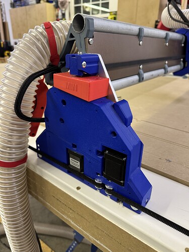

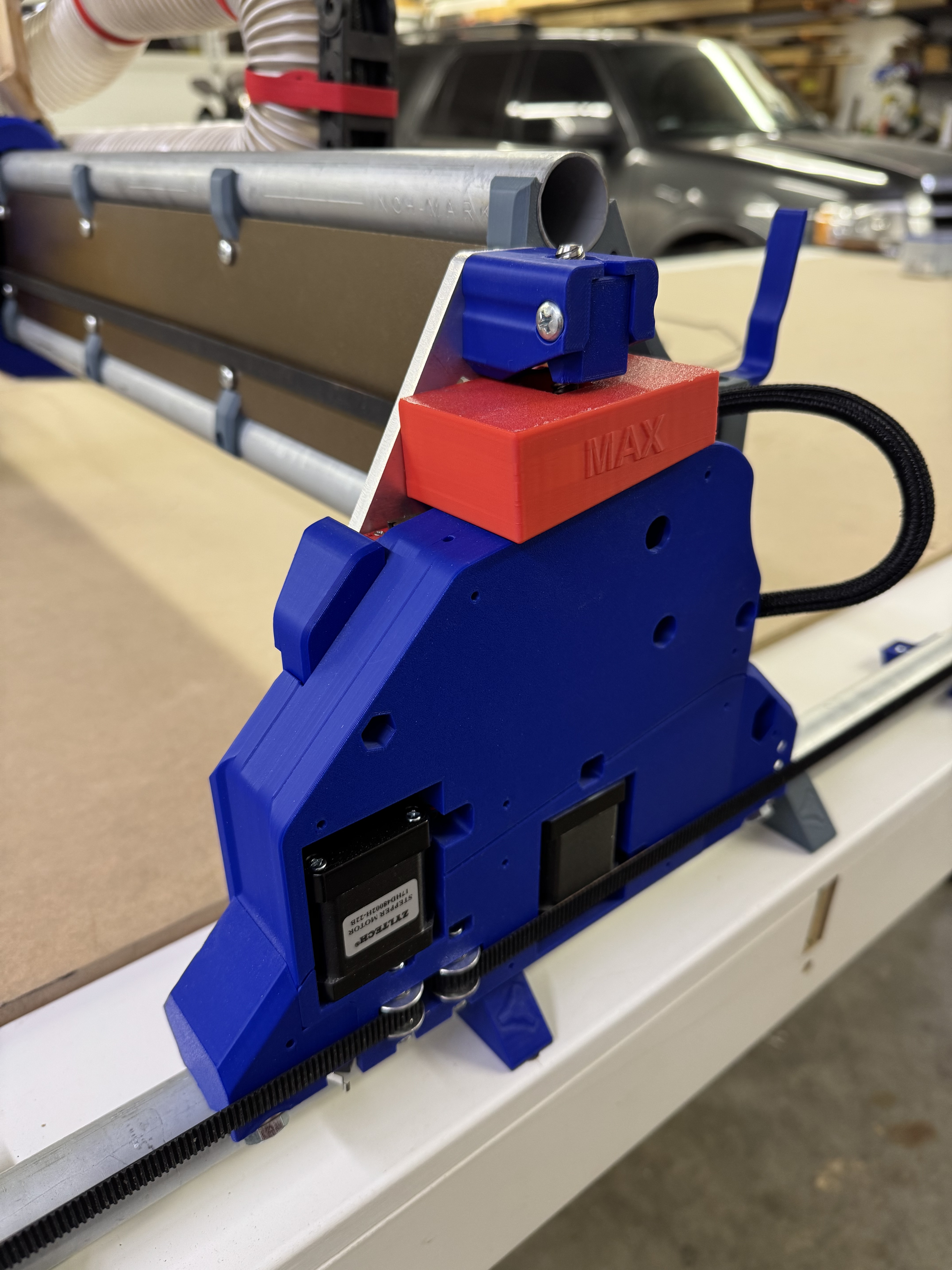

When I posted those pics I forgot to mention the Z blocks to hold the gantry up. I found the file on Printables and they work great. I know a lot of people have complained about the Z drop when powering down. If I knew how to post the link I would share it.
Go to the site, click the browser’s address line, ctrl+a, ctrl+c, switch to forum, ctrl+v. :slightly_smiling_face:
Thanx for the tip!:call_me_hand:
I designed those Z-blocks. Glad to see them getting good use. Just get into habit of homing Z after turning machine on then IMMEDIATELY pull the blocks. Don’t ask me how I know that LOL. :stuck_out_tongue_closed_eyes:
