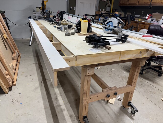

Today was fun. Finalizing the table, I realize that the rail side outriggers were too long and the non-rail side outriggers were too short. Easy enough fix, I doubled up the ply outriggers at the proper length on both sides.
Utilizing the 49 x 97“ MDF spoil board and using Doug‘s parametric table layout on the non-rail side gap of 3 1/2 and the rail side gap of 1-1/2”
Once all adjusted, I boxed in my rail guides.
Looking sharp!
Yes”, I thought to myself "you just have to turn the table around" :crazy_face: :crazy_face:
That was my first thought but it was also wrong. :grin:
The short side was too short and the long side was too long. Not sure what the heck I was smokin’ when I drew this all out… but at the time, I was wiling to bet my wife’s paycheck that it was perfect. So simple and I know I make it harder than it needs to be… but that’s how I roll
Preview of the short side…
I plan on using 1/2” MDF spoil board and also plan on using 1/2” MDF to shim up under Y rails so the rail is just a bit above the 1/2 spoil, but will also be within 1/4 if I decided I need to use 3/4” MDF spoil.
Probably just unnecessarily complicated it some more. :joy:
