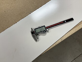

I had some 3.25mm melamine backing laying around from prior cabinet build so I used that to test the files on the Primo. I was very happy with the results…
I suppose 1/4” material would be better but maybe this will work just fine.

48-in x 96-in Smooth White Hardboard Marker Board Wall Panel from Lowes is what I used as a back to some kitchen cabinets I made our son. So, it is not really MDF, it is that tempered hardboard stuff with smooth white melamine on one side. I’m just going to install the strut plates as is. I’m sure it will hold up fine since there was no issues using as is in a kitchen that gets a ton of use in terms of temperature and humidity. :slight_smile:

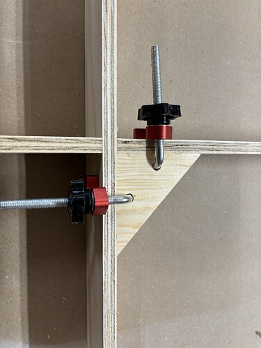

I started gluing up the table ribs. Broke a couple which didn’t need to happen. The work table i use to build cabinets on when I tapped the ribs into the slots, there was too much vibration, long story short, hammering or tapping them into place was NO BUENO. I wish I had figured it out sooner (before rather than after I broke a second rib), that I only needed to gently press them into each other with clamp. It was soooooo easy to get the last long rib in I laughed at myself for aggravating over the others. :slight_smile:
Those little corner clamps worked great and when I check the overall grid for square, it was within a 1/32 so… happy so far.

Moving back to the table, i began installing the 90* triangle blocks which the threaded inserts will sit in. 28 of these suckers. LOL. I love overkill.
I am building the entire grid without fasteners, just glue and clamps. The top & bottom hardboard will be glued and likely brad nailed albeit to a thin 1/2” ply edge. Probably better off using lots of glue and weights :grin:
These will also keep the grid sturdy and square.
