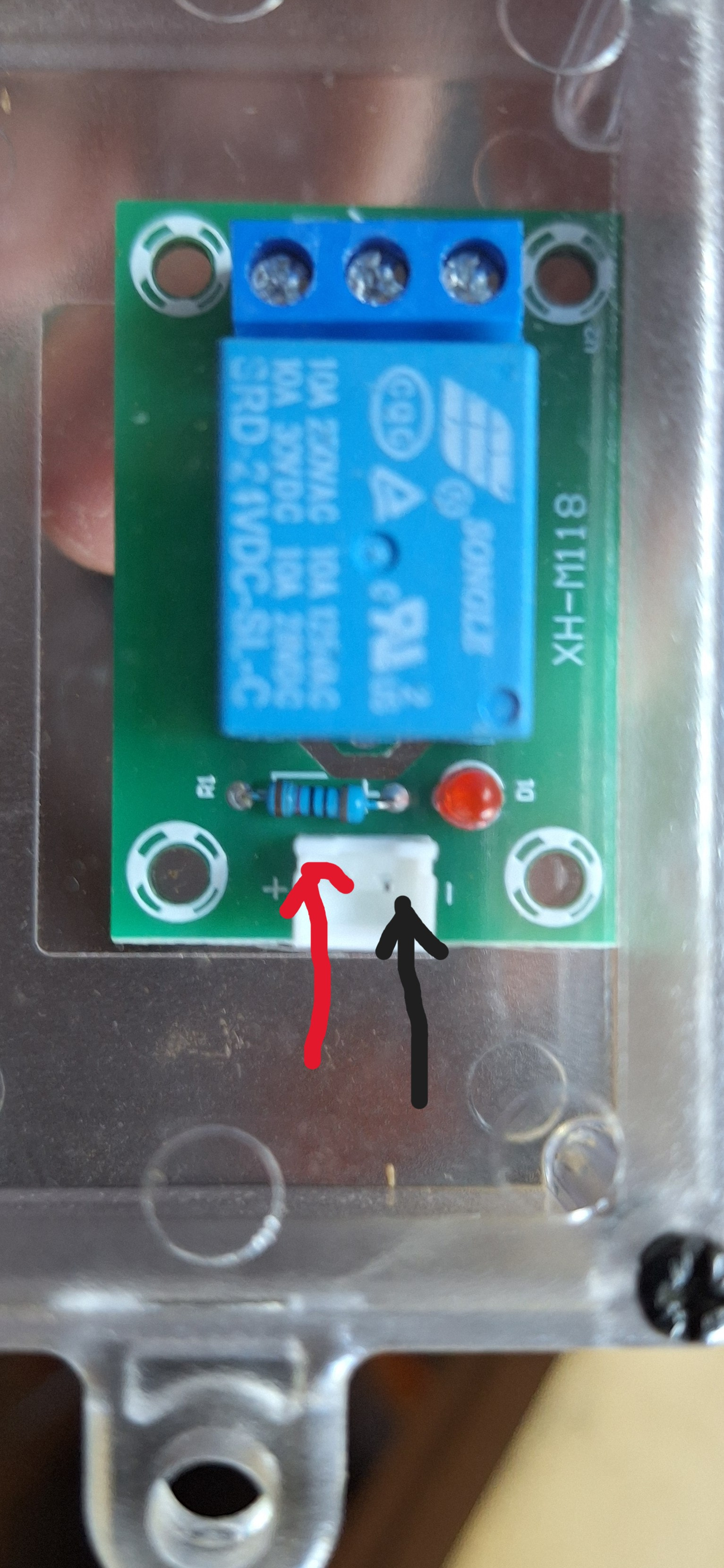

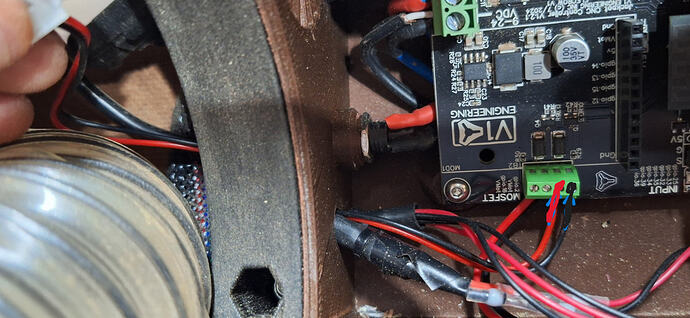

The controller may be switching the negative rather than the positive side of the circuit.
Thanks Tom. I believe you are correct baed on some scratcbing around i have done. However, not being an electronics person, I battle to fully grasp what i read. One thing I did find that could possibly resolve my issue is setting the output circuit to simple on/off via the configurafion file. At leazt this what i understood but could be totally wrong. I was hoping to find a simple step by step how to for dummies.
Had an identical situation using gpio16 to power a fan via a buck module. After changing the fan with an exact new one, all worked as expected. Have no idea what i did electronically but it worked. Now i am having the same problem trying to switch the relay.
Any assistance for this dummy would be greatly appreciated.
Jackpot V1 and V3 are low side switched.
Your loads have to be hooked up so that the + and - go to the jackpot output. You can’t hook up jackpot + only and then tie your load’s - to the power supply or some other ground. That won’t work. (because on the jackpot the outputs + signals are always hot, it’s only the - that gets turned on or off)
Your loads also have to be compatible with low side switching, which most stuff is when you hook up both + and - to the jackpot output.
To be sure about any given circuit, tell us what you’re trying to do and be specific, then we can help you.

Hi Maker Jim.
Makes perfect sense to me.
I believe i have connected as described. In other words I have connected the + and - from the jackpot board to the + and - of the relay module.
See photos below.
Currently disconnected but when connected, relay module does not switch with GPIO 2 switching.
Jackpot connection
Relay module and connection
