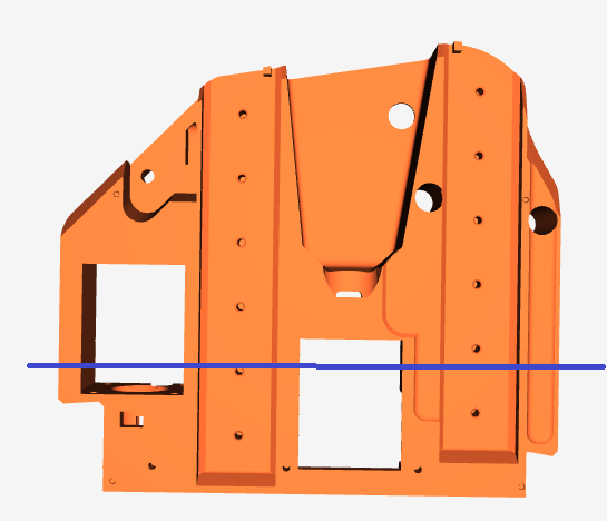

Long story short though: The closed loop stepper does an amazing job and is soooo quiet, it’s incredible. I am going to miss it moving at 16k though (and I only had it for 10 minutes or so… :D), it just looks so awesome to see it switch positions during a cut at blazing speed. If I had a wish for a LR4 improvement it would be that Y and Z each get 20mm more space for the stepper motors so we could run closed loop on all axis (granted, cables would not be hidden any more, too many cables). I’d gladly pay 60€ per stepper/driver combo instead of 25€ as a premium version (we did talk about a “prem” LR before, didn’t we?? :P).
Here’s my proposal, cut the y plates long this line:
glue in something 20mm thick and call it a day.
This guy here is trying to wake up Ryan
Not terribly dissimilar from my hacky first attempt at this. A more nuanced review led me to ask some questions like “Do the hidden wire channels really need to be there if I can’t fit all the wiring / electronics I need for CL steppers in the plate?”
We’ll see whether or not I try something. I like to experiment, but I really don’t like to lead people astray.
80% of the benefit from CL steppers on LR4 would be in X, in my opinion, and that’s an easier mod.

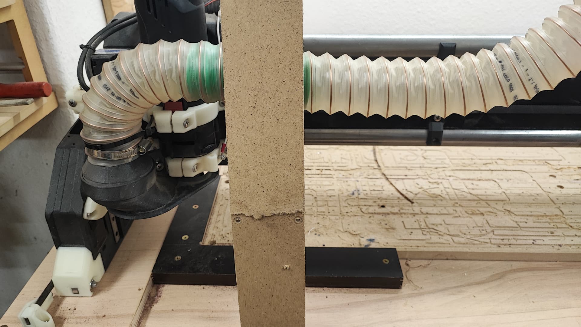

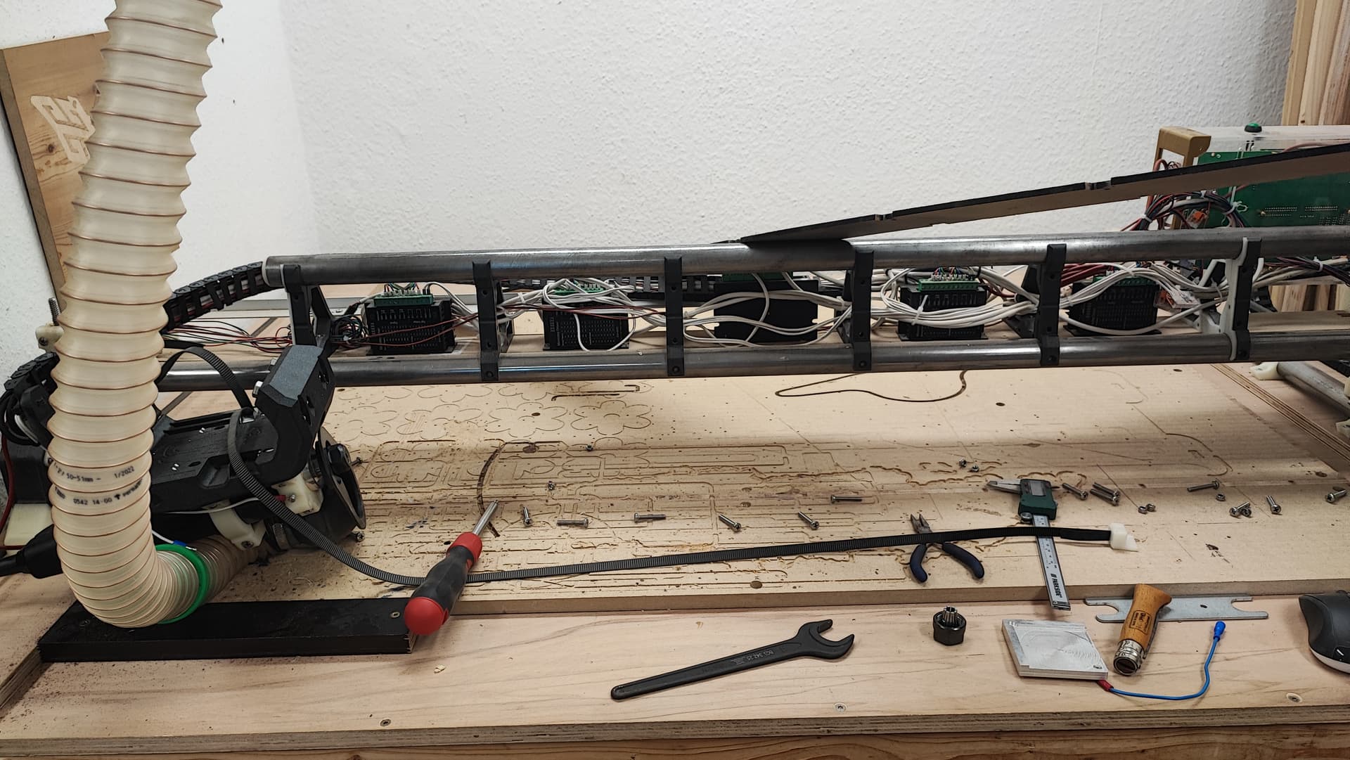

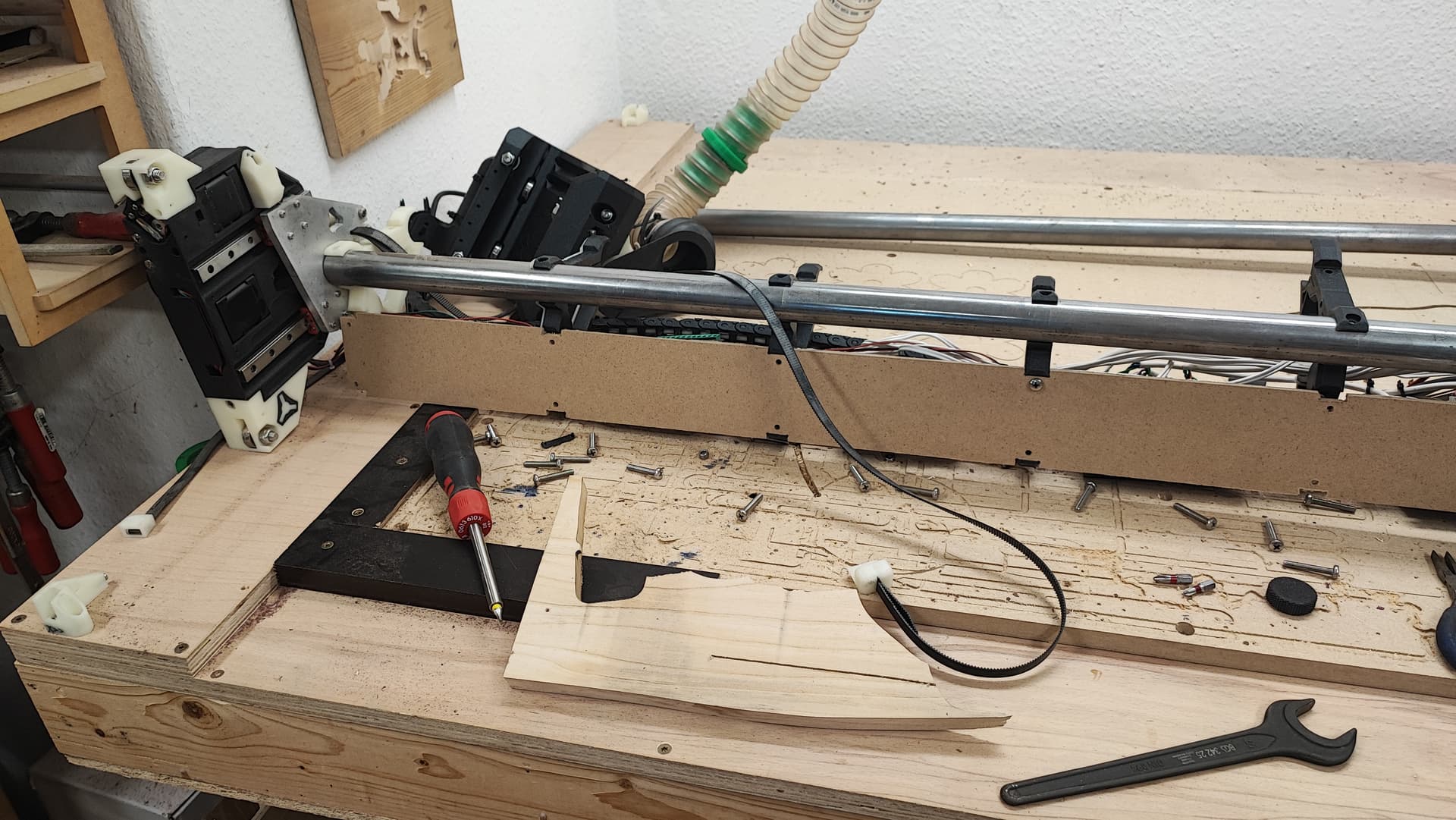

Okay, what really happend (is the above), but I wanted to fix my endstop on X-triggering issue by replacing it and checking the cables while doing so. I always had a creaking noise when going up and down that was connected to the struts being painted and swelling a little, so they were rubbing which made an annoying sound.
So I parked the CNC at the top, like I always tell you to do to get the core off, and removed the front strut plate to file the swelling away, I also took the core off.
What I did not consider was that if you pull back the top rail and there is no support from the front strut and all the screws have been taken out (because you remove the strut), the bottom rail whill just fall down. The gantry is heavy. And what happens when the rail supporting the gantry falls out? 5mm HDF holds the whole gantry for about 20 seconds. After that it breaks…
I panicked a bit… I don’t want to cut strut plates… Argh. But as I am a lazy bum and hadn’t exchanged the bottom strut plate from the beta that didn’t have the wings but had already cut the new one (like, a year ago), I was finally forced to replace it as well.

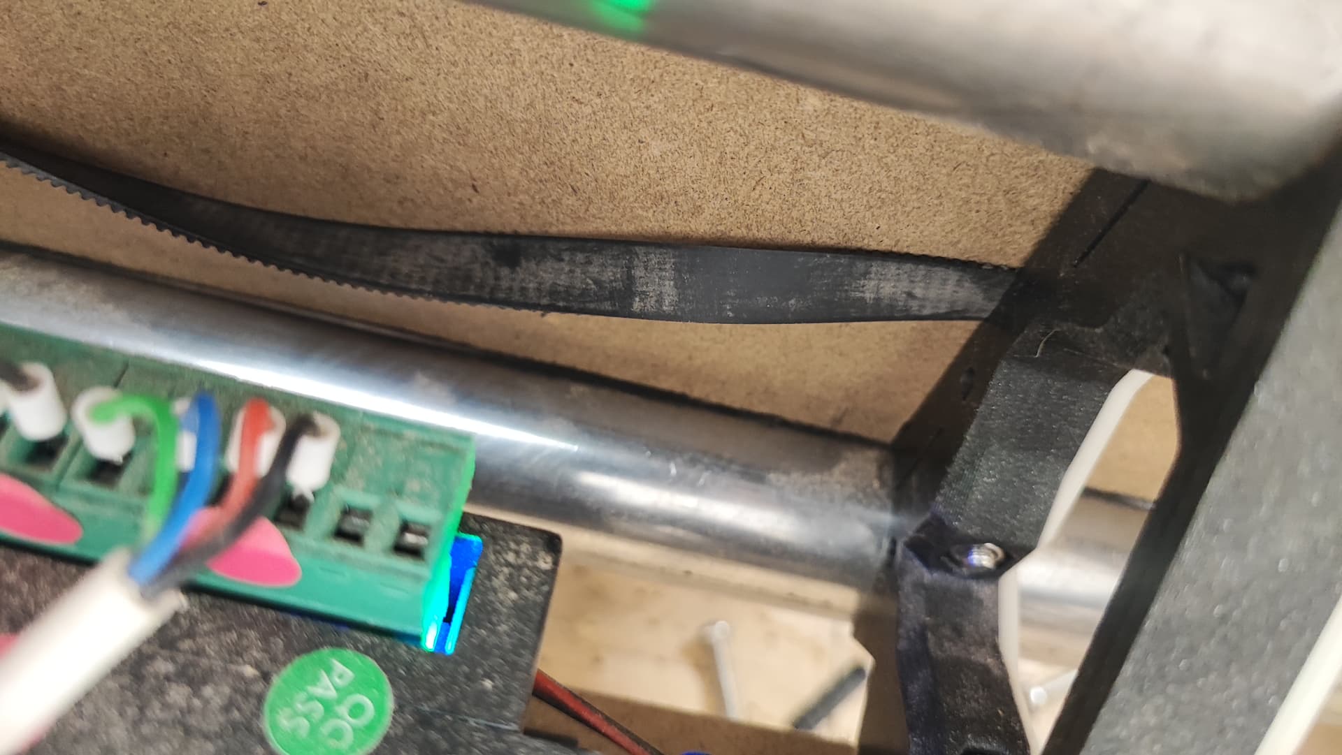

I made sure to secure the bottom rail this time by installing the front strut plate again and fastening the bottom screws. When everything was done I wanted to clip the X belt in again. Well well well, if it isn’t the consequences of my own actions… I didn’t watch out and screwed the belt down behind the front strut…
Very wow. Much professional… Was a quick fix, but man, sometimes I am an idiot…
Long story short: The creaking is basically gone and it was also more of an annoyance than an actual problem. The winged plates are now installed and the endstop was changed (will see if that was the problem. The new, non-roller endstop also gives me 2mm more workspace. Woop. :stuck_out_tongue:
So the LR is now as good as it can be. I didn’t want to sell it with even minor defects (thoug I haven’t found a buyer yet). :slight_smile:

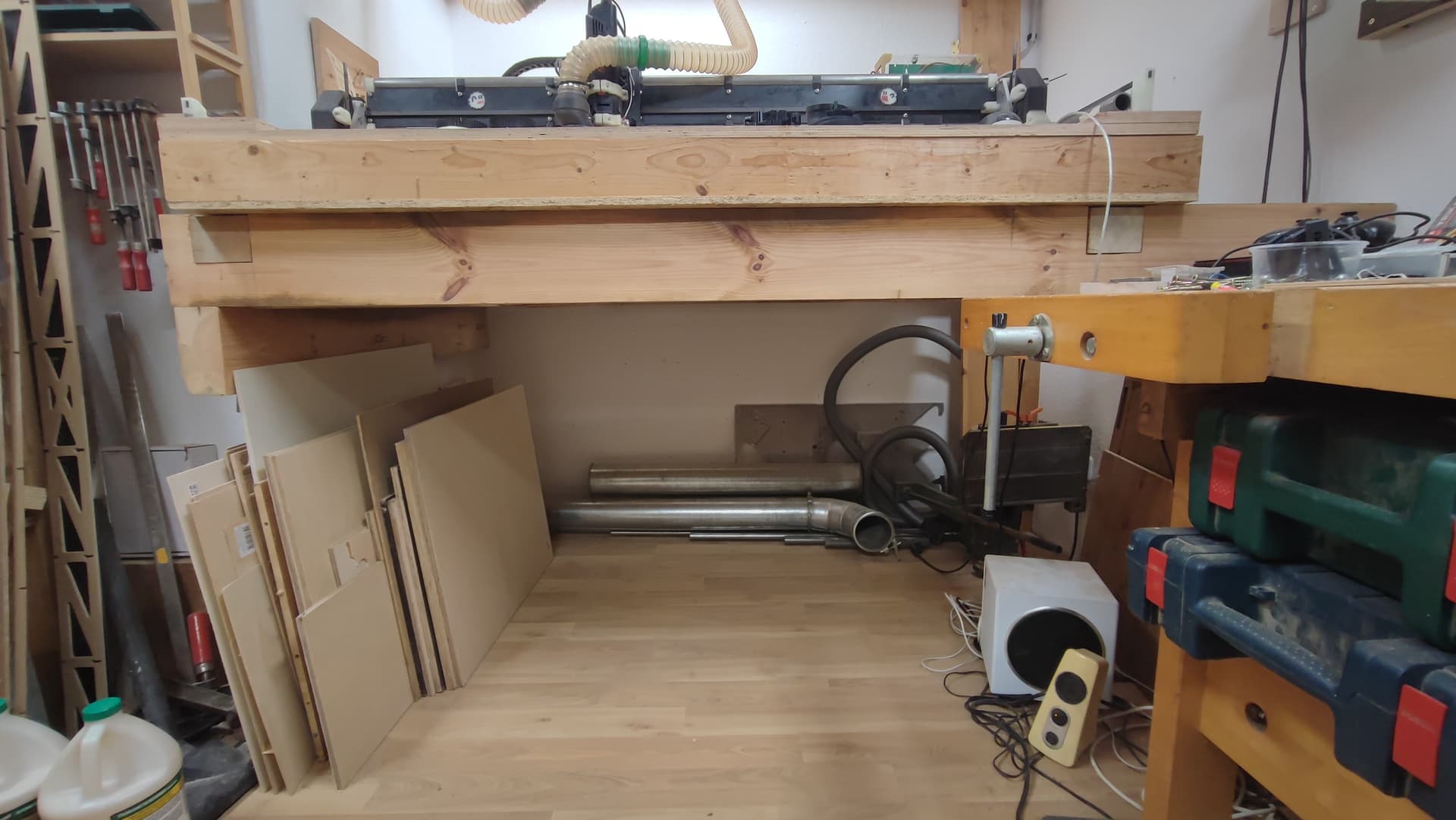

The old table has been dismantled. Look at all that storage below the floating table!!
It’s fixed to the wall with two 1000kg wall anchors on each side. My wall is only red brick, so each one should be able to hold around 500kg, which is still more than enough. I did hop up and down on the floating corner to test the strength, it’s working well. :smiley:
