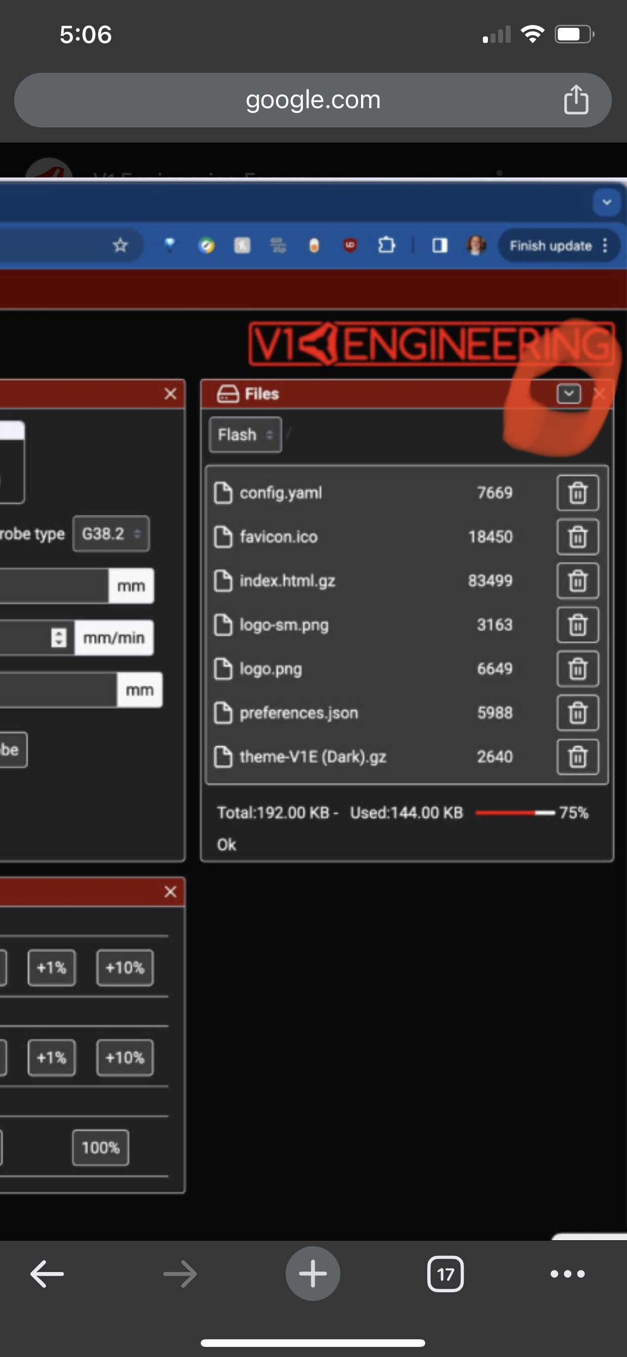

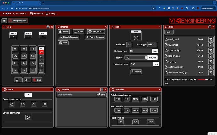

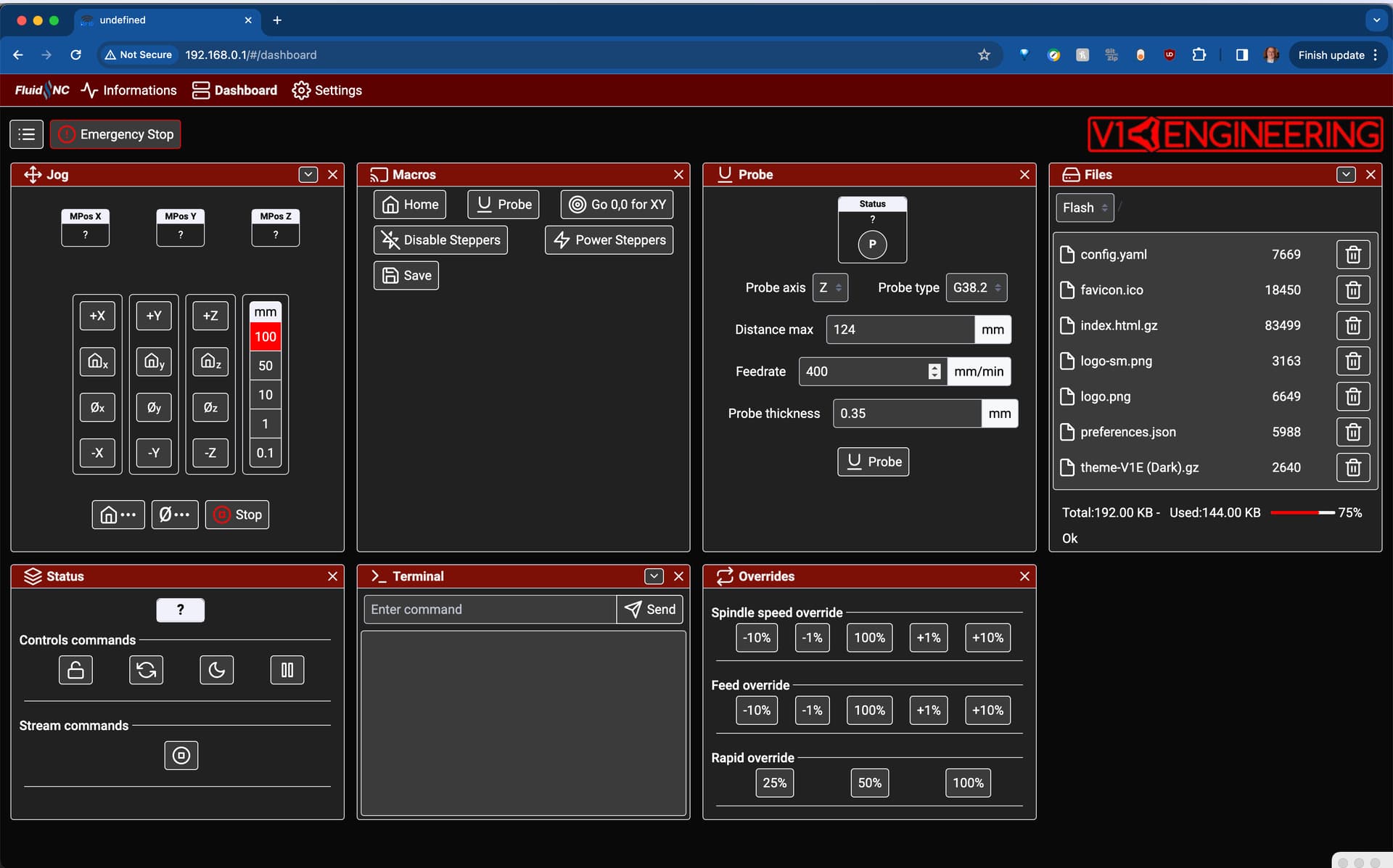

Mine has the V1E theme in use… and looks like this:
…and the little arrow for file uploads is here:
Make sure the dropdown has “Flash” selected and not “SD” when you upload.
Yep.

I got it running. Now how do I get the same background like yours Doug?
That’s my V1 theme for WebUI v3.
