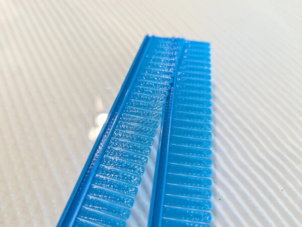

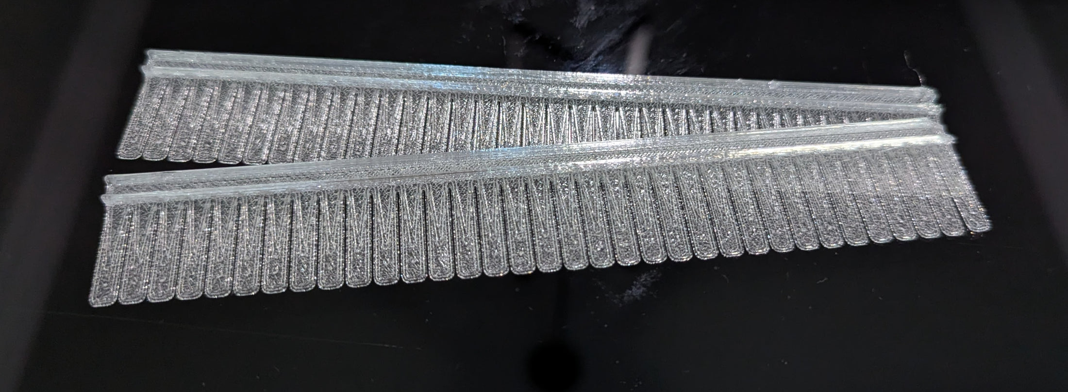

Finally printing some long Bristles to help improve suction when cutting thin polycarbonate. I use 5 walls. But…

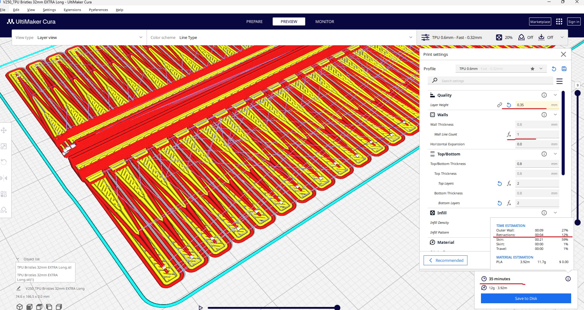

Noticed LR4 Kobalt TPU Bristles instructions on Printables mention “One Wall”. Which for me would print like… (note the print time and % of retractions)

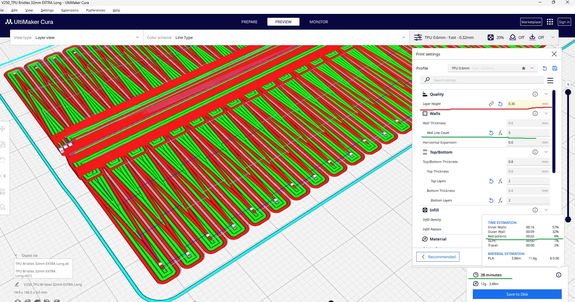

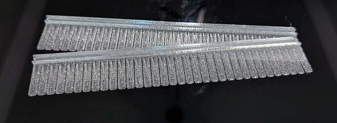

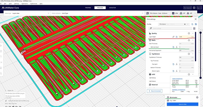

However, during LR4 testing, I vaguely recall we found 5 walls was a nicer finish, faster and less retractions (a nice goal when printing TPU that clogs more easily) ?

Noticed pics for TPU Bristles available at V1E Shop have 1 - 2walls…
I usually print with 2, work pretty well if one’s not too stupid to correctly install the nozzle… :grinning_face_with_smiling_eyes:
I printed with added perimeter wall count after studying the slice results and liked it.
