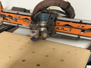

Build log entry #2: Postmortem on LR3
I spent 4 hours yesterday tearing my LR3 down piece by piece and inspecting each component.
Positives
  • Wiring held up well. Everything seems intact. I used some very small wire for Y - endstops (don’t remember why) so that will be changed for something slightly more robust.
  • Kinetic mount and Router Mount held up well and were still very tight. Tape used to shim/tram the router was still in place.
  • Undermounted LEDs were in very good shape.
Problems Identified
  • Core cracked / delaminated in the area of the top bearing mount on X min side.
  • X min brace was cracked and the top EMT was loose.
  • Idlers for the Y belts are caked in a grease/sawdust compacted goop. Cleaned these with Simple Green and it did come off eventually. They still seem to turn freely.
  • The two rails on the YZ min plate were bound up severely. No smooth movement at all. The “front” of the two barely moves at all. It feels like sawdust caught up in the bearings, so improved dust collection is absolutely necessary. I’ll clean the rails today to see what I find. I purchased new rails for the LR4 due to length.
  • The YZ min lead screw connector is “sprung” from working against the resistance. There was tension and an audible noise when I released the grub screws on the min side. The screw is also caked with the grease/sawdust material. Here’s a picture of my min and max connectors once they were removed:
IMG_0142 Small
This explains a lot of strange behavior I had seen as I tried to finish the gift projects. Very inconsistent Z-height was the most common problem. Unfortunately it caused very inconsistent inlay plugs, and required quite a bit of rehab work on the final pieces. (Still wasn’t happy with them.)
Based on these findings, my action list for the LR4:
  • Improved Dust Collection.
  • Replace Z-connectors, YZ rails
  • Increase size of Z endstop wires
  • Maintenance schedule - I need to inspect, clean and lubricate the rails, screws and other motion components on a regular schedule.
I also think I could do some of the work out in the middle of the table. I think the sawdust problem comes from only being 30" wide and “planing” the tops of wood workpieces. The larger bits I use for that task generate larger wood chips at a much greater volume than other operations. For rigidity/stability I had tried to keep it close to the min side. But I think moving the work more to the center would probably decrease the sawdust piling up on the rails and motion system.
