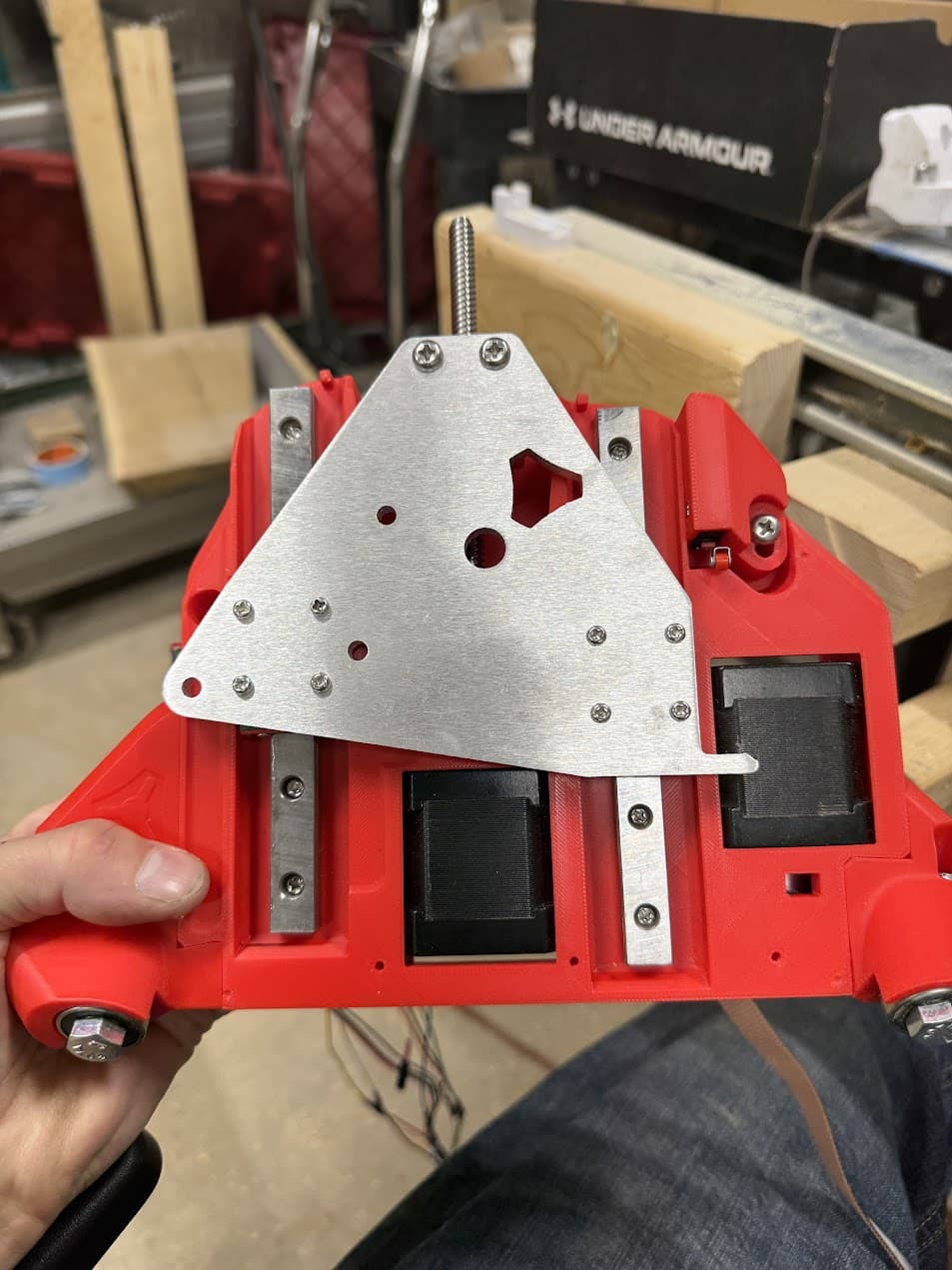

Next this time I decided to go with the upgrade kit as DIY could have been some of my problems, the 3D printed XZ plates on the LR3 were a bit weak for speed

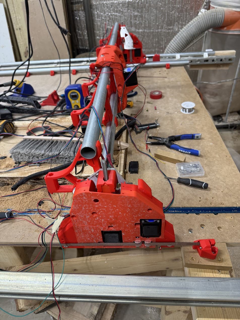

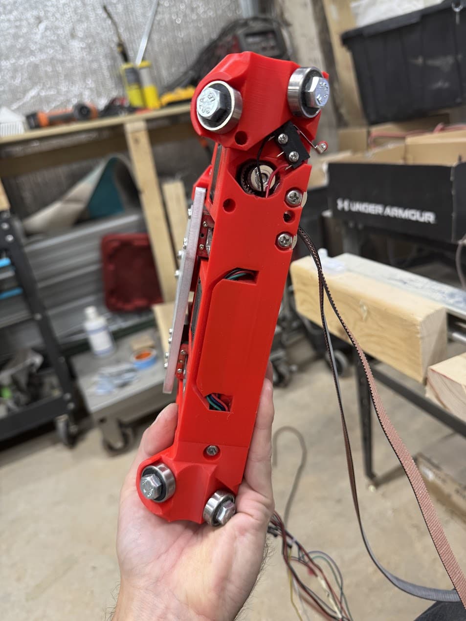

Also this will come to a shock to you in the later pictures, but HOLY I love the wire routing that Ryan put in here, it’s absolutely mint! I’m not going to gripe, but it was very similar to working on a car trying to route things through here, but if you keep at it, it’s flawless!

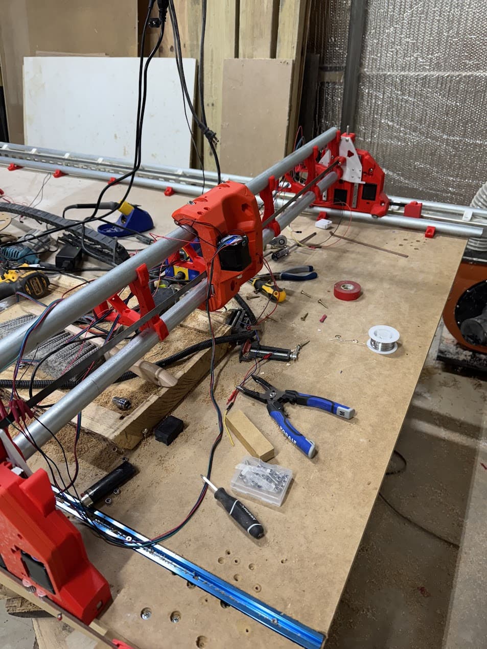

Now where it gets tricky… I did this pre-documentation and like I said I only have built a single CNC, and that is the only CNC machine I have ever seen in real life, I have technology and construction background but never machining or anything like it.
I got it here and had to beg borrow and steal my way through by trying one thing after another to get it all on, but with the help of the forum it’s there!
Remember when I said I love the wire routing, well cable management is not my strong suit, but I can recognize good LOL, I will be playing with cable management for the next couple weeks, trying to get it right but as you can see above it’s starting to come along! Also don’t work like me kids, keep a clean workspace it was and always is a train wreck finding stuff.

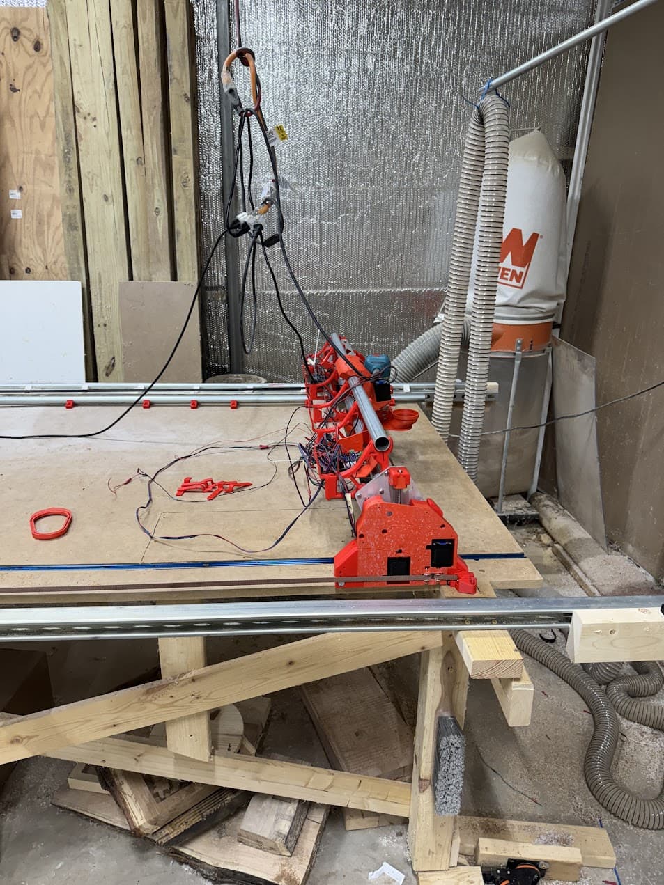

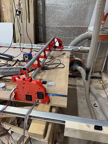

She runs though, still figuring out the end stops on the Jackpot, but the interface and response times on jackpot are so much better! Also I can crank up the speed right from the interface, and that’s what I need is more speed haha!

How do you like the Wen dust collection? I need get one myself, but always thought I would get the one from Harbor Freight.

Nice build. I loved converting my LR3 to the 4, and I had the exact same reaction when I saw the wire management tunnels. Seeing the assembled machine with barely any wires visible really pushed me to make my wire management as pristine as I could. I even wrapped the Makita cord all the way to the outlet, lol.
