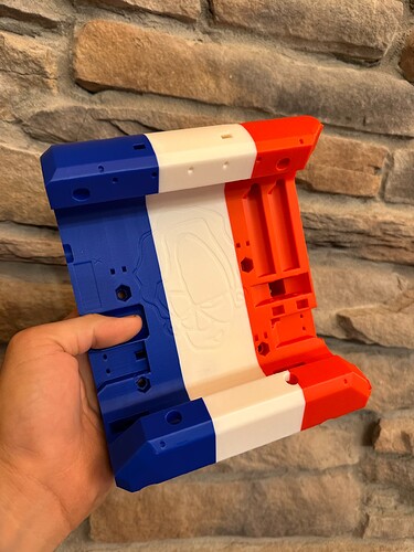

All the cool kids are doing it so I’m going to build a LR4 too! :grin:
Couldn’t decide on my color scheme and then it hit me. Red. White. And Blue. How much better could it be!
Im known by my family/friends for loving my country dearly so this is only logical! I mean look at that core! (Hopefully it doesn’t split at the color lines. :upside_down_face:)
Printing = :white_check_mark:

Should have taken the French attack flag: White stripes on white ground. :stuck_out_tongue:
Kidding aside, that think looks great! :slight_smile:
Oh, I am just now reading the title. It’s supposed to be USA, not the French… :smiley: Whoops. :stuck_out_tongue:
And your daughter’s message is the cutest thing in the world. :two_hearts:
Hahahaha I was warned it might get mistaken but that’s ok! lol
