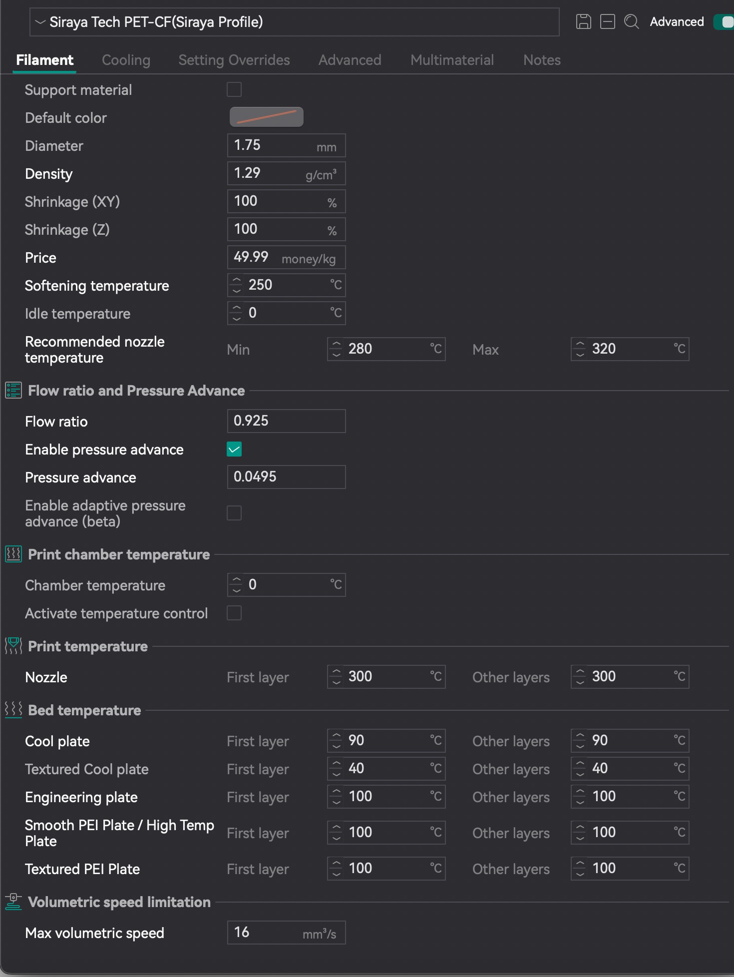

Making progress on my build, have the core and the XY plates made, and tubes ready to be cut in the garage. I struggled trying to get PET-CF printing well, but Siraya support has actually been quite good. I spent a few days and many prints getting my own profile close, and Siraya just sent me their version which I hope to try later this week. I also found someone local that had a bunch of stainless 32mm tubes, so am going to be using that for the build for hopefully a nice rigid build. Planning on a 49x60" build which is as big as I can fit in my space in my old garage. :slight_smile:

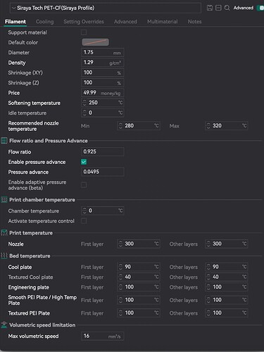

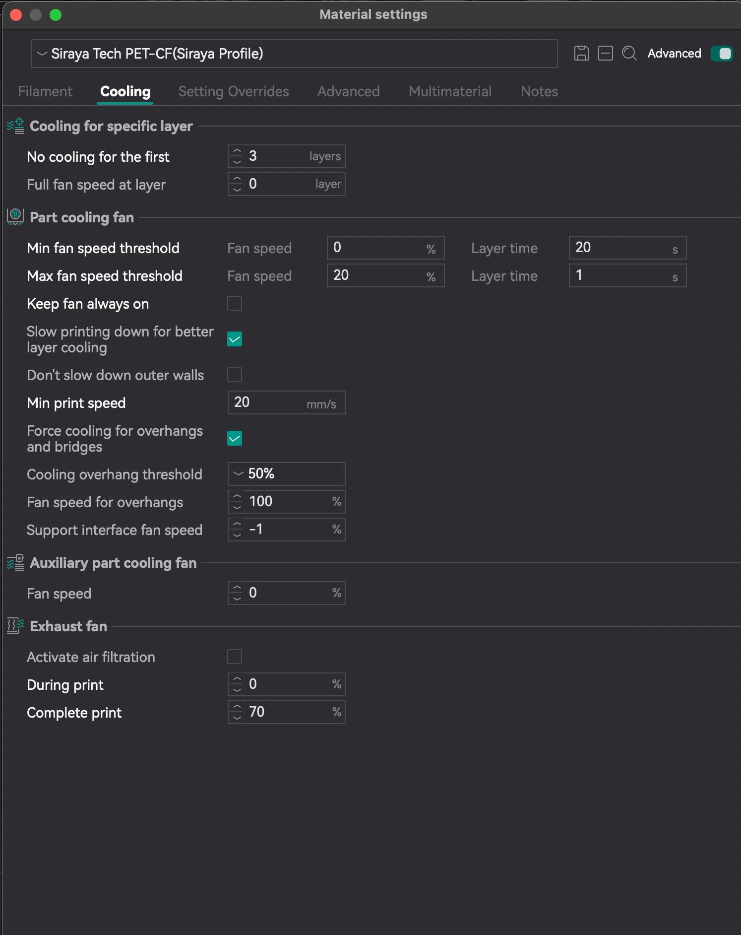

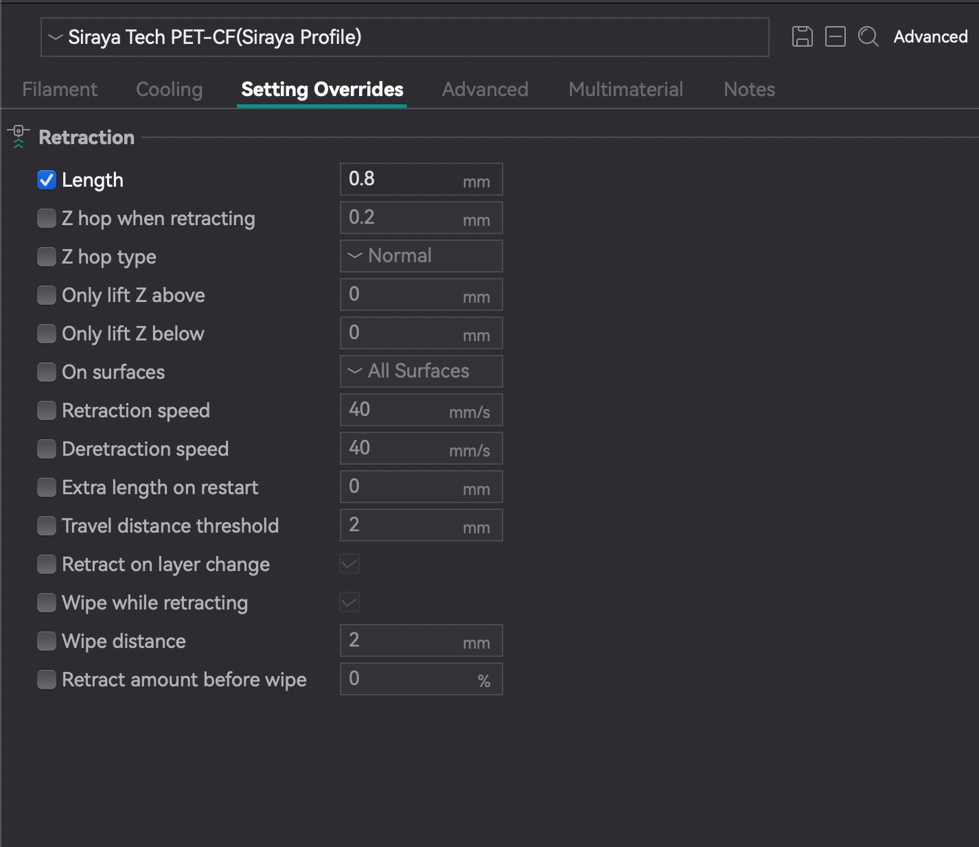

I also wanted to add that Siraya tech support has been great. We have been working on getting a Creality K1 .6mm profile ready for them to share on their site. If anyone has a K1 and wants what I used, I am happy to share in the interim. It is not perfect, I think the pressure advance could use some tuning as there are a few blobs, but it prints quite fast and has great overall quality! The minor blobs come off with a little cleanup. this was printing at 100-160mm/sec and pretty much at the max volumetric rate my extruder can do.

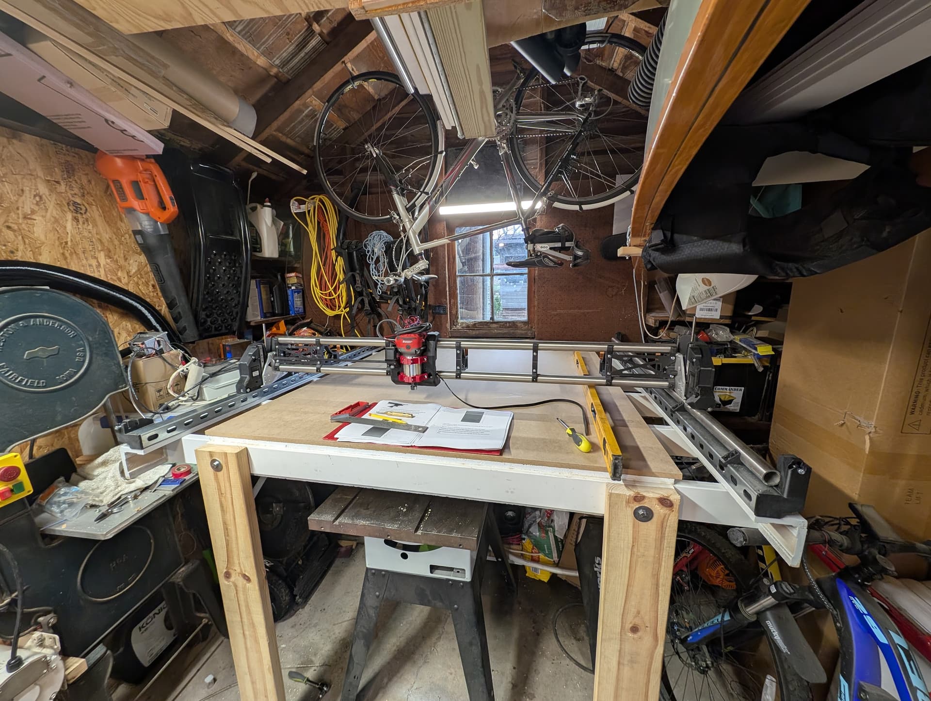

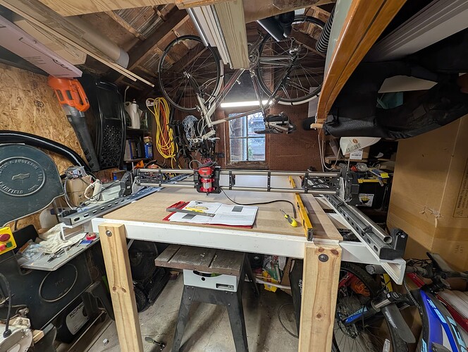

Life got busy for awhile, but now have the rails cut to size, parts for the table and also built my pendant.
One thing I did notice, my build is going to be 49" wide, so a pretty wide, but not unusually large span. The rails, I am using are stainless 32.5mm (found some used locally for less than conduit. :slight_smile: ). I did notice that when putting them next to each other, they are not perfectly flat, one of them has a very slight bend, about 1mm out of flat over the 49" (yea, mixing metric and us units). My guess is that when they are in the braces, they will be perfect, but is it work trying to induce the bend out of the rail? Worried I could make worse, but I also think these are probably more straight that what I would find in conduit at home depot…
You can try for sure. I had stainless steel for the MPCNC and the LR3 and since those are welded I had differences of 0.2 or 0.3mm ish where my bearings would not touch the rails. When I clamped the core down, they would not go over the braces smoothly. So all in all it really annoyed me. For the LR4 I bought DOM, treated it with Silbergleit and am happy.
Regarding a bend: I don’t know whether that will work but it just might, since the end braces can not really move anywhere. This might eliminate that problem. :slight_smile:
Well, test fit everything together and it all fits perfect, no manual bending needed. As soon as I installed the braces, the very small curve seems to be taken out, and the core moves without any slack or extra friction across the entire length, so I think I am good! whatever rails I have are very uniform over the entire length, so no issues with the bearings loosing contact!
ignore the carpenters square, that is just keeping it from sliding down. :slight_smile:

You have two endstop switches on your core. You only need the one. The second spot is for the very rare case that someone needs to home to the opposite direction.
Microcenter - Inland Copper Silk PLA.
Thanks for the catch!
really now that its there, you could just leave it and not have any issues other than a switch that never gets used and MAYBE trying to hook up the wrong one for the config. But there is no harm in having it there.
yea, I am not removing it for now, but will make sure I only connect the needed one when I wire up the controller…
just a heads up, there are spots on the wheels for additional Y endstops. Your pictures look like you skipped those, so you might be good to go.

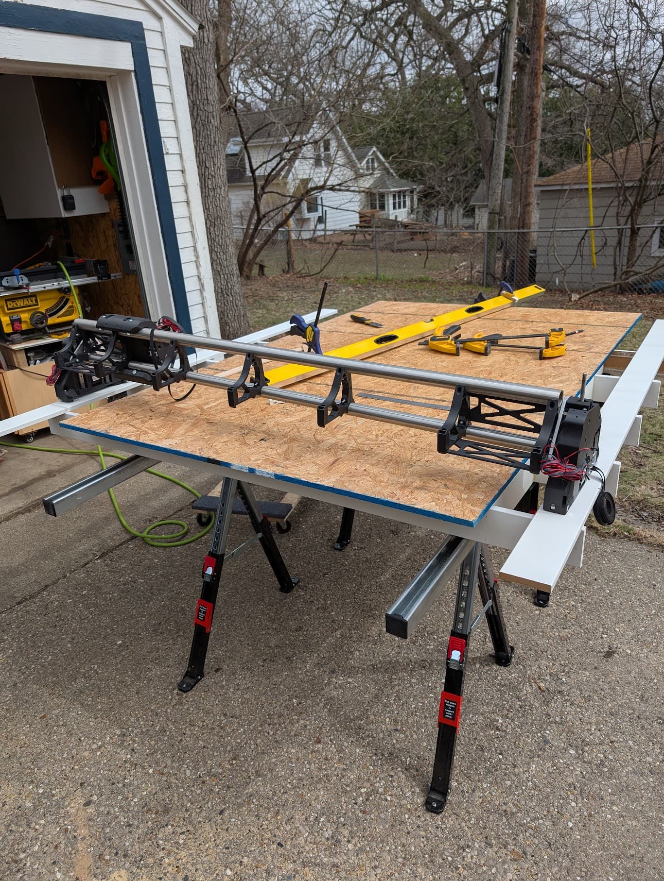

Made some progress on the table today!
Any updates on the 0.6mm K1 profile?
Which slicer were you using? The latest Orcaslicer includes 0.4, 0.6, and 0.8mm profiles for K1. I’m going to try them out tomorrow.
Yea, thes settings are working pretty well!

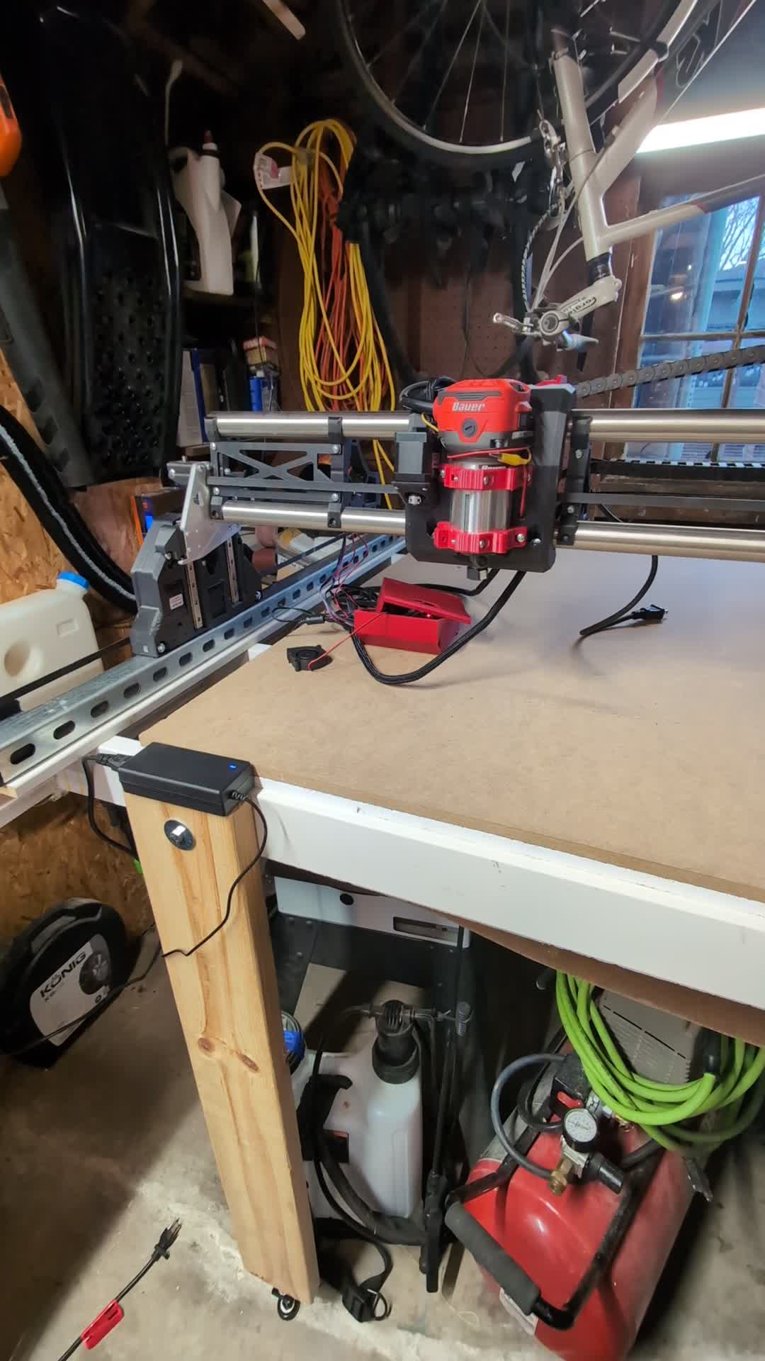

bit by bit, she is coming along! Now in her new home in my extremly small shop/garage…
Progress! Still need to clean up wiring to the control box, but it is alive!

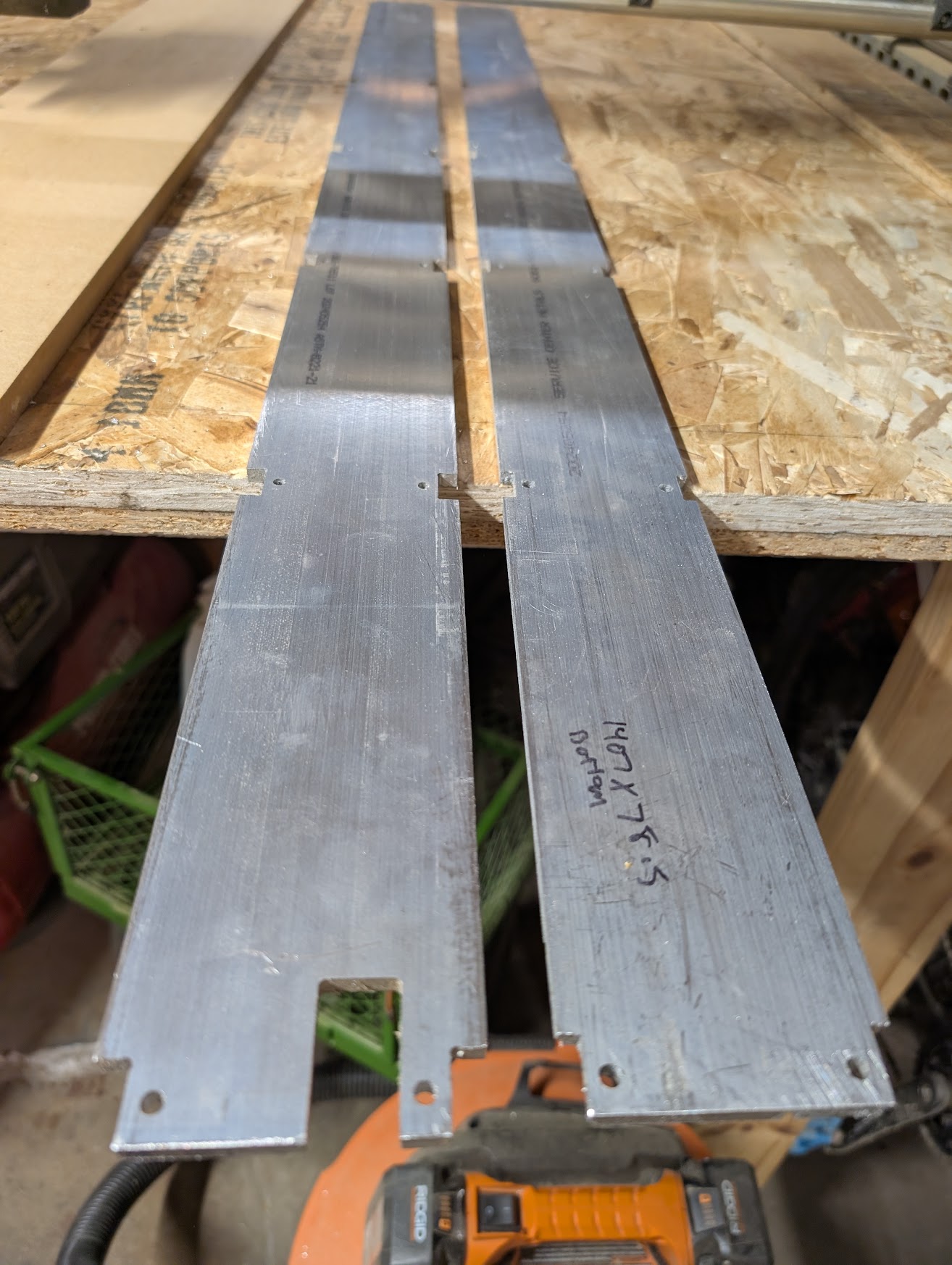

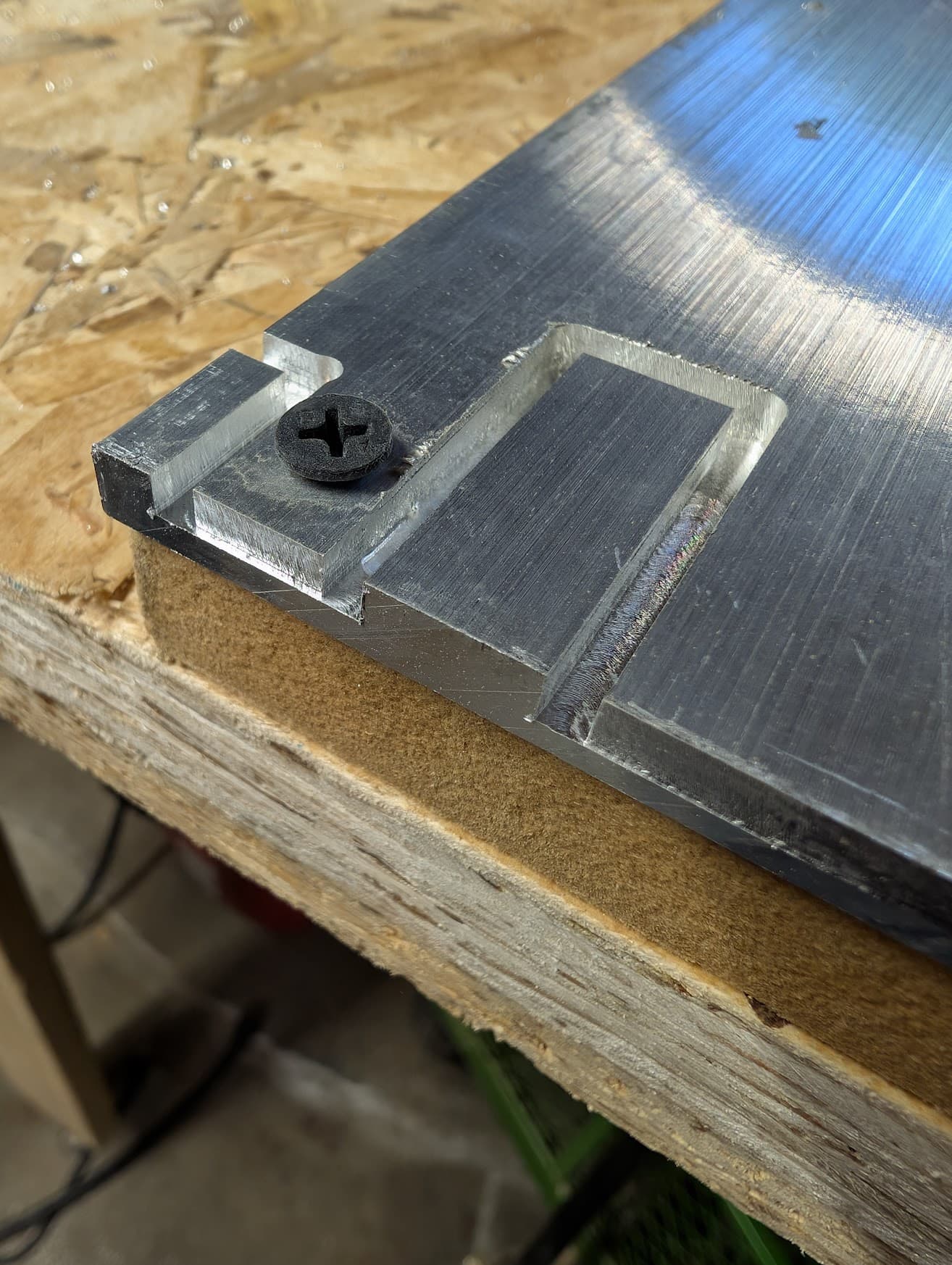

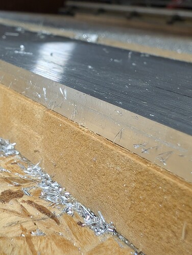

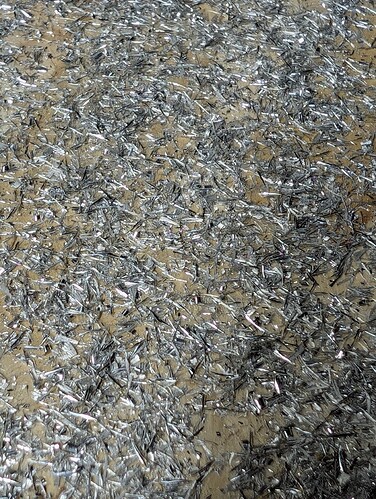

Well, life got busy for a bit, but I finally got the aluminum strut plates made. I was using SPE 1.8 single flute bits, but for the life of my could not get Trochoidal working, kept breaking bits, but finally went back to the conventional milling using the chip load from SPE and got them made. Still broke a few in the process and one or two missed steps (both X and Y) which caused some small havoc. Guess I need to check what the steppers are running at? I am pretty sure I have not touched those settings, what are people running to prevent that?
Now I just need to install, install a a full size spoilboard, surface and I should be up and running!
Those should make for a seriously stout X axis gantry. Weird you had to go back to conventional milling. Which rotation direction does your spindle use?
