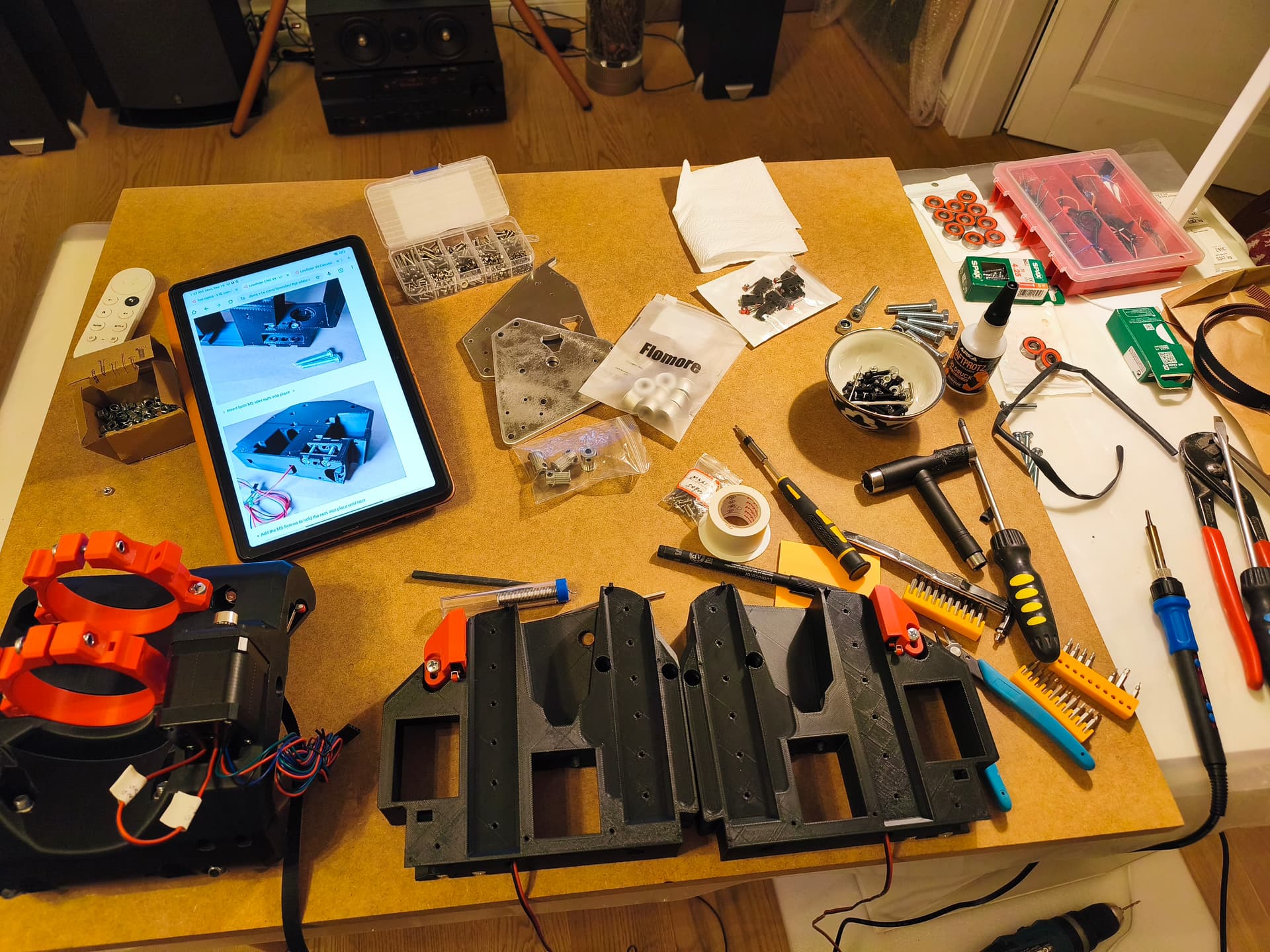

LR4 build in Vienna
Thanks for all details into the build-page i was able to order all parts easily
Thanks for all details into the build-page i was able to order all parts easily on amazon-de

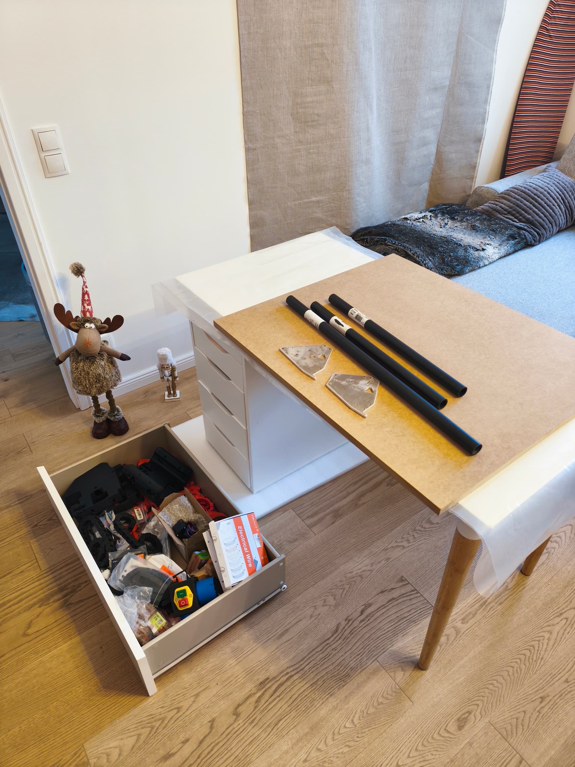

the black rails i bought 27.5 mm from hardware shop OBI.at in Vienna. I had to print small ring-adapters 27.5-29.5mm

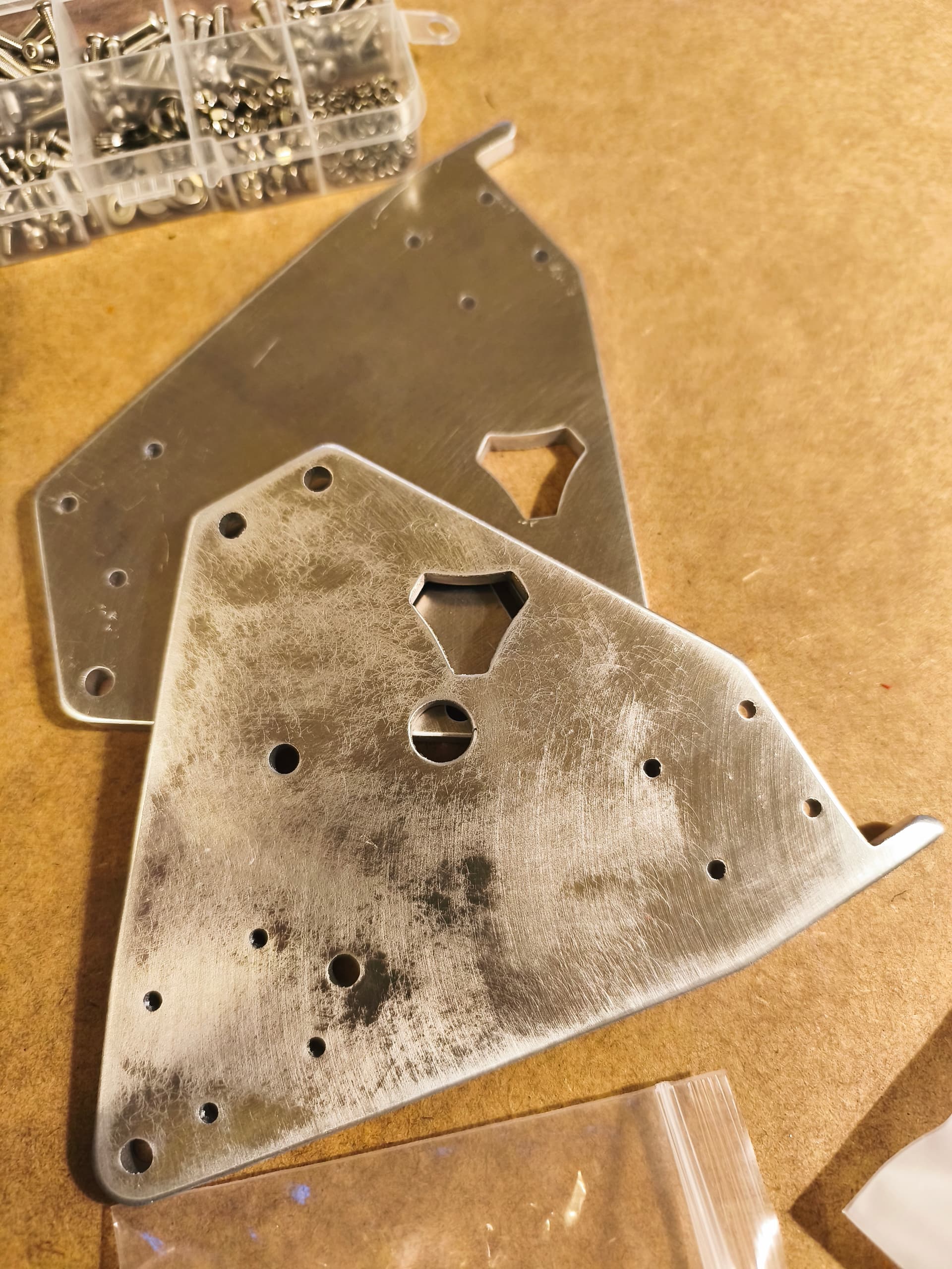

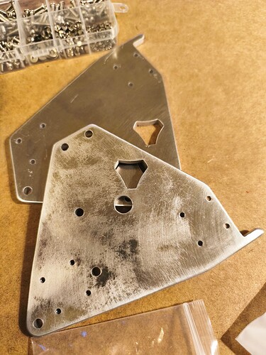

  • ordered the metal plates directly from philipp @ hawiwe-de. Philipp was very fast to make them ready, was shipped to me from Germany in 2 days! overall cost 38 euro + 7 euro delivery.
  • ordered board from elecrow-com. cost 45 euro + 6.94 euro delivery. I have decided to take cheapest delivery (from China to Vienna). i was expecting to deal myself with customs. By surprise there was no need - the package just arrived to my home in exactly 11 days from the order was placed

thanks to Philipp, first delivery was lost but he cutted me the second set just at cost of delivery costs. i can only advice his work for alu parts. nice cuts

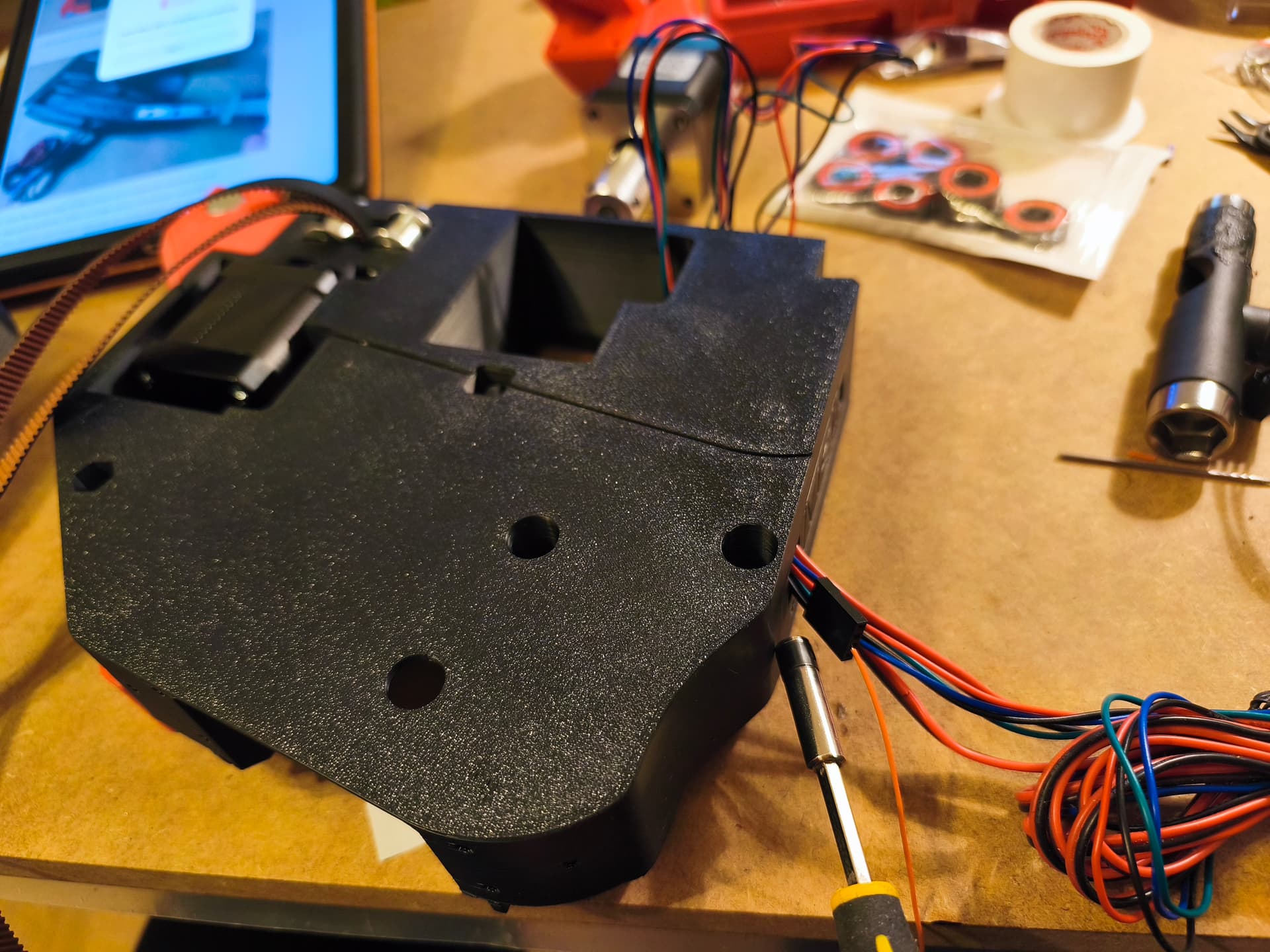

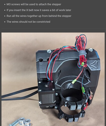

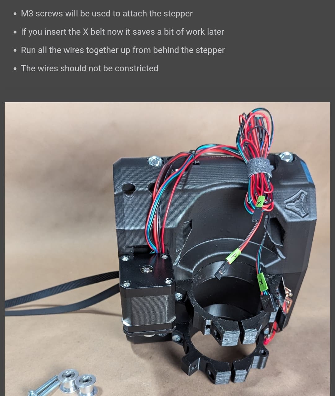

suggestion on Z drive mount.
the hole is too small to push additional Z cable into tiny slot where Y0 cables already in.
solutions:
-i had to solder small cable to stepper header to pull it through
-please consider to improve 3d model
You can get them though without soldering that. Sometimes it takes patience, wiggling the wires just right and holding your mouth in the exact right spot. But I promise its very doable. For me its easier to put the Z wires in first, then the Y motor wire, then both endstop wires.

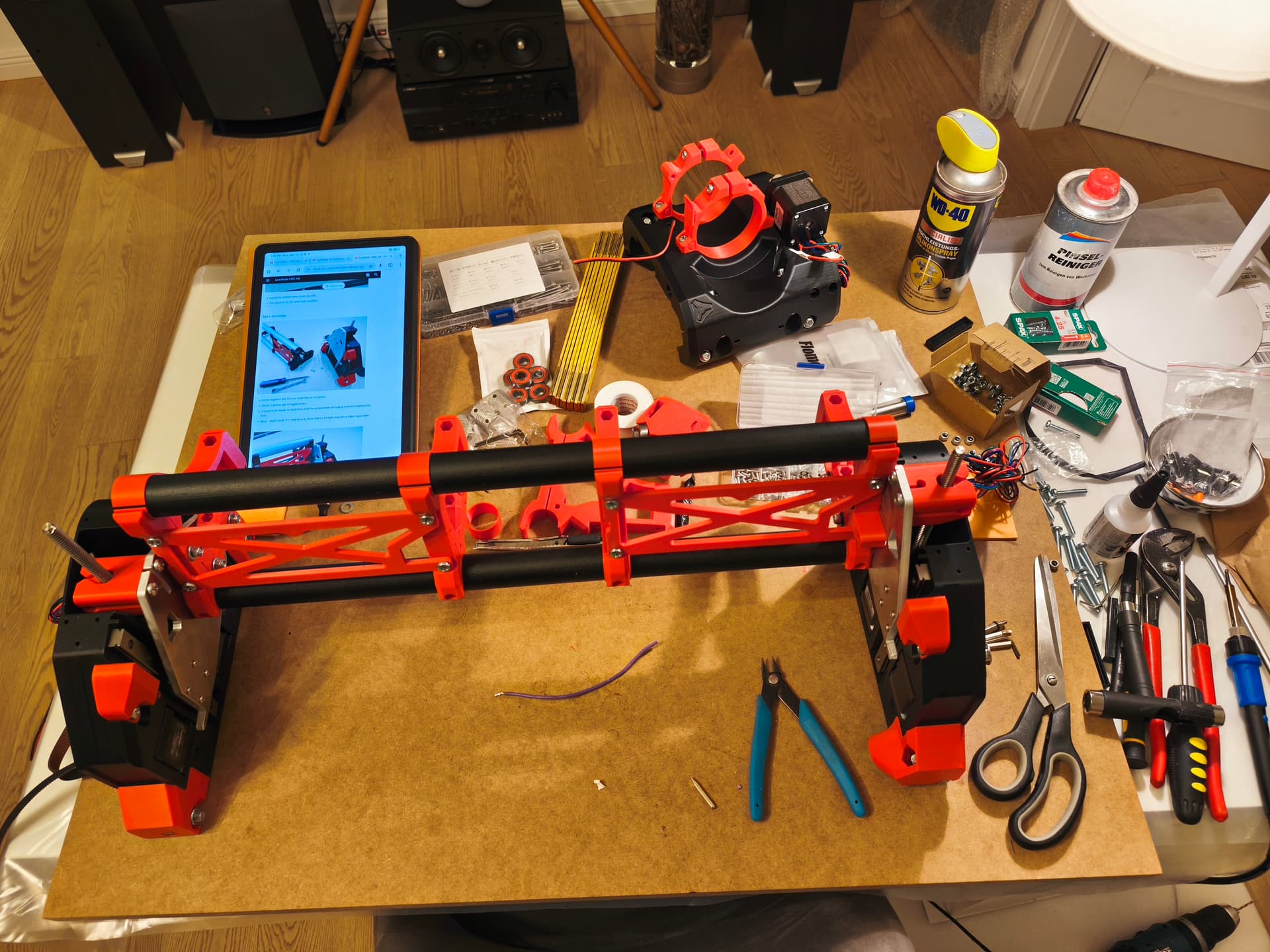

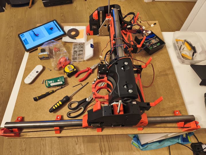

building the Y axis… easy work with the online doc (no need for phD :slight_smile: )

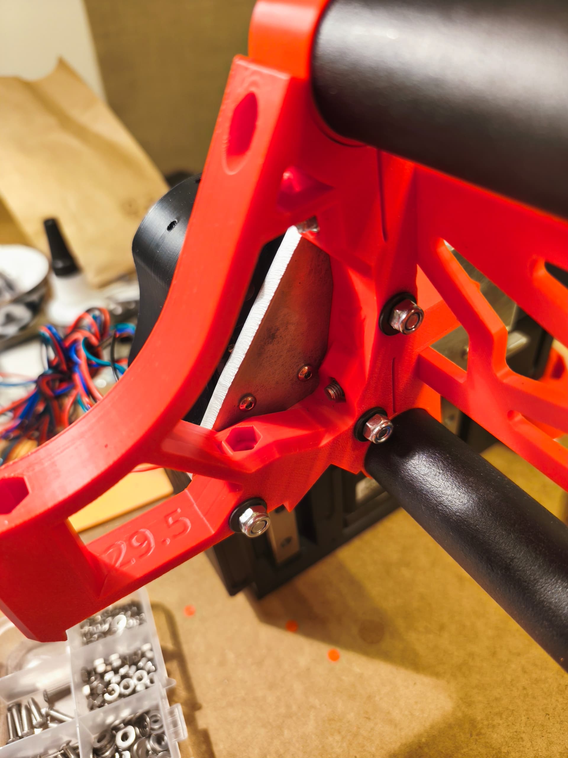

p.s. (last picture) most extreme rail holders could be adapted for nut slots… strange those are not done and i have to hold it
This was talked about a lot in the beta and it would cause the shipping of printed parts kits to get a lot more expensive to add that and make the braces wider. As it is now it takes every bit of available space in a box for Ryan to ship them. Its not that big of a deal to hold 6 nuts and tighten them :smiley:
Especially if you did the LR3 and had to hold 80 nuts or so… :sweat_smile:
That’s for sure!

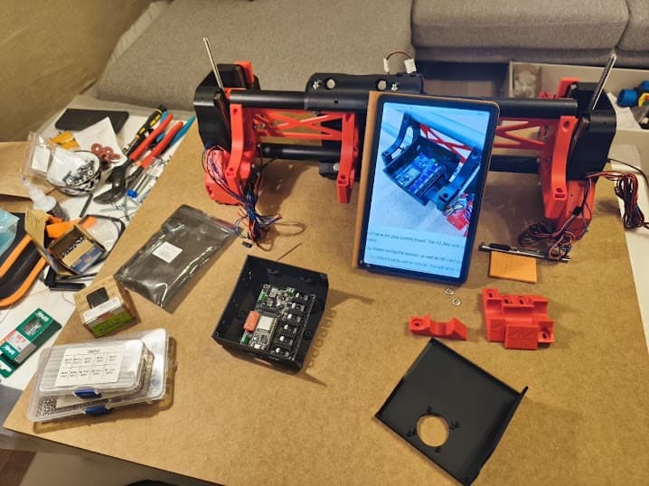

Finally completed the mechanical build. Took a while to get proper 30mm rods.
Now facing major obstacle to find out why at the core there is only 1 end-switch for X, but on software page there are two connectors X0 and X1 required.
In fact, in core part there is place for second end-switch but no instructions whatsoever about it.
Where should I connect the first switch? To X0 or X1 outlet on the board? (I bought jackboard v1 from escrow)
The x minimum is where you put it. And you only need one for x. The x max side is a limited use case for an advanced configuration most will not need, so ignore it.

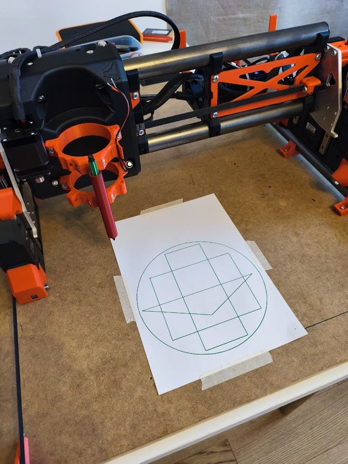

here I am and finally managed to make Homing sequence and make a first drawing.

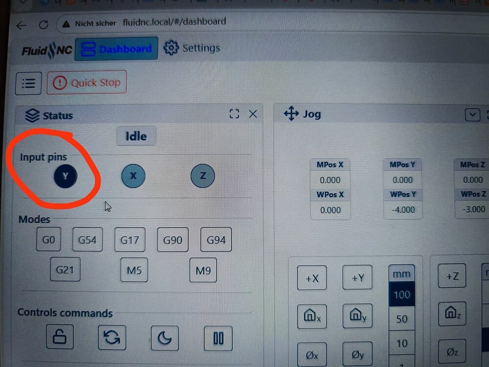

  1. BEFORE you try to move axis motors, important to verify that all end-switches are working fine
    open FluidNC and see the main page.
    put into terminal command line
    $MD
    (it disables all motors)
    $ME
    (it enables all motors back)
    toggle manually each end-sensor (single X, two Y, two Z)
    each time you touch end-switch the Status display must change color of the respective X,Y,Z signs (see picture)
    carefull: dark color means one of end-switched is toggled.
    Notes: that helps to verify that all 5 end-switches works correctly and Home-sequence will working
