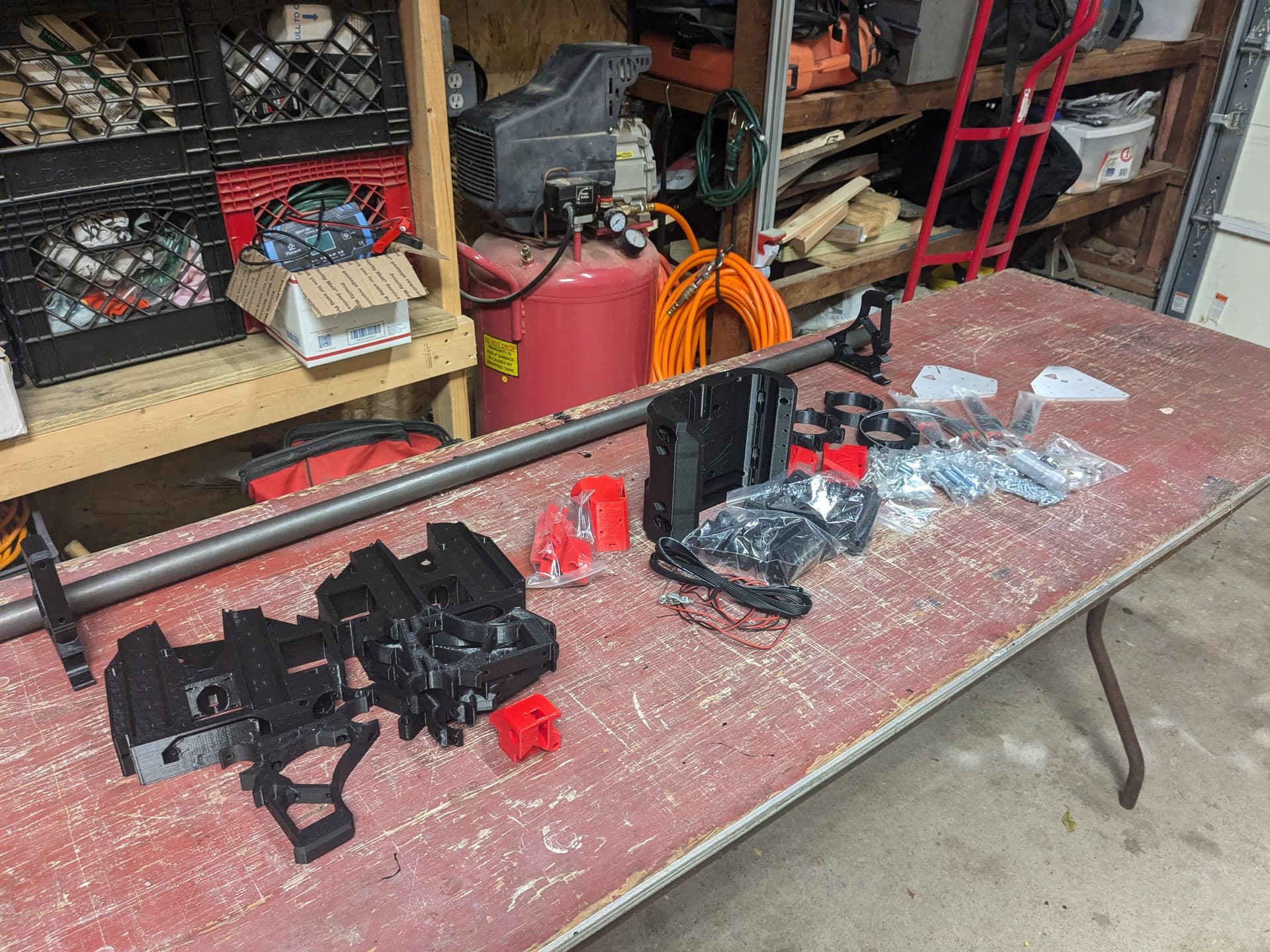

Hello everyone welcome to my build thread.
Just started my build last night so far so good.

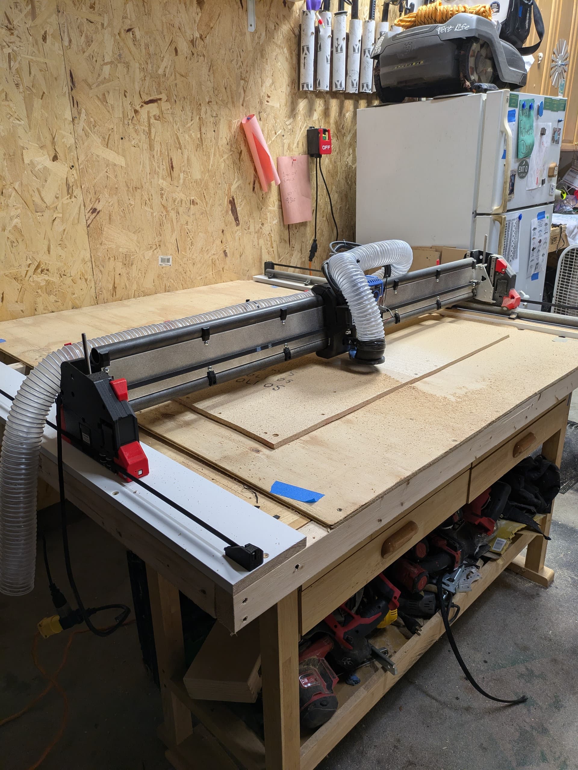

Finally got it running!
Think it took me 10 hours or so in 1 hours increments.
Currently surfacing a piece of junk MDF spoil board with a 1" shell mill and I’m really impressed with the finish. Don’t even need to tram it. Z makes a funny sound and but I think it’ll go away on its own.
Did you put super lube on the lead screws?
Guess I needed more :+1:
that was gonna be my exact reply… been there and done that last night LOL
It happens a LOT. I went back and forth on adding it to my prebuilds before I ship them. And because of how many of these type post I see, I go ahead and lube them good before they leave here just so I know its good. And they get the little tube that comes in the kit so they can lube it more as it needs it.
I couldn’t find my little tube that came with the parts so I hit with a shot of Teflon spray ever so lightly near top where it made the noise
